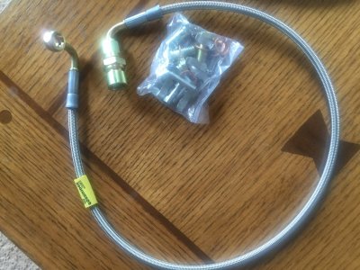

OK guys thanks for helping me spend more money on my truck dammit. I just ordered the AC Delco calipers 18FR2246 & 2247, Power Stop AR8654XPR rotors, and EBC DP71830 pads which I have now and am very happy with. I went with Goodridge 14175 braided brake lines after reading reviews. They're a bit more expensive ($130) than the others but after reading reviews, decided they're worth it. They are exact replicas of OEM as far as lengths and how/where they mount- they have the same clips included that the new rubber ones would have had. So it looks like my brakes are about to improve. IMG_5255.JPG

Just front lines or front and rear?
Do you have active brakes? (JL4 code IIRC) this requires an additional line for the rear.
52,954
Front and rear lines. I don't have active so it's a 5 line kit since there's one in the center of the rear differential.
