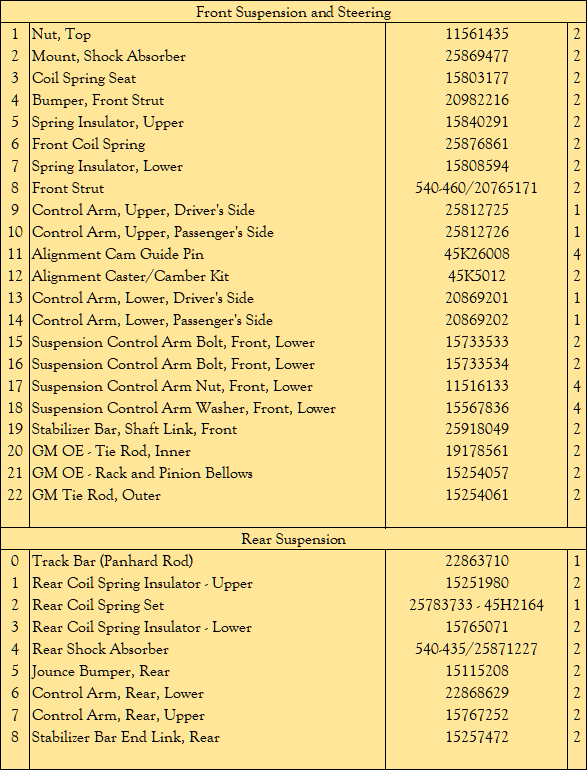

Here's a parts list and the torque values and socket sizes are on my build page, "Useless Information". The list also includes the other suspension and steering parts and all are GM OE save for the rear coil spring ACDelco Professional number, the originals I could not locate anymore when I was looking for mine.
Front Suspension and Steering
1Nut, Top115614352
2Mount, Shock Absorber258694772
3Coil Spring Seat158031772
4Bumper, Front Strut209822162
5Spring Insulator, Upper158402912
6Front Coil Spring258768612
7Spring Insulator, Lower158085942
8Front Strut540-460/207651712
9Control Arm, Upper, Driver's Side258127251
10Control Arm, Upper, Passenger's Side258127261
11Alignment Cam Guide Pin45K260084
12Alignment Caster/Camber Kit45K50122
13Control Arm, Lower, Driver's Side208692011
14Control Arm, Lower, Passenger's Side208692021
15Suspension Control Arm Bolt, Front, Lower157335332
16Suspension Control Arm Bolt, Front, Lower157335342
17Suspension Control Arm Nut, Front, Lower115161334
18Suspension Control Arm Washer, Front, Lower155678364
19Stabilizer Bar, Shaft Link, Front259180492
20GM OE - Tie Rod, Inner191785612
21GM OE - Rack and Pinion Bellows152540572
22GM Tie Rod, Outer152540612
Rear Suspension
0Track Bar (Panhard Rod)228637101
1Rear Coil Spring Insulator - Upper152519802
2Rear Coil Spring Set25783733 - 45H21641
3Rear Coil Spring Insulator - Lower157650712
4Rear Shock Absorber540-435/258712272
5Jounce Bumper, Rear151152082
6Control Arm, Rear, Lower228686292
7Control Arm, Rear, Upper157672522
8Stabilizer Bar End Link, Rear152574722

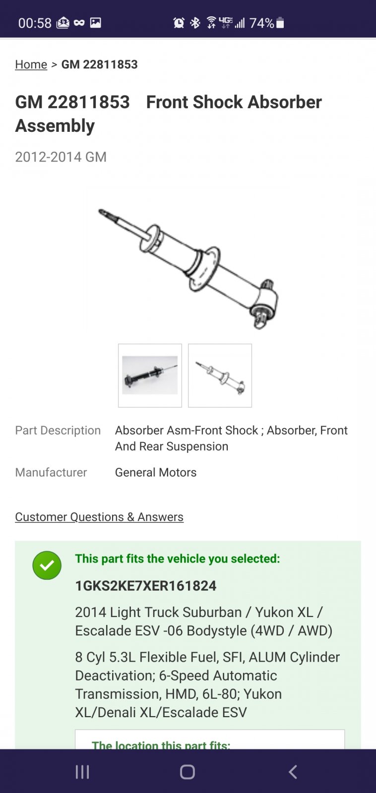

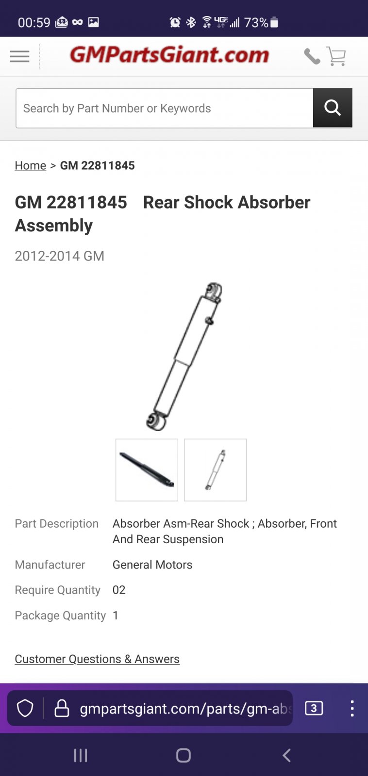

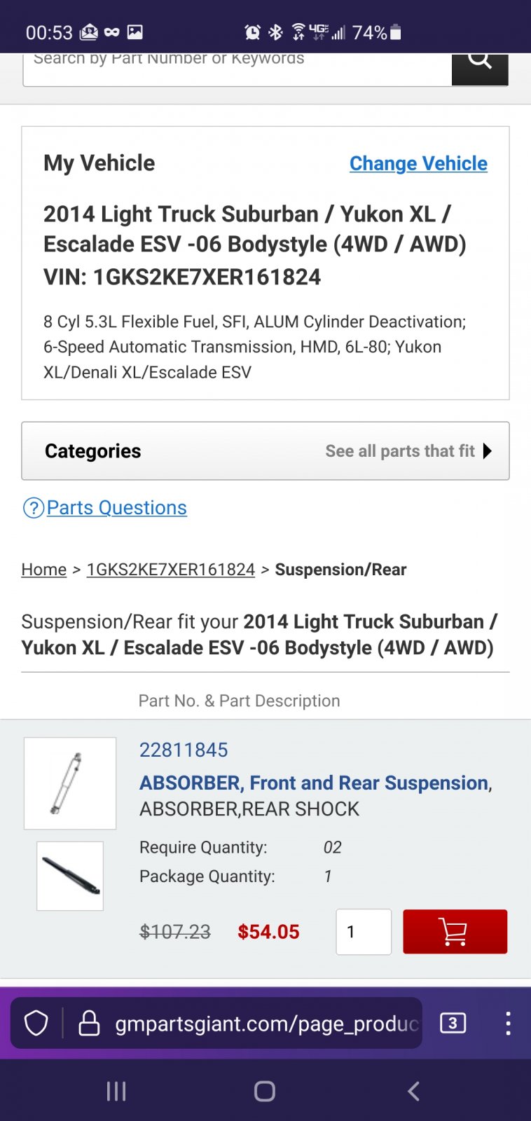

According to gmpartsgiant with your VIN plugged in this is the part numbers for the front and rear shocks and struts. You can also use gmpartsdirect and plug in your vin. I have noticed if I use gmpartsdirect and plug vin in it still shows me all options for other rpo codes other than mine. Gmpartsgiant seems to pull parts just for my vin.

According to gmpartsgiant with you VIN plugged in this is the part numbers for the front and rear shocks and struts.
Notice how this says from 2012 to 2014 also.
