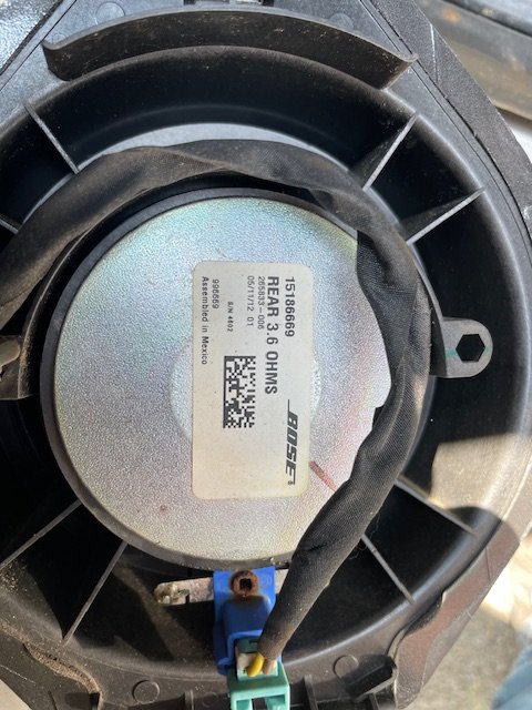

Bose speakers have non-standard impedances, with impedances between 1.3 and 3.2 Ohms, versus the industry standard of 4 Ohms. Pull out a rear door speaker and see what the impedance is stamped on the magnet, and that is the impedance that you need to shop to to replace that speaker.

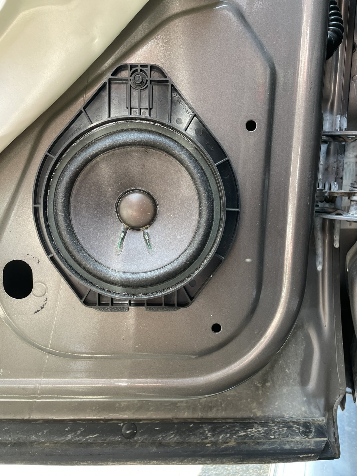

Can I add vehicle pic to my profile or something? Also I'll try and attach pic of speaker though you may already know what it looks like. I thought a 2 way speaker the tweeter always stuck up a little at least, my speaker has a dome in the center but does not stick up at all so I thought it was just a one way.

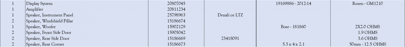

2012 Tahoe LTZ with stock Bose sound and Navigation. Need a rear door speaker. I believe they are component speakers, but what are they - midrange, woofers? I've looked many different places online and can't get that type of info anywhere. Is it possible to get more info on my system like do I have a subwoofer and separate amplifier and where are these mounted? Crutchfield even pissed me off. Look for speakers for my vehicle specifically and they give me what I believe are component (single), 2-way, 3-way options. I believe I want to just replace a blown speaker pair with an upgrade if possible. I'm not thinking I'd want a 2 or 3 way since that's not what is factory, but I'm no expert. I can get direct replacements from gm parts sites if necessary, but it looks like they aren't Bose?
This forum contains many posts related to your system, the amperage, ohms, how it's wired and where everything is located.
I replaced all of my speakers with GM OE from various sources including Amazon and Ebay a couple years ago. The subwoofer is tough to replace but can be done, it's a Bose.
These are my notes:
My truck has the 9 speaker system with the dumb amplifier. Your LTZ may have the Bose Centerpoint system with the 10th speaker in the middle of the dash. It has a smart amp.

As @Doubeleive stated above, your rear door speaker is a full spectrum speaker (1 speaker with 1 driver), and not a coaxial speaker or a component speaker.
You can substitute a coaxial speaker of the correct diameter in your rear doors, and that 'may' improve the sound quality a tiny bit, but remember that the Bose system is a premium system and their speakers are of high quality. If your existing speaker is damaged or blown, then any replacement speaker would be an improvement.
