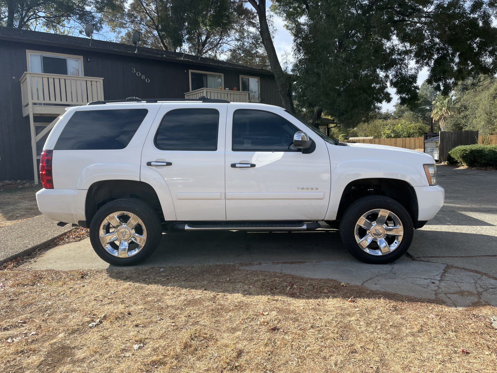

@Hoganator I am running between 3-4 inches of suspension lift. If you end up going past 2.5 inches of suspension lift you will want lifted upper control arms and an adjustable rear track bar.
