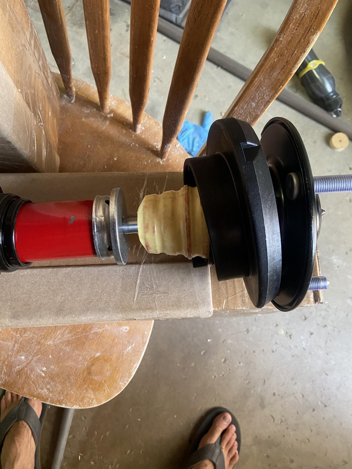

@NOSOK My experience installing the MOOG 81244 spring onto the Bilstein 5100 was stressful to say the least but go slow and it can be done without much drama. I used 2 sets of springs compressors, I used the kind that are 2 threaded rods and each rod has 2 clamps that grab the spring. So in total I had 4 of these rods compressing the spring when I installed the spring onto the 5100. The one tool that would make this job easier is a tool to tighten the top nut of the strut while holding the shaft still so that you could tighten it. I am not sure of what to correct tool is called but I am sure there is one out there.
Sorry for randomly chiming in, but I currently have bilstein 5100 struts with the springs from one of the cheap acdelco professional struts. Do you think the moog 81244 would help with my ride? Going over bigger bumps on the highway is extremely jarring currently.
Dustin Jackson
Aug 9, 2018
1,788
2,064
@JewBoi It's possible. I am not a professional, just a hobby mechanic. The 81244 is a pretty stiff spring compared to the factory springs, the 81244 will give you lift over factory. I would say that if the springs you have are too weak and your suspension is bottoming out over bumps then the 81244 spring would help but in this case I think it has the possibility of making it worse. The MOOG springs and 5100's give me a firm ride.

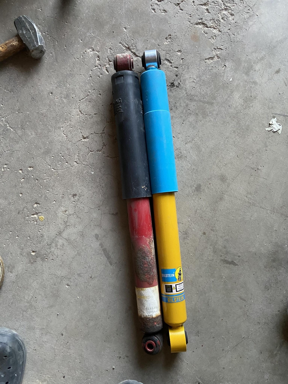

Finally got around to installing the stuff in the rear. Put in new control arms (upper and lower) and Bilstein 4600s. Despite the appearance the old shocks still had some life left in them - not totally shot at 160k miles, although the rebound was probably 50% slower than the new Bilsteins. Old control arms probably could've been reused - which would cut the job time in half.
The job wasn't terrible, and was about what I expected. With my wife's help, I did it in ~3 hrs, including a tire rotation. The 2 most annoying parts were accessing the top shock bolt and nut and then reinstalling the fender liner. A cordless impact made short work of bolt removal, and we were able to use a crescent wrench to hold the nut for most of them. That wouldn't fit on the top shock bolt so we had to very awkwardly cram a breaker bar and a deep well socket in there. A 21mm stubby wrench would have made the job far easier but I didn't have any that large.
As for ride quality, high speed impact control is greatly improved. Far less crashing/bouncing over bumps at 50+ mph. At lower speeds there's a moderate improvement - mostly in the noise department - no more creaking over speed bumps, but it is a little smoother. I'm glad I didn't go with the 5100s, I wouldn't want anything firmer than these. Overall the 4600s are roughly on par with the [aged] factory Z71 suspension comfort wise.
Did not replace the jounce bumpers as I couldn't find them in stock, but mine looked pretty worn so it might be a good idea to replace those at some point.
