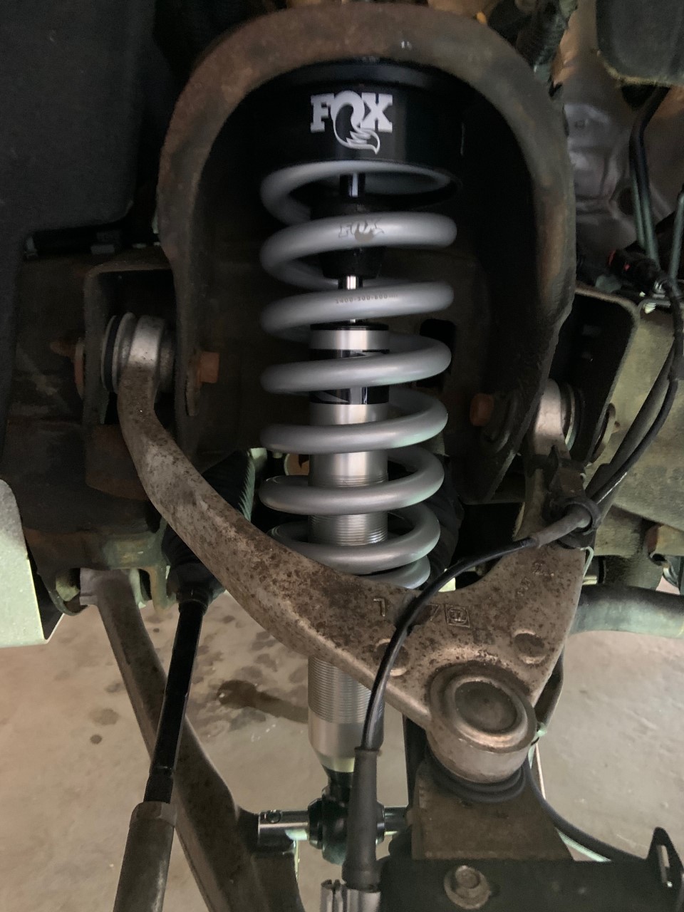

Below is a picture of the new coilover next to the stock strut that was removed.
It is a cell phone picture, so I apologize for the lack of clarity. I should have also shown with a measuring tape the difference in length between the two. The new coilover is about 3/4" longer than the factory strut. Once installed, like Z71_BURBAN, I experienced 1.75" of lift and am very pleased with the height. The ride is also superior to that of a leveling spacer, in my opinion. I know that it may settle a little, and I certainly hope that the settling isn't too extreme or I may have to remove them and turn them up a little to restore lost height. Here they are installed, followed by a couple pictures of the completed truck.
