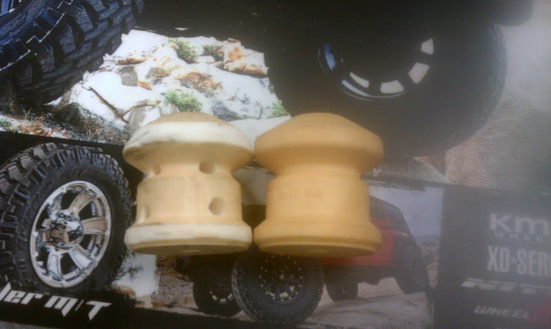

Drilled out the Z71 stops, we'll see how she rides with these:
Modified vs. Stock:
Great idea Max-you always got some good ones. Let us know how that rides, i.e. any better then before, less or more bouncy, smoother, stiffer ect....
When I bought those Z71 stops off you, what a difference. Been riding with mine shaved n chopped for almost a year now, and felt better then stock, IMO. But would like to know how the holes effect the ride. Thought about it before, but never tried. Interested to see how it rides.

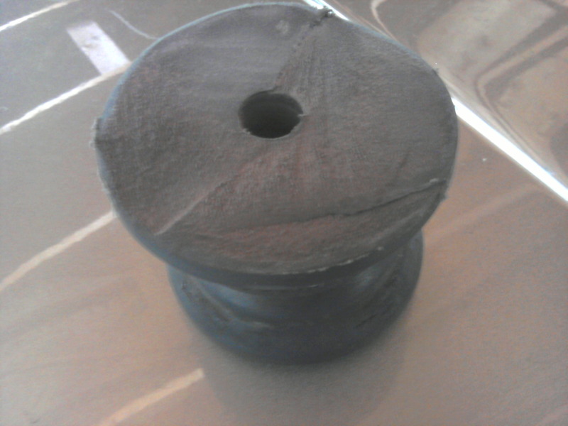

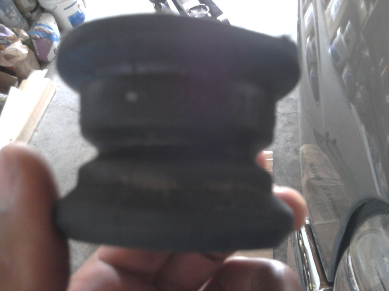

Ok everyone. I got 'em installed. I shaved them down to see how it would ride with just shaved stops. So far so good. I'll put a hundred miles or so on them and if I'm not a fan, I'll add the "speed holes", LOL. For everyone asking about the crappy look, I just cut them with a bandsaw. I know there are better ways but this was quick and easy :shrug:
Trimmed stops:
I wanted to make sure I got the 1/2" drop I wanted so before I took apart the truck I measured hub to fender with the untrimmed stops and got 17.5". After trimming I got 17" dead so that was great! I took it for a spin around the block and found it still rode pretty well. Def firmer than before trimming but still good.
New measurements: 31"/32" F/R ground to fender and 17"/18" F/R hub to fender. I got my rake back and no more camber issues :D

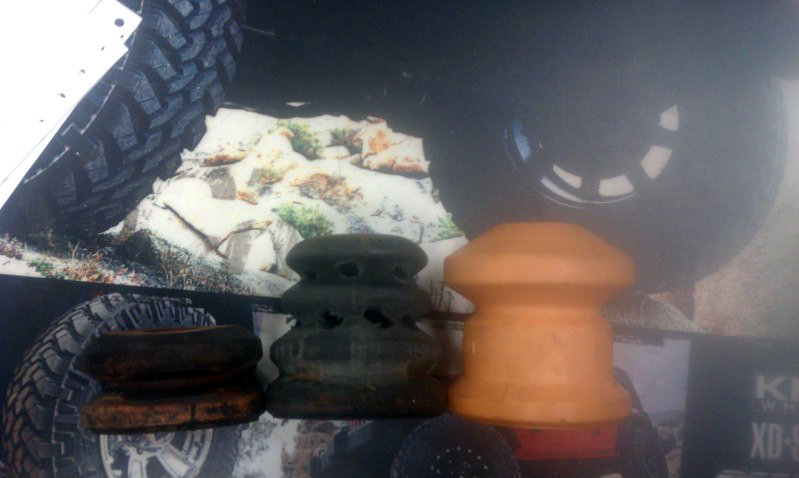

Differences between trimmed stock, drilled stock, Z71 stock stops:
A
Alex33
May 6, 2009
1,235
25
That drilled stocker looks pretty nasty. I would be curious to see how the air bumpstop works.
Max
Mile High
May 3, 2009
3,570
33
Denver
They were free so I figured what the hell :shrug: Gave me positive reinforcement toward modifying the Z71 stops. I need to rob a bank so I can buy everything I'd like to try on this thing. FML.
