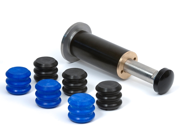

The poly daystars are pretty cheap, I'm gonna try to use those first. Might be easier to weld the cups for the pro comp airbumps though. I'm not a very good welder so my homie is gonna help with the hard stuff. Just takes time, budgets suck.
