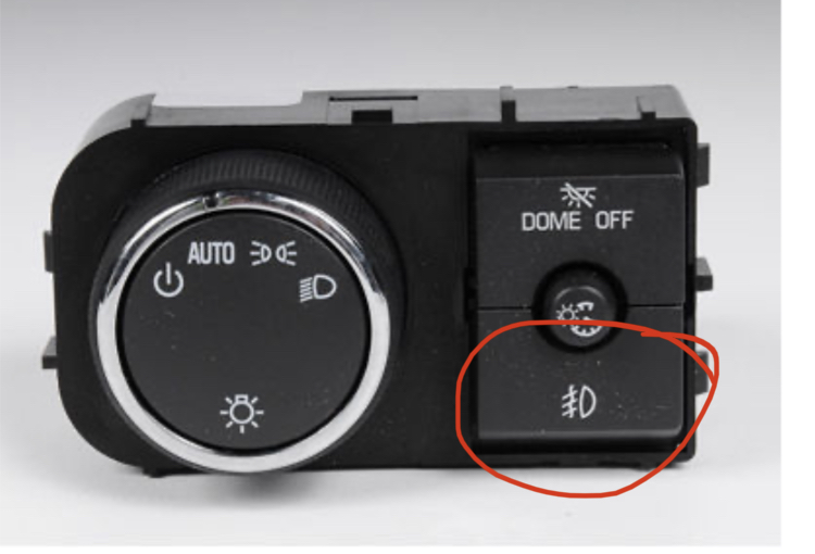

wondering how this could be done? being able to turn on and off just the fogs when the ignition is on.

Isn’t that what the button circled in red is for or do you not have it?

I think what he means is if you try to hit that switch in the day time with the headlights off it automatically kicks the other lights on as well. I had this issue as well when I was messing with it one day. Can't remember if I had the Auto light function disabled. Usually that is the first thing I do when I fire her up though.

I know at night with it set to auto you can turn the dial to the off position to turn all lights off then hit the fog light switch and the parking lights and fog lights come on, no head lights.
Maybe you have to turn it to parking lights instead if auto after turning them all off, can't remember.

Yeah that could have been it, I can't remember now. Have to check the manual out...

run a toggle switch to the fog lights and then power it from accessory (key on) power that way if you forget to turn them off it doesn't drain the battery. easy to do by running power from the drivers kickpanel thru the firewall grommet. you can get all the stuff needed at almost any auto parts store.

Ok I just tested it and this is exactly how it worked, both in auto and manual.
