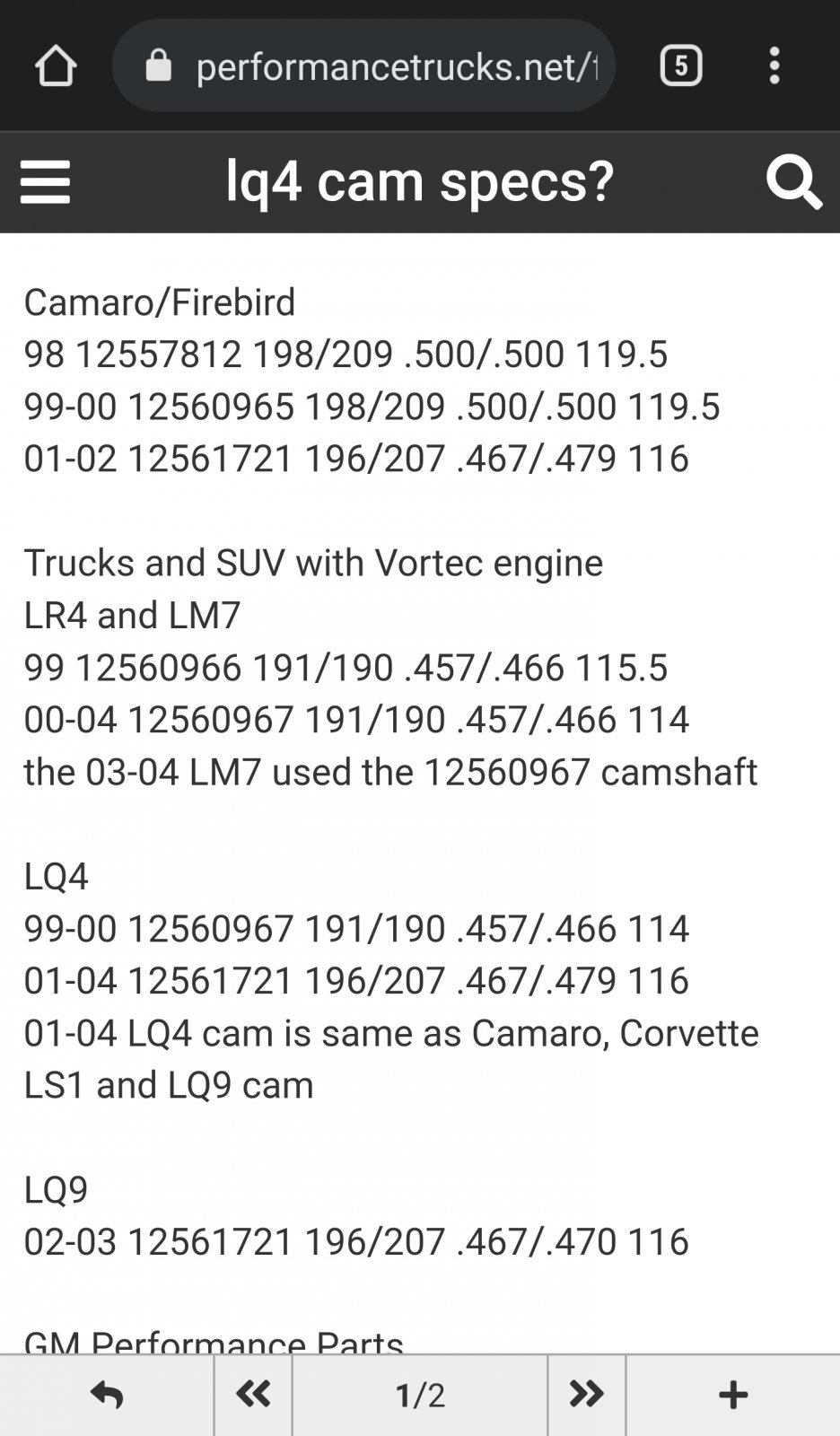

And that is the key. Im pretty convinced that GM crippled the 6.0 with the wrong cam from the factory.
Why on earth would you put a cam from a f body in a truck meant to pull and carry loads.

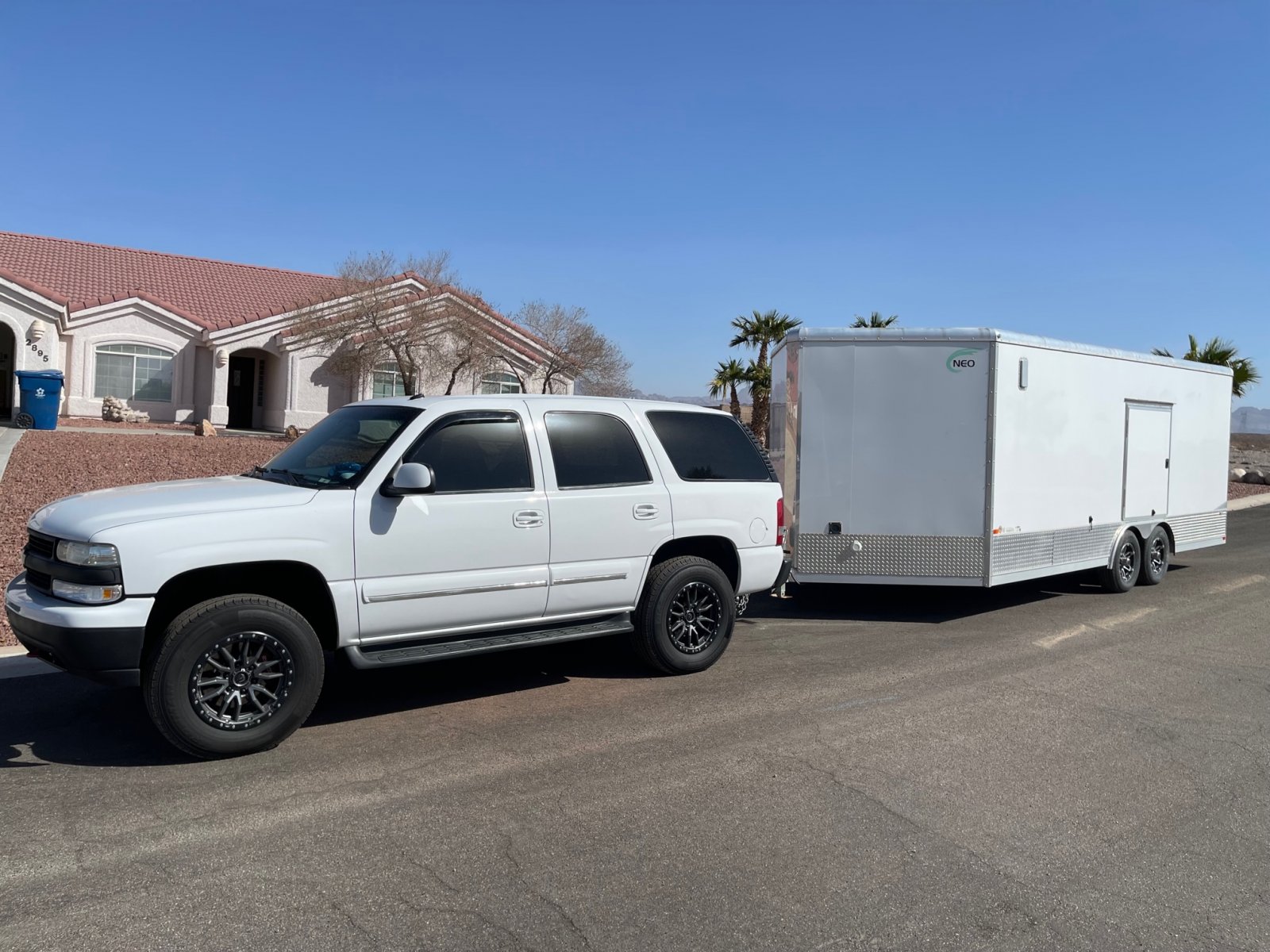

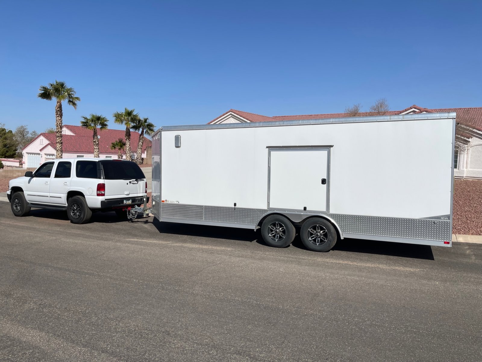

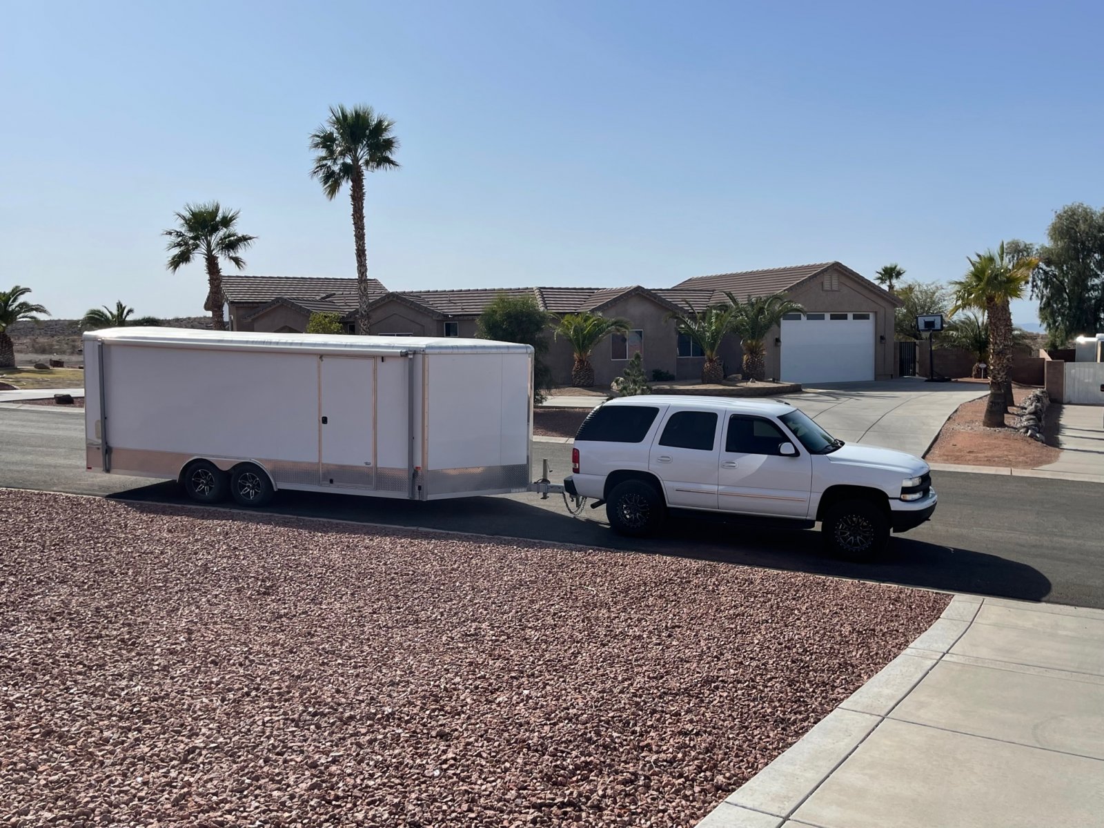

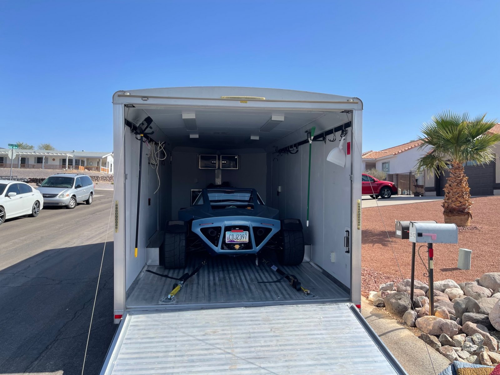

I've decided to put the 6.0 Tahoe to the test on towing......Trailer + car inside + spares + tools is about 6K lbs.
Towed it no problema....I was worried most about the tongue weight. As you can see it is squatted a bit but not much.
I have Z71 springs in the rear. But it handled great!
If this Tahoe had an 8 or 10 speed trans it would be perfect. Towed about 200 miles round trip. 10-11mpg. temps were fine.
19+ chevy 4P calipers worked awesome.
