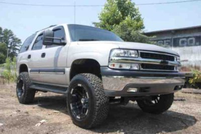

I had 6" with 3" body they fit fine look good but if mudding you'll rub! From flexin little bit. + you'll have to tighten your tbars all the way up which is going to cause more stress on your wheel hub bearings and cause Camber problems and wear your tires out faster and my 37s were bold to and I was having problems still when turning sometimes and rubbing jus from body flex in sharp turns. I know took my 37s off and have 35s.
---------- Post added at 09:55 PM ---------- Previous post was at 09:54 PM ----------
that's mine with 37s
And this is it with the 35s on 20s
