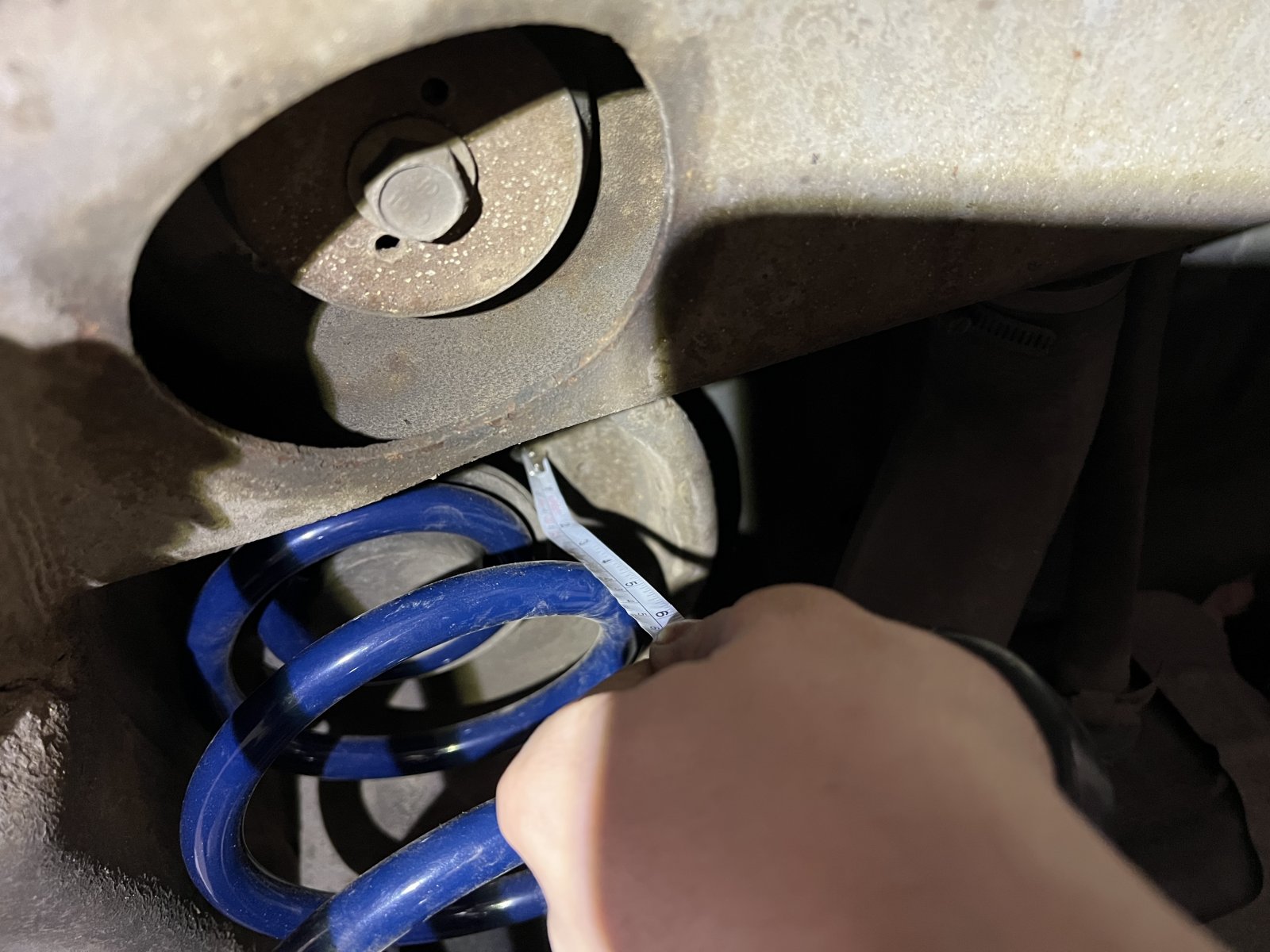

I just recently bought a 2003 Tahoe LS 4x4 with 200,000 miles. Suspension was original in pretty shot. For the rear; I went ahead and ordered Bilstein 5100 24-185783 shocks on eBay. (Description stated that they would work with my truck and would accompany 0-3 inch lift.) I ordered Bilstein 199021 coil springs to replace original GM springs.

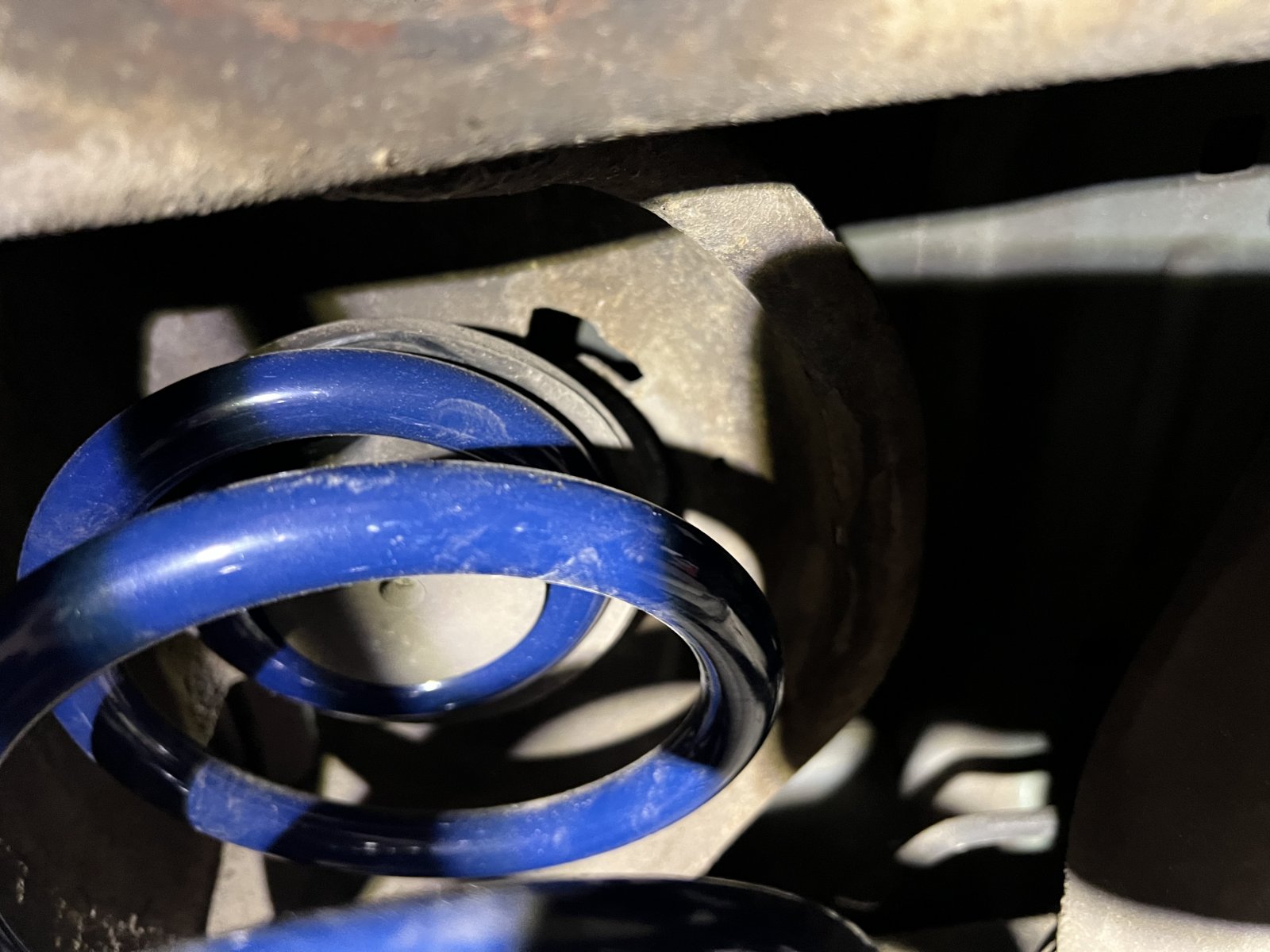

Now I’m under the truck now and installing both new shock & spring and the coil springs are too short and not secured into position while in full droop. I can physical pullout & remove the coil with ease even with the shock & sway bar links fully secured. It appears that there is approximately a 1.5” too short.
My goal is to get a level stance on the truck. I just installed Bilstein 5100’s 24-186643 on the front (0-2.5in lift w/ torsion keys which I also have.) I was looking to achieve a level stance on the truck by keeping the rear height Factory and lift the front w/ maxxcam torsion keys by 1.5”.
Unfortunately I’m just outside of return policy on the shocks, so I have to make do with those. (Coils I should still be able to return since I ordered a few weeks after shocks.)
What should I do to fix this and what are my options? (Return springs for a taller spring; if-so what spring? spacers? Will this affect the front now and if so what’s the solution there?) I can’t imagine that the setup is safe as it currently stands.

Welcome to the Forum from NH.
I'm not knowledgeable on lift kits, but other folks on this Forum will chime in.
I believe that there are rear spring lift kits that mount between the rear axle and the bottom of the spring. Perhaps, there is a 1.5 or 2 inch rear lift kit that could resolve your issue.
