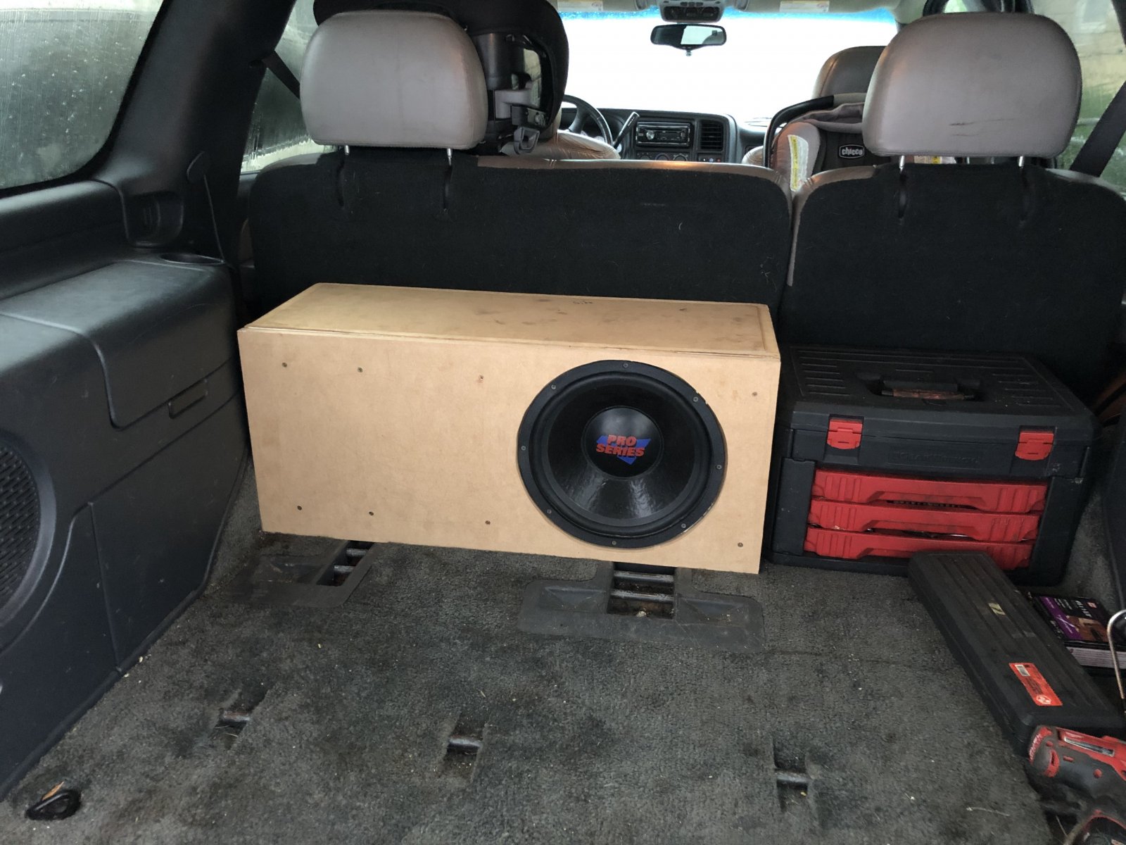

Have a pic of your sub setup? I like old school audio like that.

I’ll definitely grab some pictures for you… I know everyone loves pictures!

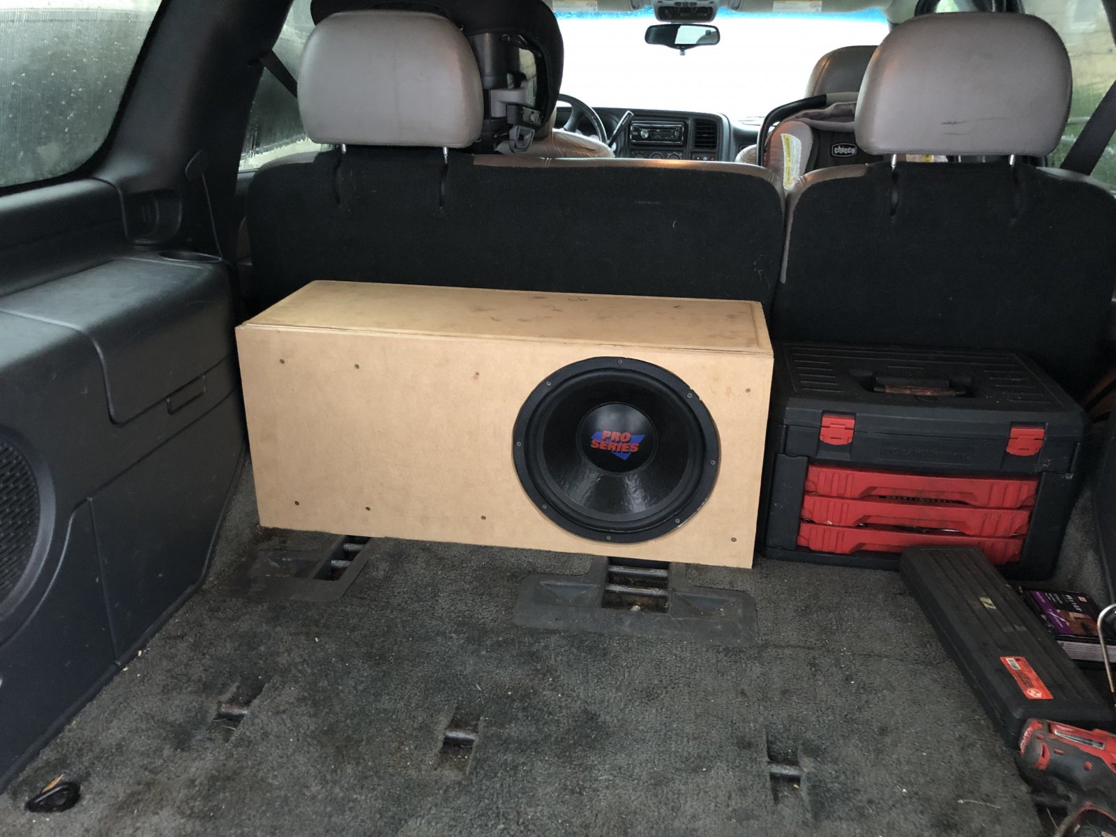

Here’s a quick shot of the sub! The amp is under the seat…

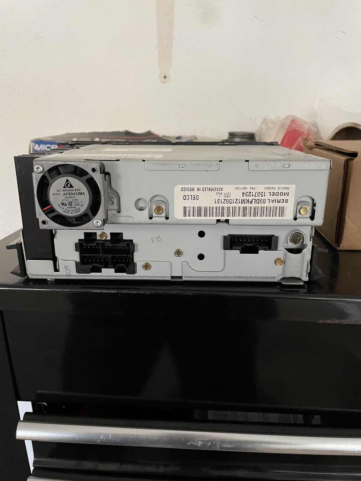

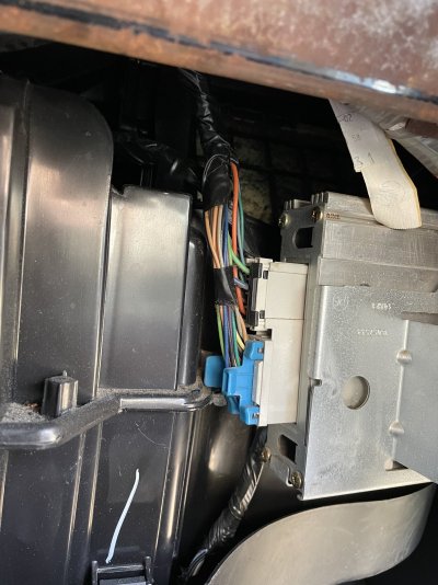

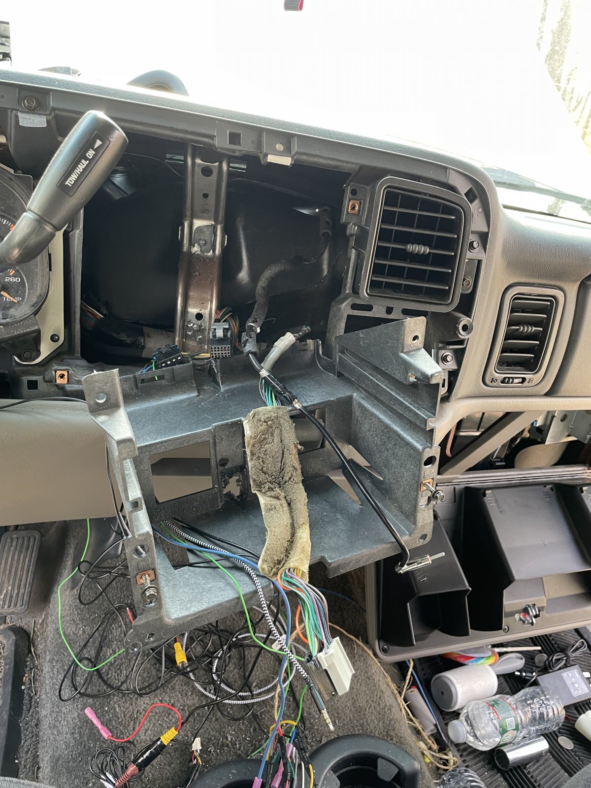

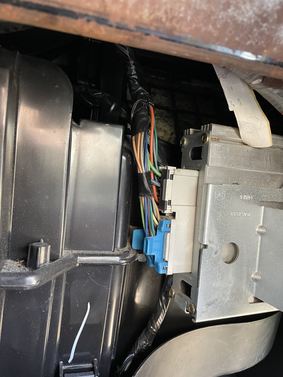

So here is the amp, radio and the big hole i made in the dash. Still can't find the stinkin amp harness. Would it be coming from the right hand side from behind the glovebox door? both of those harnesses off the amp go into a much larger tape wrapped loom. the 20 amp fuse under the hood is good. i got the fuse diagram off this forum.
The radio and amp harness are integrated into the main harness, there is no separate harness
if you are simply trying to bypass the factory amp then you will need to connect your aftermarket output to the amp outputs and unplug the factory amp.

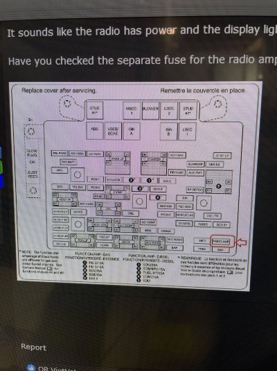

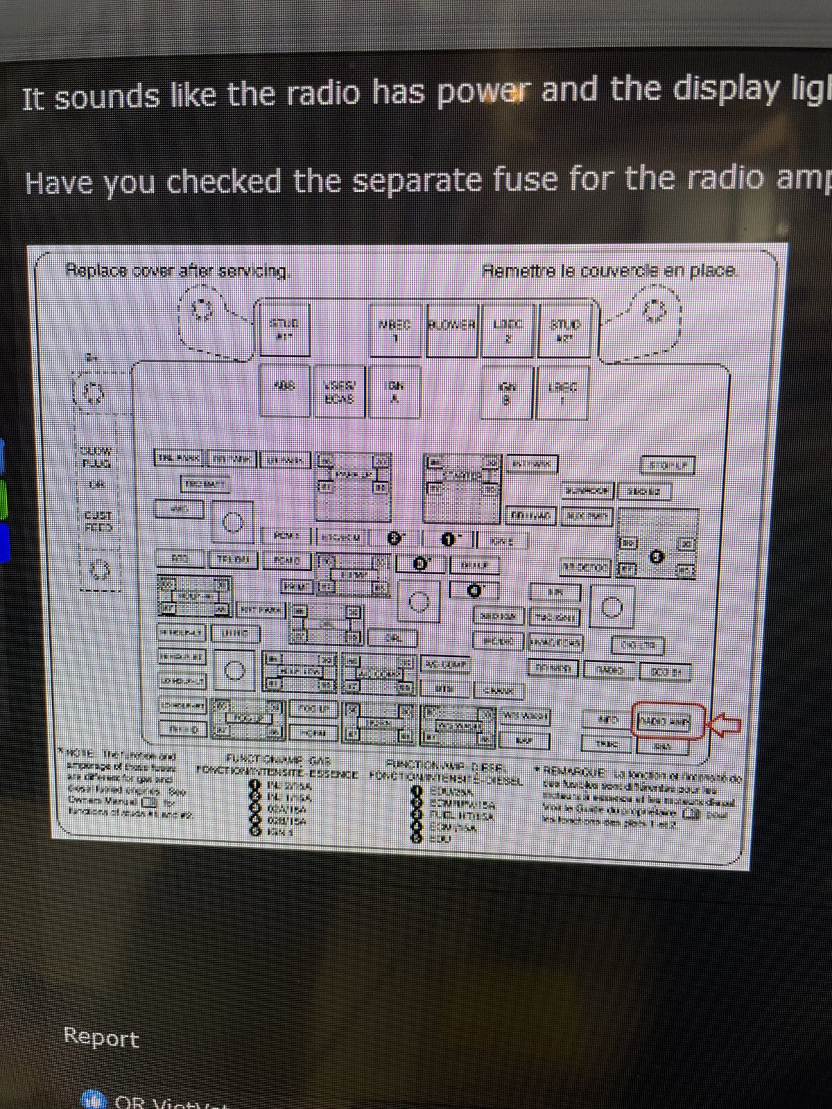

ok so the radio shows 2 plugs but I can't remember how many i disconnected when I took out the OE head unit. I DO NOT want to bypass anything, the rear door speakers aren't working. I initially bought a Metra 70-1858 and the rear door speakers aren't working. I called Metra and they said I need a 70-1859 cuz we have 7 speakers. I sent Metra a pic of the OE head unit and they said i have a second plug for the amp. The 70.1859 has two plugs (the main plug is the same as the 1858 but has a second plug) and one plug has a single red wire on it for the amp. I plugged the OE unit back in using the single OE harness and the rear door speakers don't work either. Thank you for the updated fuse diagram, just pulled that fuse (25 amp) and it looks good. I swapped it with the other 25 amp fuse for the wipers.)

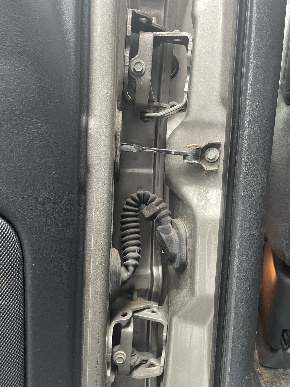

What would you say is the easiest way to test the rear door speakers? Does anyone know what wires are the rear speakers coming out of the amp? What about the door harness? Is there a way of accessing the wires there? If the amp is bad how do you diagnose that?
THnx
View attachment 395313View attachment 395315
you will have to find the wiring diagram for it, one of those harness plugs is the input and other is the output
should be here

I would start at the rear speakers. Pull one and unplug it. Get any old speaker and see if you can jam its wires into the plug and see if it plays. If it does then the door speakers themselves are bad. If it doesn’t play further diagnosis is required…
