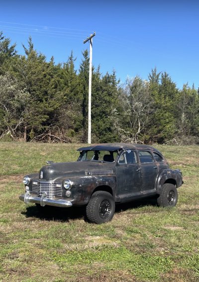

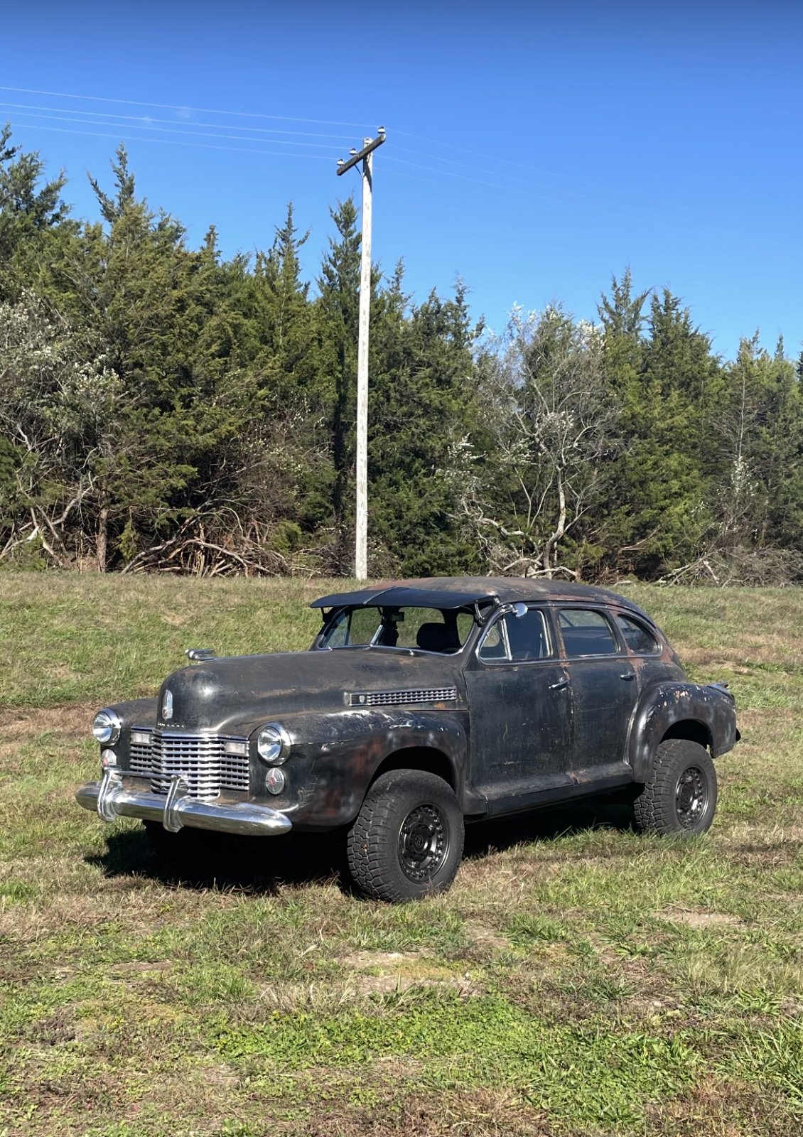

Would be nice to have some vehicle info in your signature so we know what you're working on. Year, make, model, engine, etc.
Sorry, 1941 Cadillac…….sitting on an 08 Yukon Denali XL.
