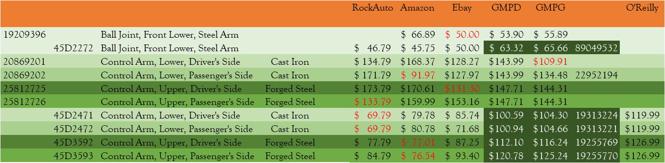

This info is about 2 weeks old and might help:
Can't find the sheet with Moog on it.
