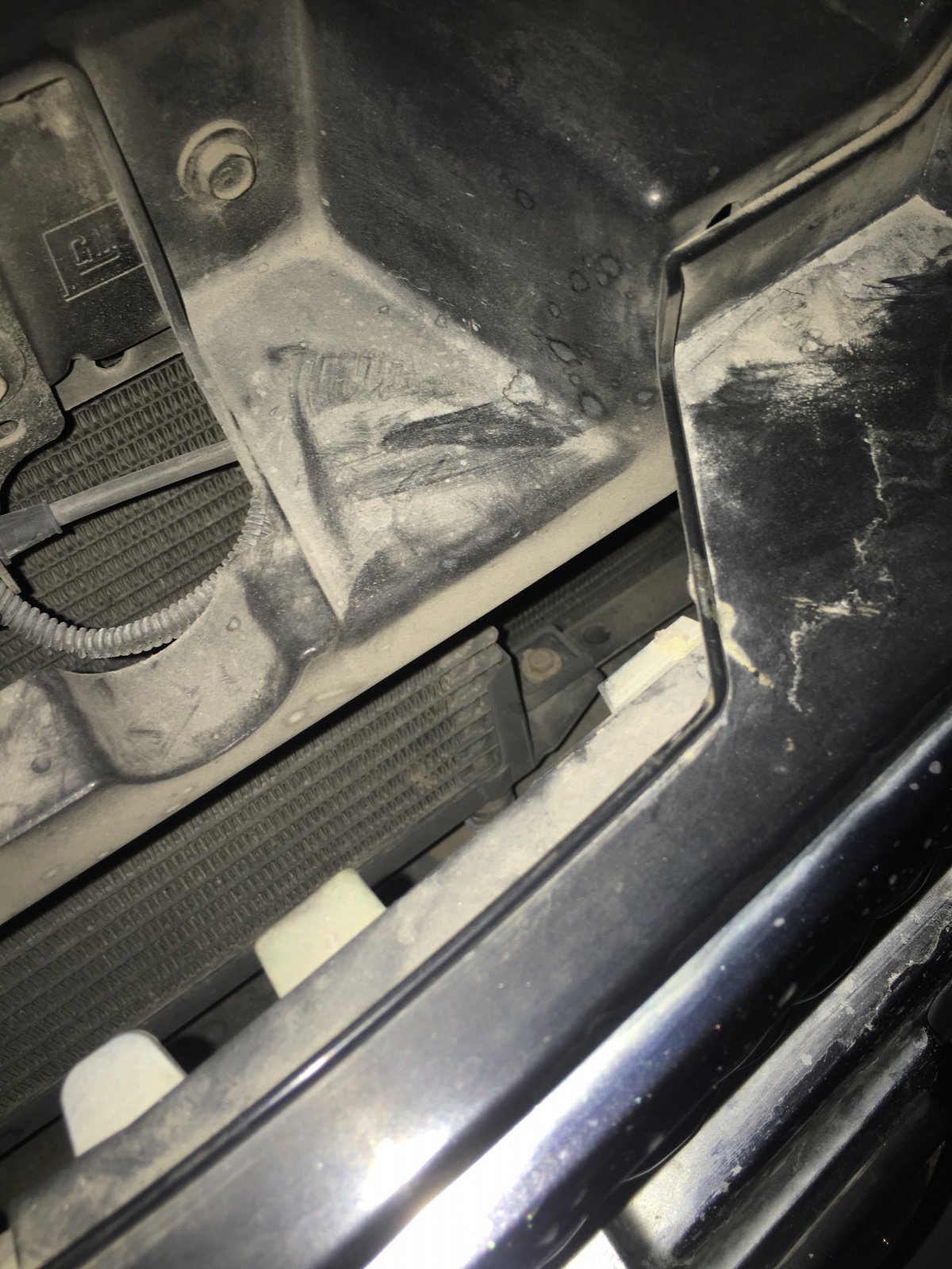

I have found coolant in my transmission's oil after tearing the thing apart. What could cause this? My mind went directly to the radiator but I am kinda lost. I opened the coolant reservoir and there were no signs of oil in, however when the transmission was taken down, the "strawberry milkshake" fluid went out!
If anyone could please guide me to what is in need of replacement here? Where is the oil cooler that could cause this mixing up? Is it on the radiator itself? or is it externally mounted on these vehicles? because I have 2 radiators in my tahoe. A noticeable big one (major radiator), and a factory oem smaller radiator sitting in front of it?

On the inside of the radiator (engine bay side) you should see the transmission cooler lines on the passenger side. If you have an auxiliary transmission cooler (was more like a towing option), you will see in addition a small radiator type cooler on the grill side, may 8"x12"-ish. Not all vehicle had the auxiliary cooler, but all have the radiator cooler.

replace the radiator, the passenger side plastic end cap of the radiator contains the transmission cooler inside it is not serviceable.

There’s the scenario that your truck could have a standard radiator, a thinner condenser (a/c) in front of it and an even smaller trans cooler in front of that.
The main radiator can also have an internally shared heat exchanger for coolant and trans fluid.
