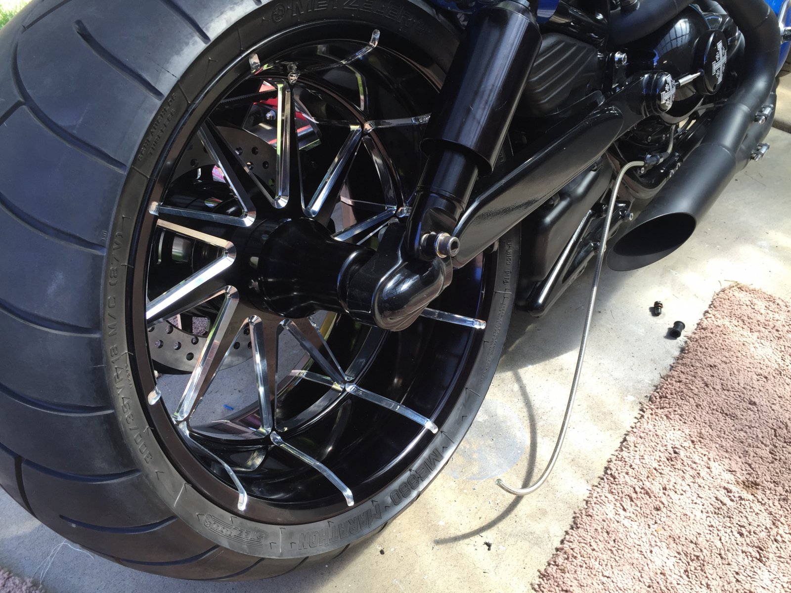

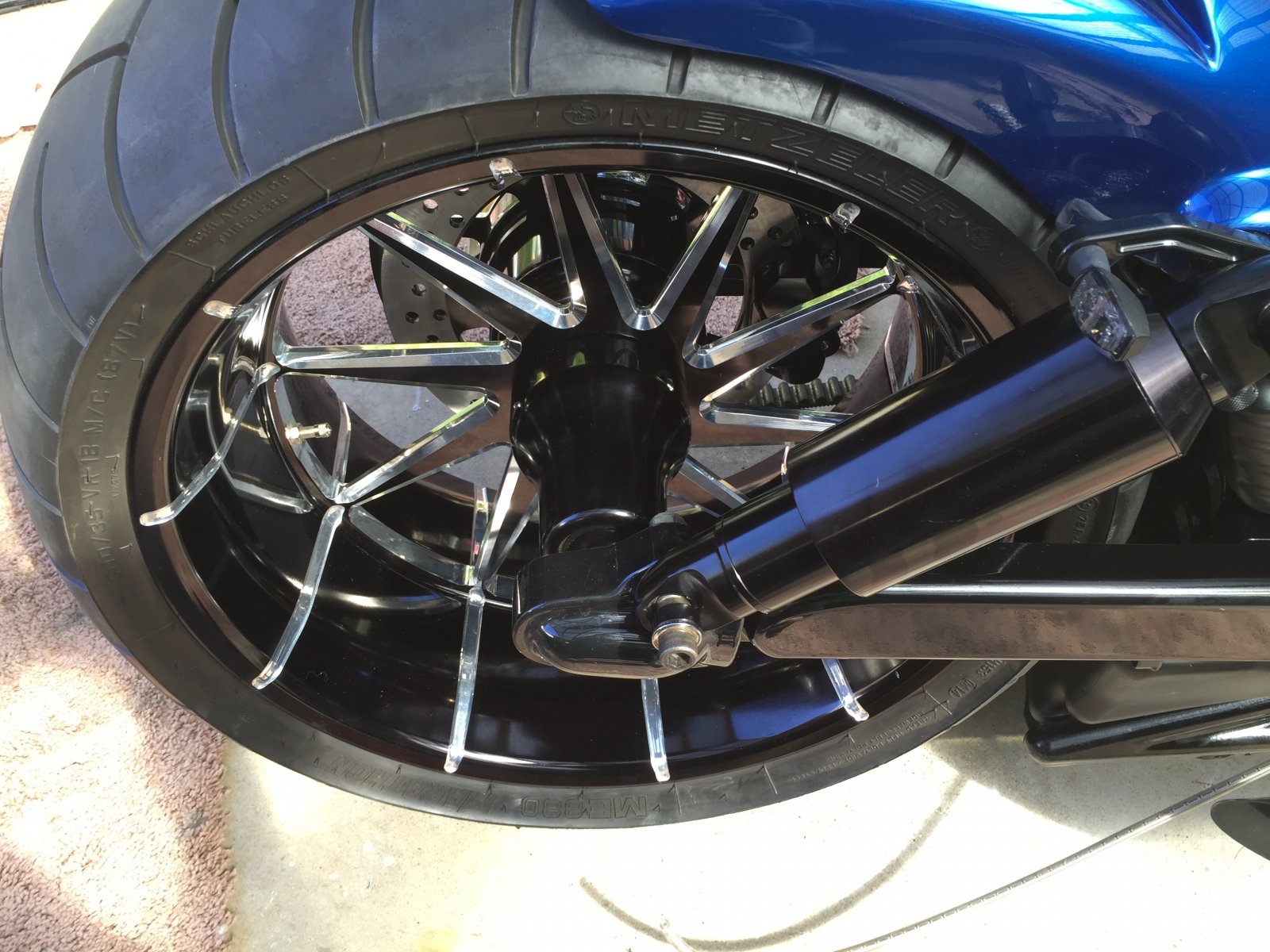

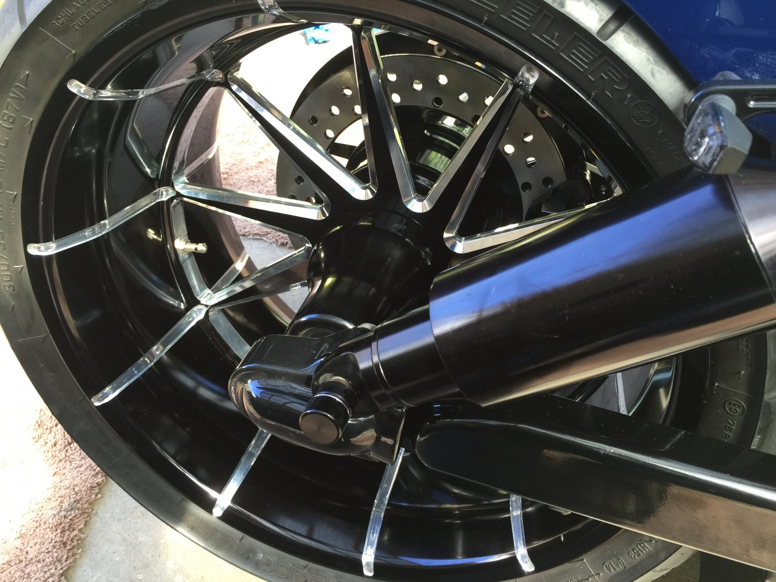

I believe in the real world it depends on several factors such as wheel diameter, width, type, and the type of vehicle. I know there’s no way to properly balance any of my wheels with clip ons that would look good, especially my 26” billets. No way are clip-ons going on the outside of my wheels. I guess you can mainly see them only when it’s stopped but that’s pretty damn important to me. My tire shop knows that for me, looks as well as function is important so they know what to do. On my custom motorcycle wheels, I never used rim weights period. It was done with either balancing beads or a product called ride-on which was a semi liquid that not only sealed a puncture but also balanced the wheel as it was spinning. It's drawback was cost. I am considering balancing beads for my wheels next time I buy new tires. They sure worked nice on my Harleys. I just looked up the chart and it calls for 4 ounces for my 305/40/22’s. You can't use balancing beads on all tires either, just mainly for low-profile or motorcycle. Here's a wheel on my Harley Nightrod that will never see weights. I've tested the balance up to 120 and the beads work. For wheels where they can't be seen or looks don't matter, neither would the type of weights matter to me. Both clip-ons and stick-ons can fall off if not applied properly.

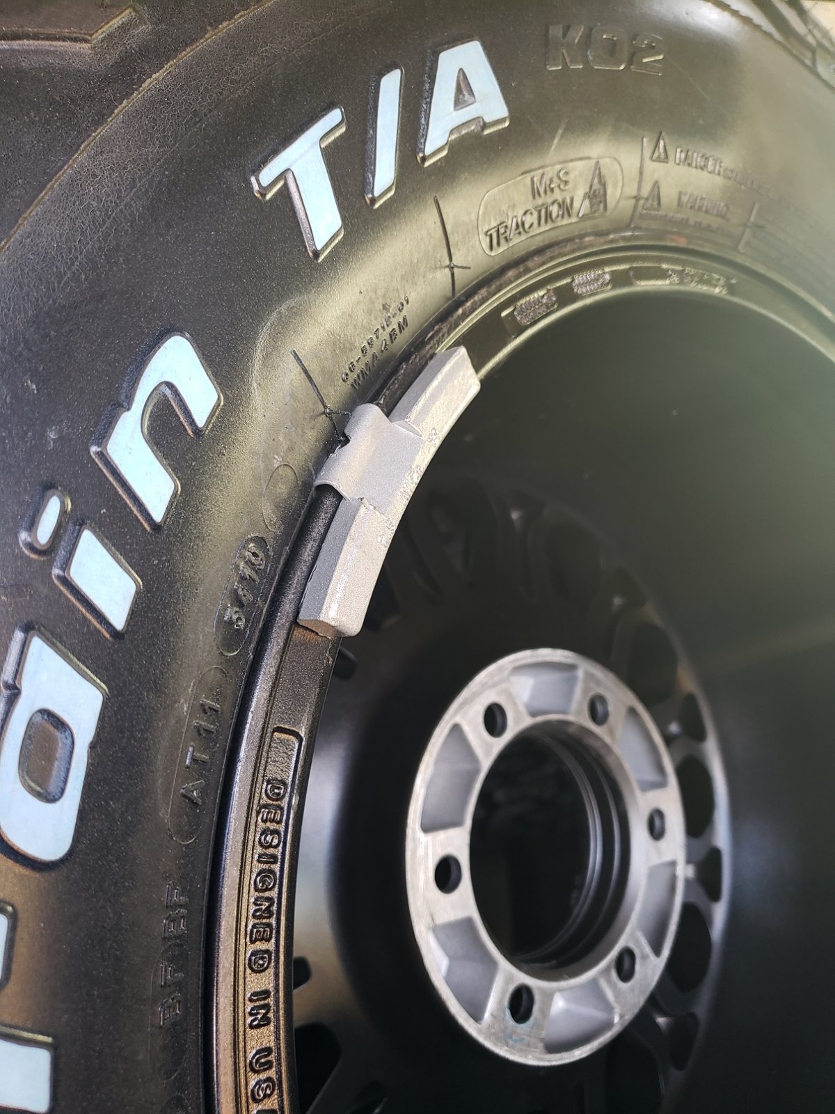

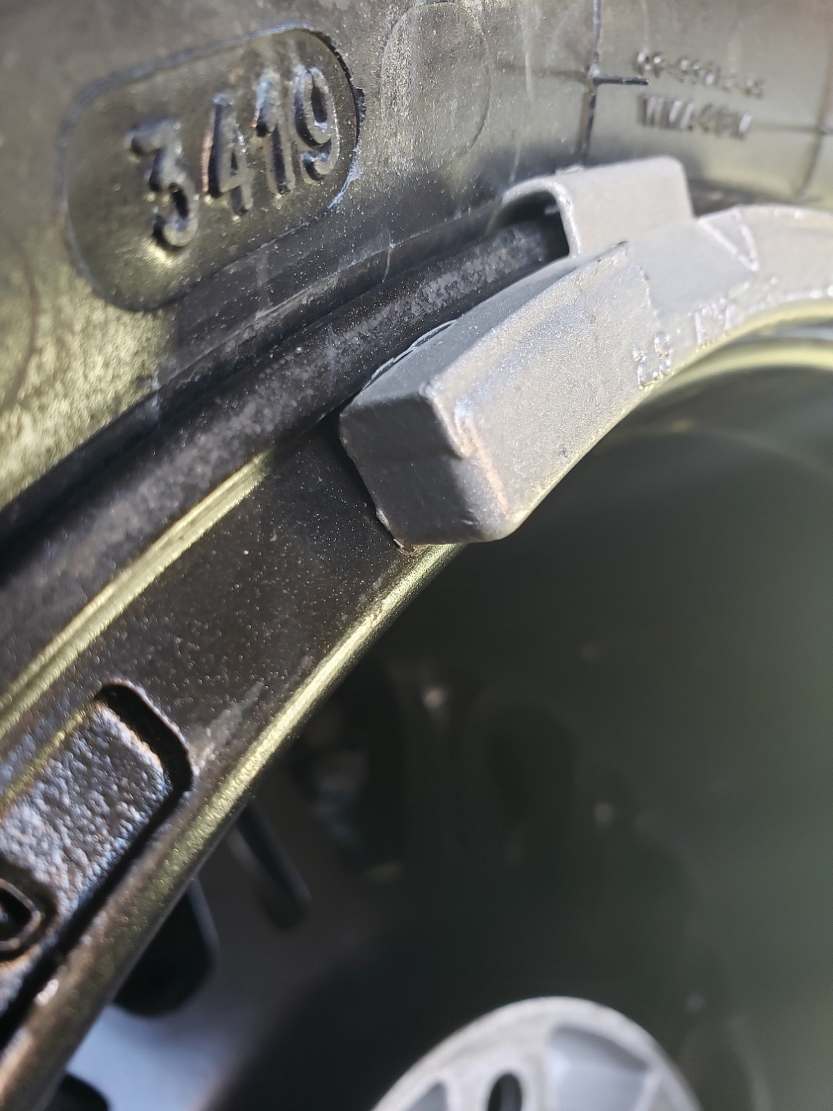

Personally I'd start by going back and telling them to use the right weight. Wrong clip shape for the profile of the lip
Edit: Also not hammered on all the way
