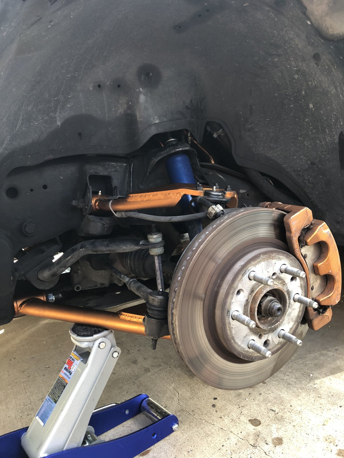

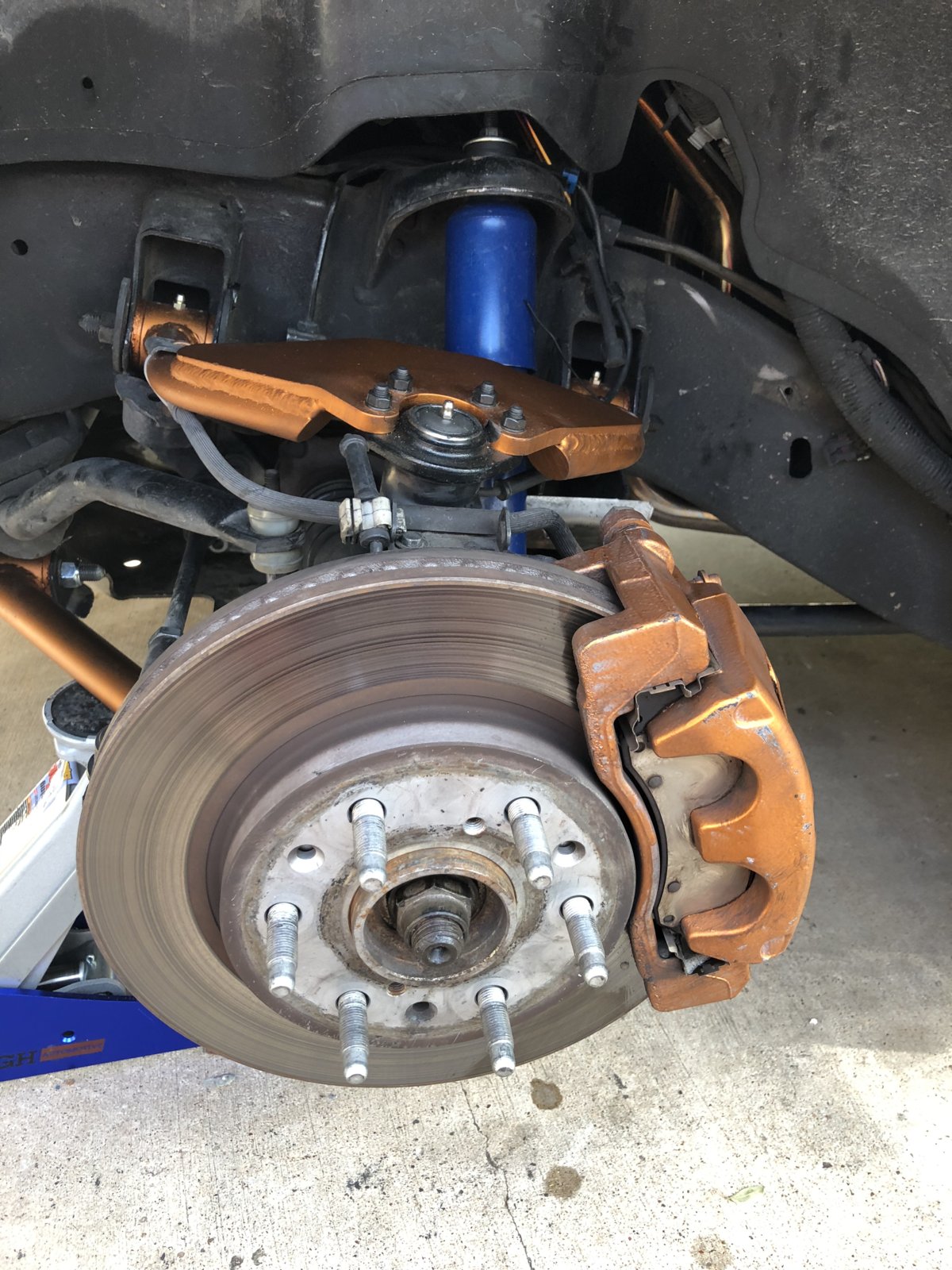

I have them on my 04 Escalade!
4/6 drop thanks to NorCalSS
But I have no issues with them gave me the drop I needed and so far so good
62201D66-21CA-4ADD-9897-966E7EE3F9B3.jpeg B4F63424-8294-4D47-84FA-DB196480AD73.jpeg
