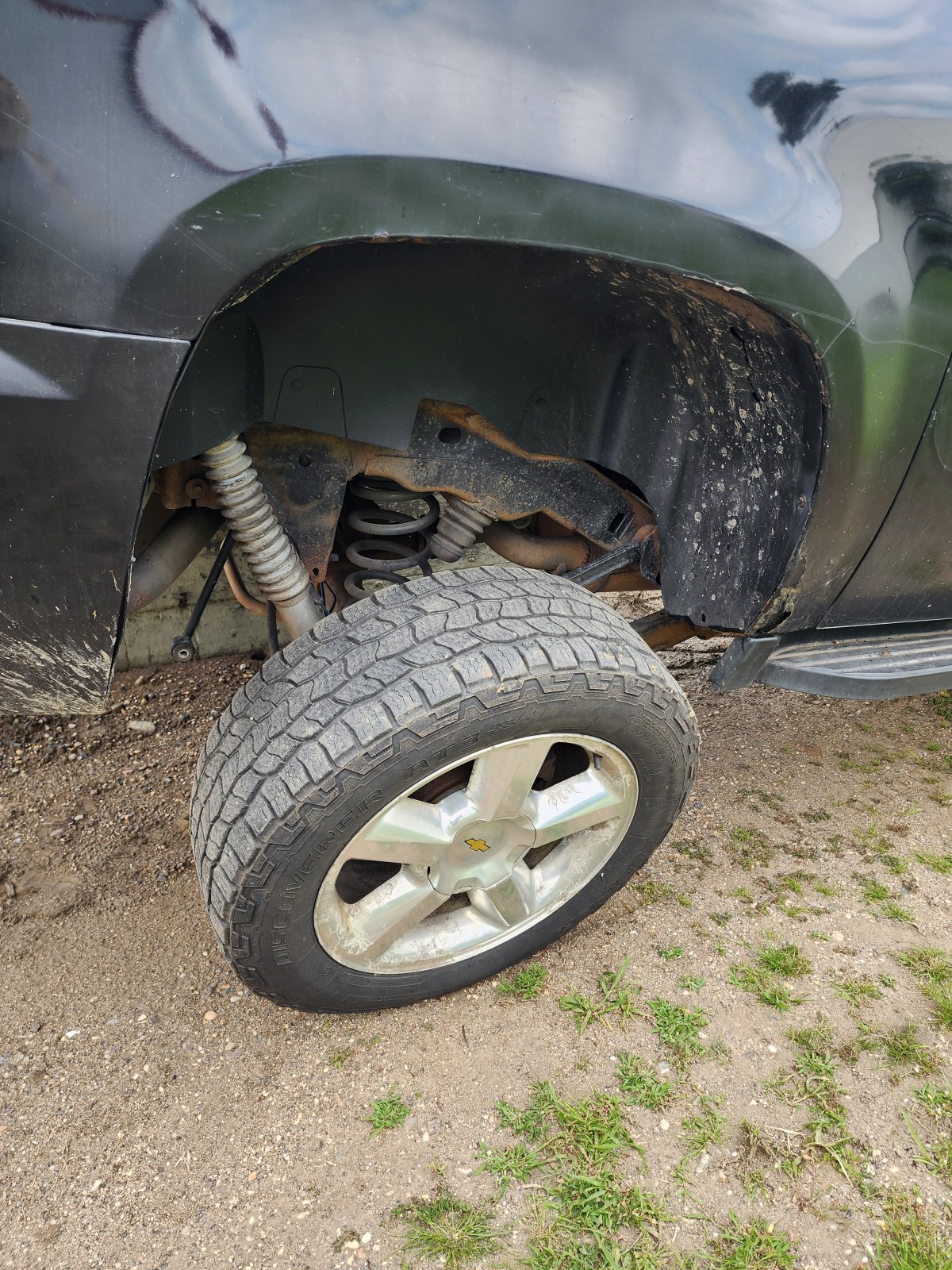

I forgot who it was on here it’s been a number of years since I last posted about this but I currently looking for rear trailing arms for my Tahoe.
Only options I’ve found are apoc and sphoon.
Someone sent me some nice black and billet trailing arms that were for a el Camino but measured to the same length of the Tahoe one’s.
Anyone remember?
Ah I found the pic finally!
So what’s y’all’s opinions?
Thought to run these for the lowers and see if apoc will just sell me a set of uppers unless i can find some billet ones for them too?
Already got the sphoon rear panhard I probably will keep that until I go to do the rearend and I’ll swap to the curved panhard with a aftermarket differential cover

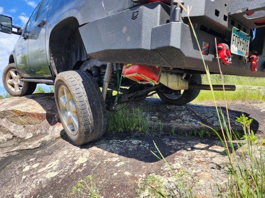

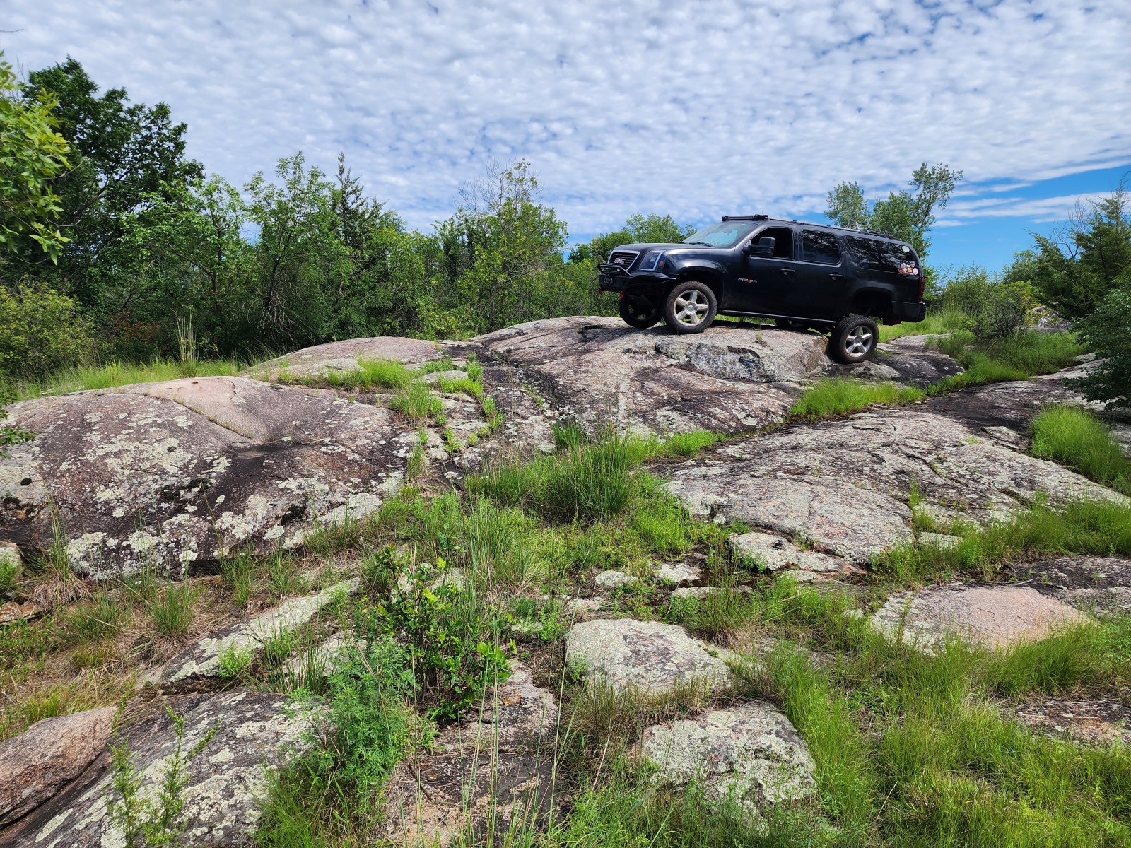

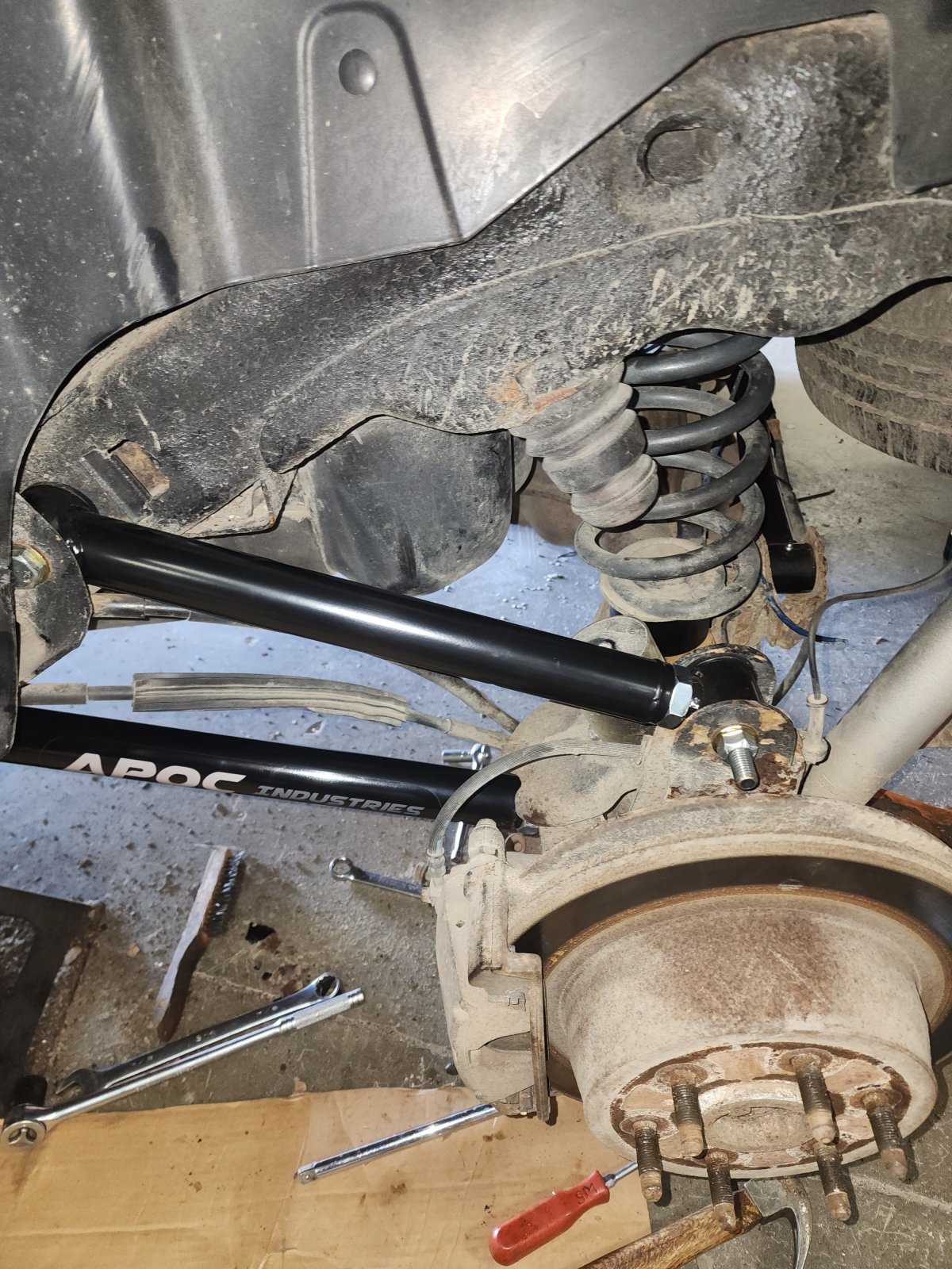

Apoc arms will flex a lot. Not sure for how long. I'm running shocks 3" longer than stock with a 3" extension on the lower mount.

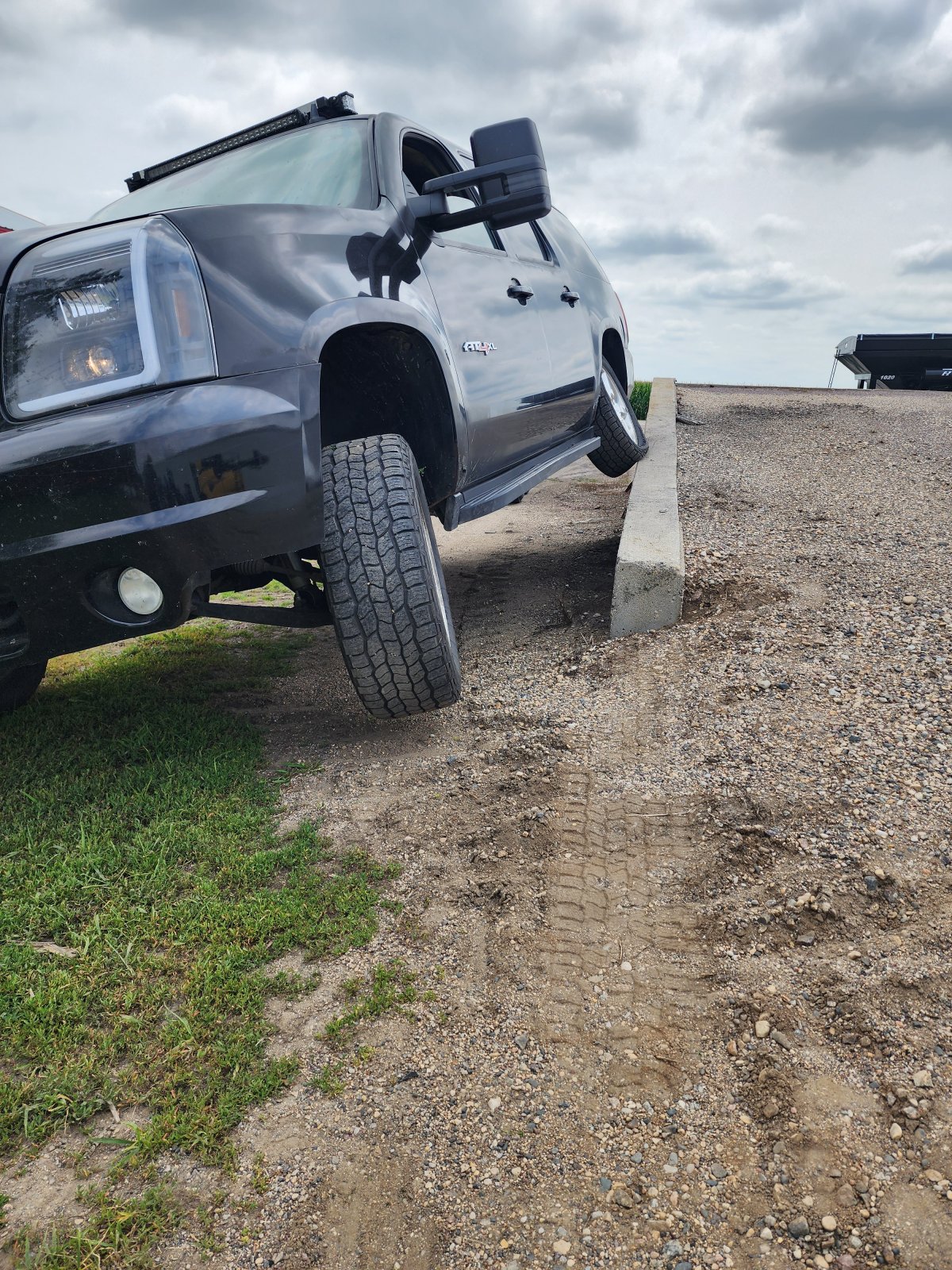

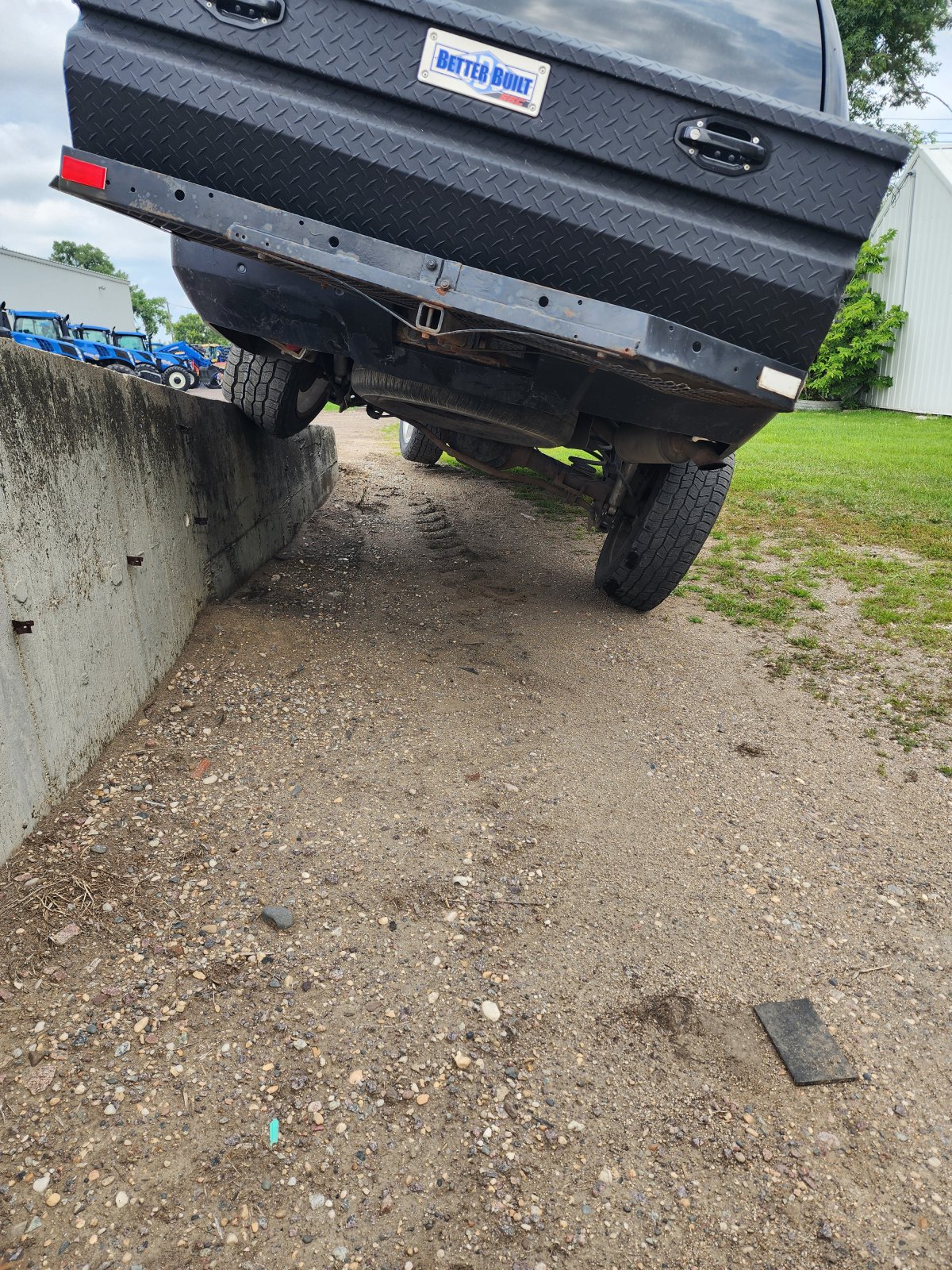

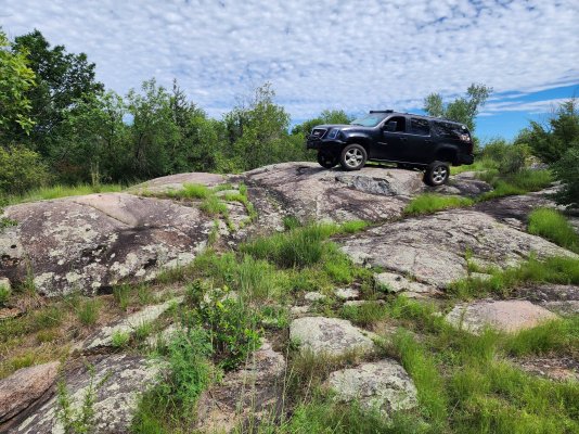

Just realized I didn't have the Apocs installed in those pics, either way it flexes the same.
