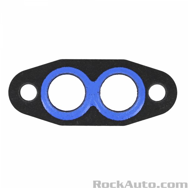

I did not use the oil cooler gasket as that was not leaking. I am happy and no longer staining everyone's driveways. :happy107:
