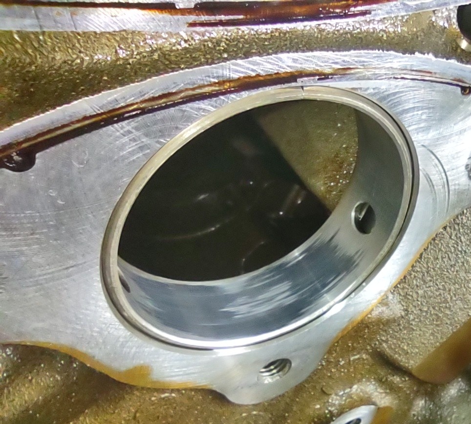

rdezs
Nov 6, 2023
1,377
2,555
LS Cam bearing at 175,000 miles:

Rdezs, the picture posted of the cam bearings in post 25 look perfect to me. The wear shown is minimal. Those bearings were not bored in place. You can tell because they are tin plated. Tin plate is used to help the bearings on start up and it protects them from corrosion before they are installed. Tin plate is a dip process done after the bearings are produced, the plate is usually measured about 25/1,000,000 of an inch think. Your finger nail could scratch off tin plate so your bearings look perfect.
The bearings and block in post #26 look like they were exposed to a lot of heat and oil is cooked on to the block and bearings.
I should have noted the early small block Chevy V8’s, 350 before 1999 had the cam bearings bored in place. I am not sure if that was done on the LS 1999 and newer blocks.
Separately Bored bearings were being released for rods and mains as far back as 2004. They may be doing that for cam bearings today also. Bored bearings have the ability to hold oil in the bored grooves and that proved to enhance bearing life in addition to holding very close tolerances. If I had a choice I would choose bored bearings for any engine I was building but they are not available for all engines.
rdezs
Nov 6, 2023
1,377
2,555
Those bearings that look near perfect are OEM at about 175,000 miles, with oil changes no longer than 5,000 miles. Valvoline 5W30 full synthetic it's entire life. Engine never ran hard or abused. It's an L94.... Admittedly it's one of the best front cam bearings I've ever seen in any LS engine.
