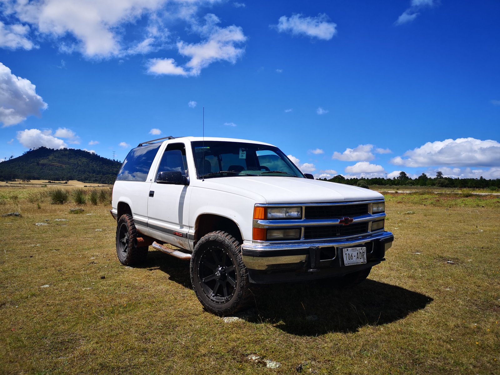

Hello, I am a new owner of a tahoe gmt400, it is my second gmt400 truck, my first gmt400 was a 1988 k1500.
This is my 1995 tahoe, k1500, the engine is a 6.5 detroit diésel
hope you like it, looking into slowly upgrading it
