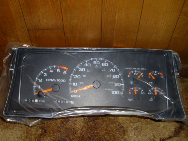

I got the refurb'd gauge cluster I won on Ebay for $14 w/shipping. Checked to see if it solved my fuel gauge problem.... which it did.
Soooooo..... I pulled apart both clusters, and replaced my fuel gauge meter with the one from the refurb'd cluster. Changed over the new clear plastic lens that came on the refurb'd unit to my cluster. Reassembled everything. 45 min. job, and now I have a properly working gas gauge again w/no "Hummingbird" effect.

Nice! thats cheap as hell too!

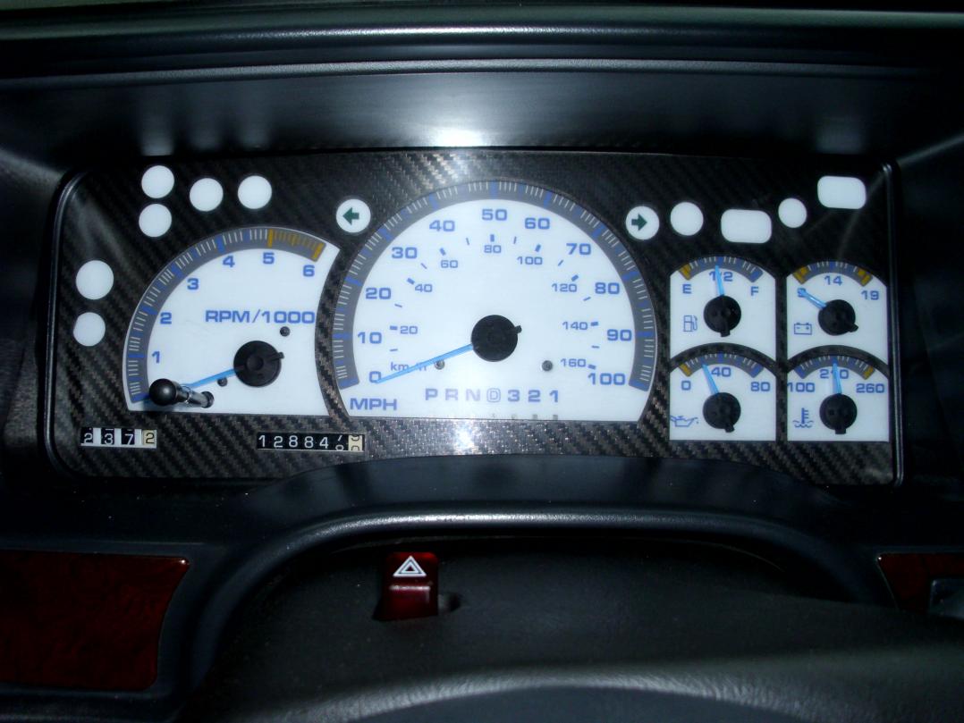

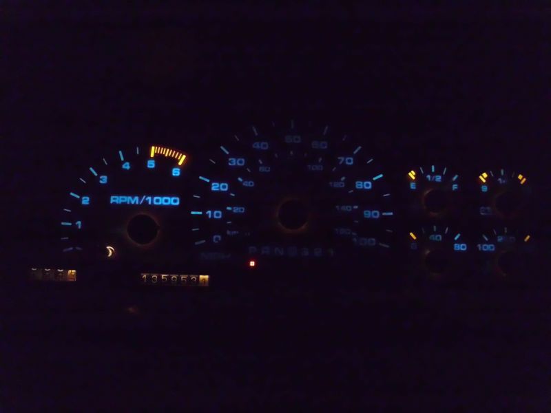

DUDE!! I'm totally hooking up with those and some white faces ... and LEDS. Happy BDay to me!!
Def do it. I like the white face look on the cluster.
Thats why I had to change out the gauge meter itself.... I wanted to save my overlays.
Oh, and...Happy B'day
EDIT: When you get your white face overlay....if your old overlay uses foam to separate the idiot light sections.....save it, cut out the foam, and use it on the new overlay. The white face I got didn't have this, and the light from the gauges made the idiot lights look like they were slightly lit. The foam stops this...I found out the hard way...lol

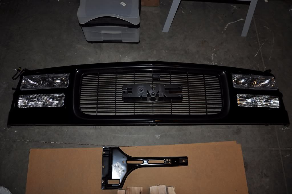

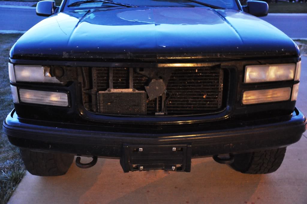

My project for tomorrow.
Current look....
New parts...plus a interior door handle that isn't pictured.

The guy I bought it from rear ended someone last winter. I just picked up the truck about a week and a half ago.

Yeah when I redid the cluster on my GF's Dodge earlier this summer we did that, saved the foam ... been there bfore lol. Where did you get the CF overlay?? Maybe I'll do that too?! Hahahaha

So I was impatient and installed the hood latch support, grille, headlights and 6K HIDs tonight. I put pics up later on.
