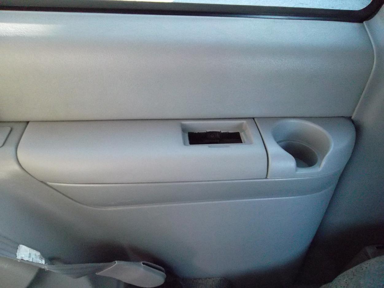

Put my new rear armrest in.... Still gotta paint the ashtray.

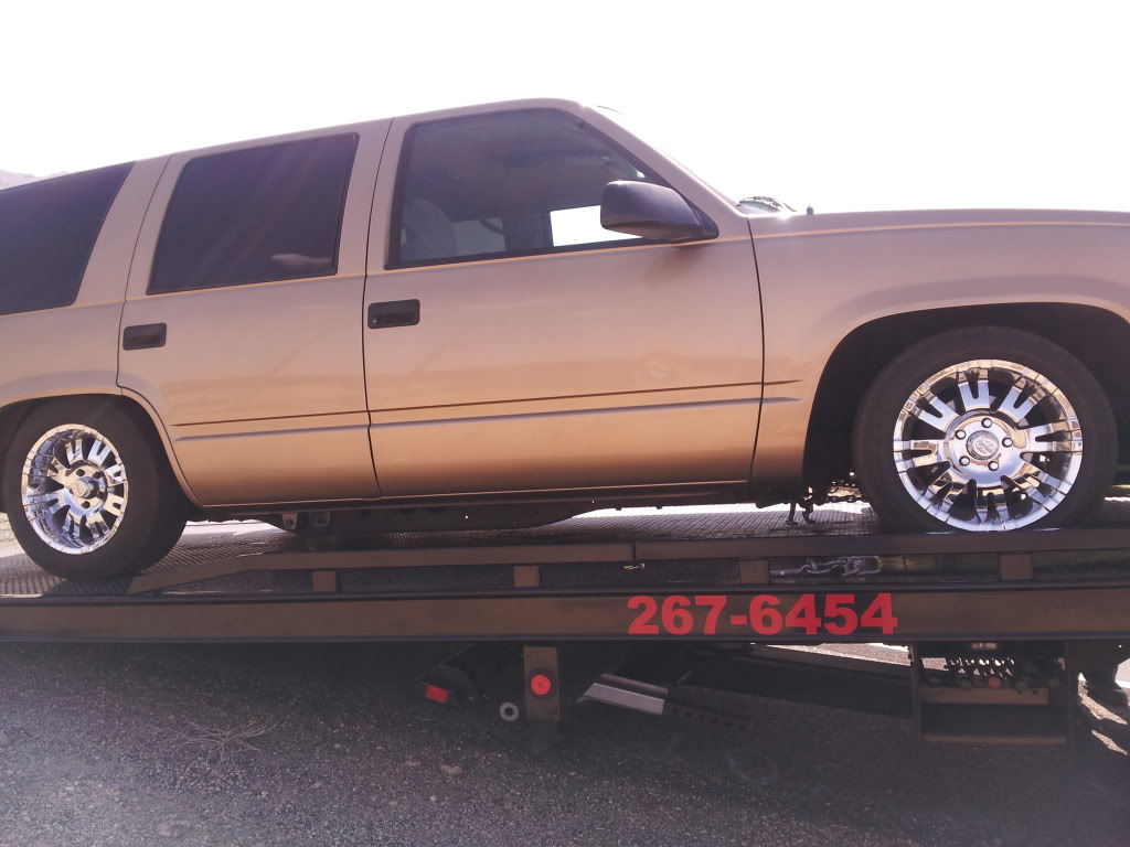

Coasted it to the side of the freeway while it died. Currently sitting in it waiting for a tow.

tow truck pics? :lol:
haha ^ been there
Just Tuesday :eek:
