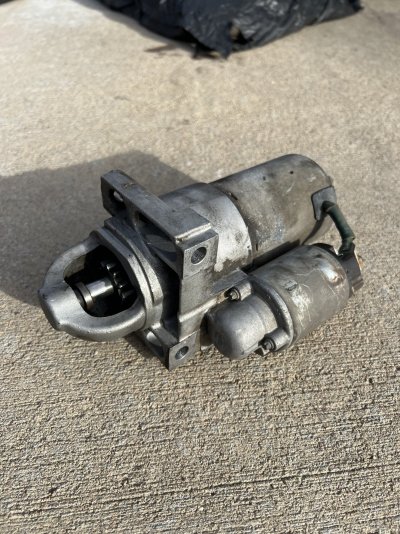

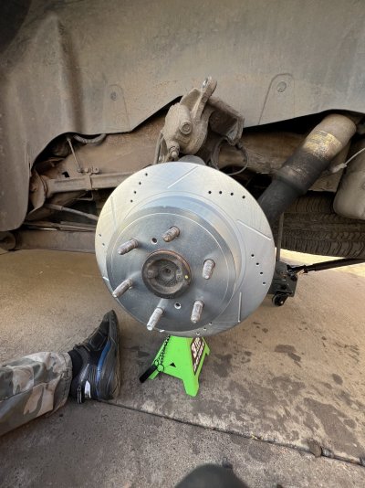

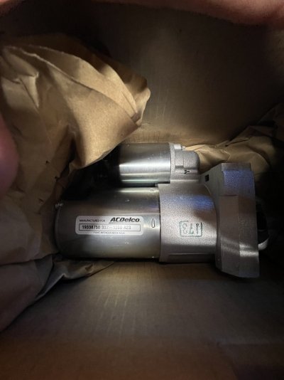

I knocked out several projects in the past few days on my 2009 Yukon XL Denali.
- Replaced passenger side CV axle
- Replaced rear brake rotors and pads (PowerStop Z23 rotors with ceramic pads)
- Replaced starter

The beast is running real good! Going up to Grand Lake for Christmas this weekend with the family and I'll probably hit 150k on the odometer while I'm up there! Currently at 149,500!
