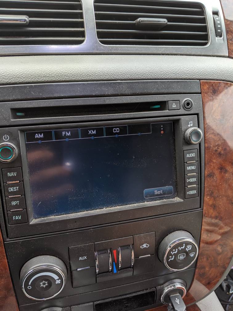

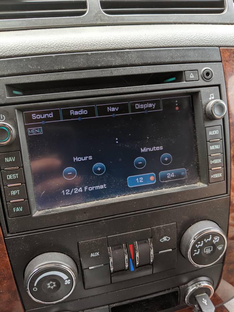

I can press any button on there and nothing happens.So after I put in the new battery, obviously the clock reset. Now I can't get the clock to put a time in. Anyone ever have this problem?
Maybe pull the neg batt terminal for a few minutes, reconnect it and try again.I can press any button on there and nothing happens.![]()
I've read about this problem on this forum in the past, I know there's a post about it.I can press any button on there and nothing happens.![]()
Try this workaround.I can press any button on there and nothing happens.![]()

Yes! I actually haven't been able to put the time in for about a month now. Really annoying.So after I put in the new battery, obviously the clock reset. Now I can't get the clock to put a time in. Anyone ever have this problem?
What if you go into the secret menu on the Nav screen?
Check out the pdf in this post...

Thanks gents, I'll try this when I get home at 6 this morningTry this workaround.

Worked! Thanks gents. @07Burb @NathanJax is it possible to make this a sticky in the gmt 900 threads?Thanks gents, I'll try this when I get home at 6 this morning
