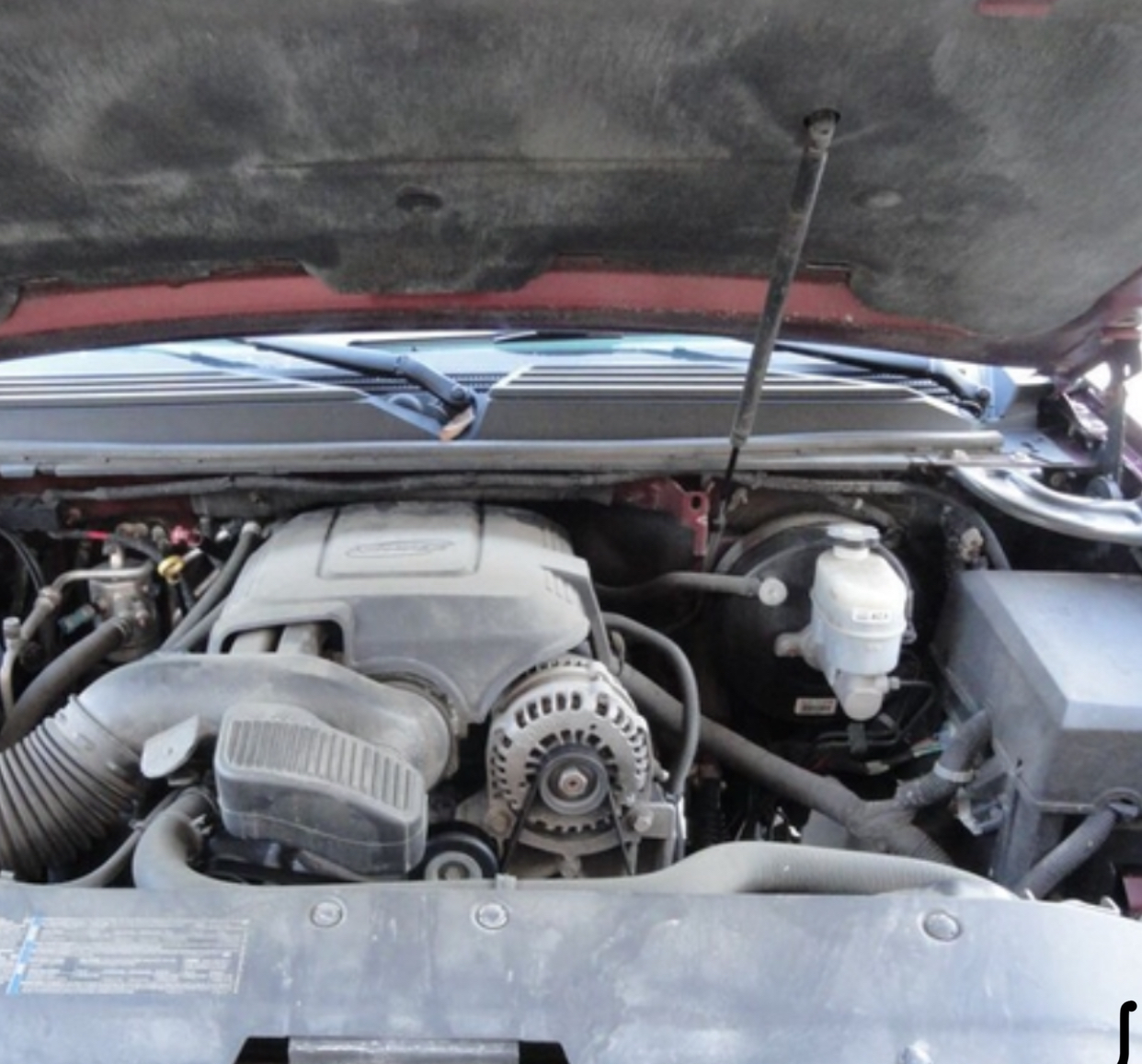

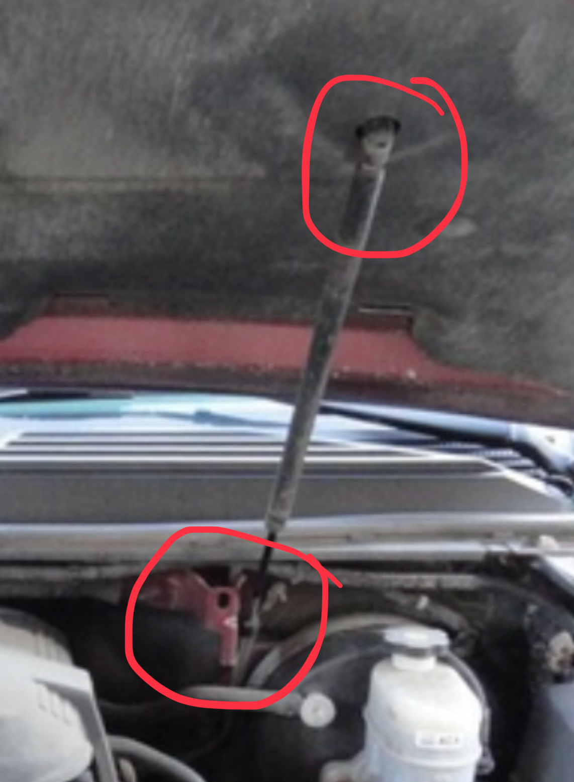

Yes, there is a nub on the hood and a nub on a bracket on tge firewall
No pic tho
And for some reason i feel likevthe pickups didn’t have it
For some reason there is no bracket on the firewall neat the engine ground on pickups....iirc
just the gas cylinder as far as I know, I think mine was shot when I bought the truck as well, you will see the little ball to connect it to under the hood if so
So there’s no springs on the hinges like on the NBS?

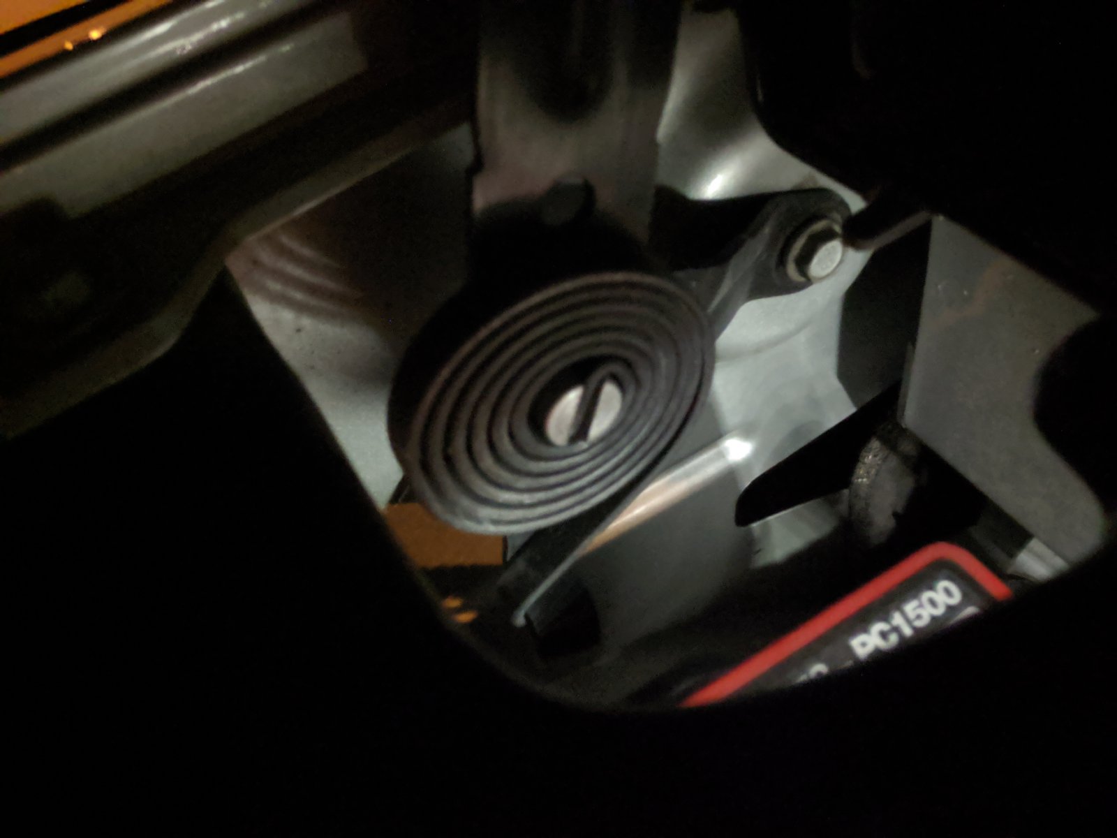

Plus hinge springs
YES
45,012
Aha, thought there must be springs. It’s weird though, gm parts show brackets for the strut on the pickups but no strut. Anyway, it won’t help for my truck since there’s no room for the springs and that strut has no chance without them.
Any room for two struts- one on each side?
I used struts from an F-body with mounts from a 2000ish Buick Century to lift and support the hood on my S10. I'd pop it then pick it up about 7" and the struts would lift it the rest of the way with strength to spare. I don't know how much heavier, if any, your hood would be than an F-body. But maybe you could use two GMT900 struts?
