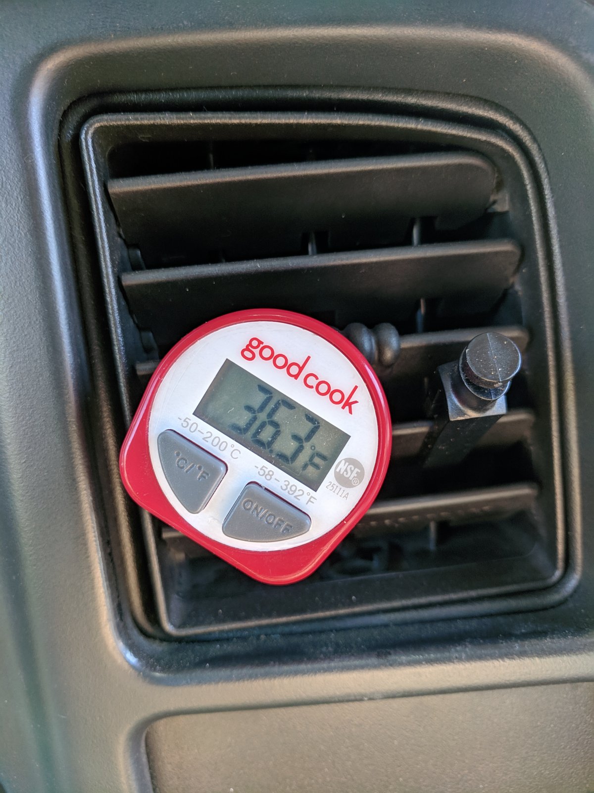

Does anyone have a probe thermometer and can check the ac temperature coming out of the vent when cranked down to 60, im trying to see if need a ac service or if I'm crazy but seems like it should be about 34/35 in the vent slot mine will only go down to 46

lol, maybe you need a recharge too, the temps here are only hitting the high 80's so far and It just seems like it is not working as well as it did last summer when it was much hotter, I checked my silverado and it goes down to 36 and I just turned it on for a few minutes the yukon had been going for a while already
