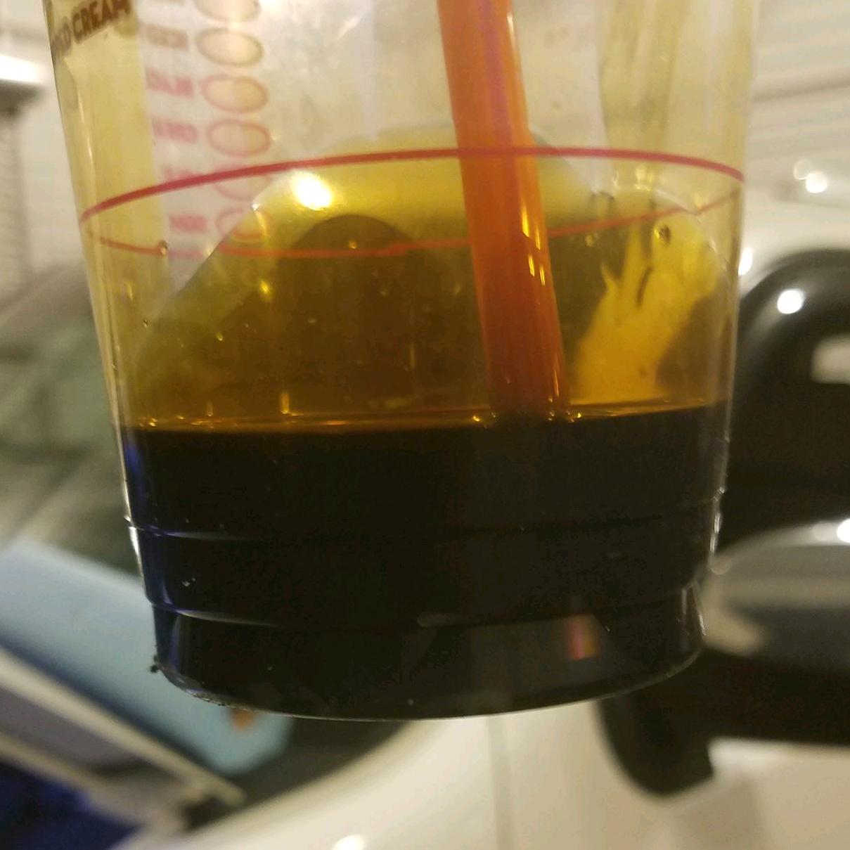

2500 miles since installing. Catch can is doing a great job of making coffee/chocolate milk. :waytogo:

I'd say my driving is a mix, swaying more towards highway. The 2500 miles since putting the catch can on is compiled of mostly Mon-Fri work commute, 50-60 miles round trip, 95% interstate, and this past weekend about an 800-900 mile round trip road trip.
Do you drain yours hot or cold? Something I've noticed on past vehicles and now this time is if I drained the catch can within 30 or so mins of shutting the engine off, the result was always milky. But after the drainage sat for a while in the bottle and cooled it would get measurable darker. And then if I didn't drain it hot, but waited to drain until the engine was cool, what came out of the can was darker.
Either way, no matter what color stuff comes out, it isn't making it's way into the engine so that's a plus.

I usually drain it last, after the oil has been changed. My oil change probably takes a little longer than most since I have 2 big oil filters and holds about 9 quarts... about 8 get changed the other quart stays in the oil cooler and associated lines. So maybe that has something to do with it.
Have you ever looked at the milky oil after it sits for a while???
I wonder if what I am interpreting as moisture is actually just aerated oil.
Yes, that's what I was talking about when I said that after the drainage sits for a while in the bottle it gets noticeably darker.

Side, side, side note. I noticed that the drainage from my catch can has more of a fuel'ish smell to it than I expected. Not sure that means anything. Just an observation.

The smell is pretty normal due to blowby from the piston rings allowing a small amount of combustion past.
You could send a used oil sample to Blackstone and have them analyze it if you are concerned about it. They can tell you how many PPM of fuel is in your oil.
