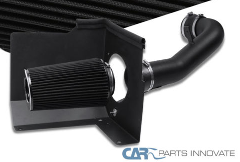

You can clearly see here how high the factory tube joins the factory airbox, and at a small downward angle.
Verses those generic eBay kits...
Completely different height and angle make me pretty sure you couldn't just use the tube from one of the generic kits and have it work with the factory airbox.
If the eBay tube is cheap enough that an extra coupling and clamps is in the budget, or if you already had the tube and wanted to attach it to the stock filter box (to not have a HOT air intake) you could cut it where that bend is downstream of the MAF, rotate it 180°, and couple it back together. After this, rotating the rest of the tube on the throttle body upward would probably put that other end at just about the right angle to hit the factory filter box. You could always shave the cut part to get the angle spot-on.
I guess if you the angle perfect, you could epoxy it together then Plasti-Dip, rubber undercoat or sand and paint the whole thing to make it a one-piece tube.
That sounds like a lot more work than the $38 worth of PVC elbows and pipe I'm snagging from Home Depot tomorrow. :p
Yup. This is what I was thinking too.
