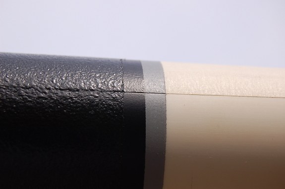

If I didn't already have my MIT, I'd be making that this weekend and would rock it with pride. I'd sand off the excess molding and embossed lettering and use matte or satin black and a black fuel-rated hose for the vent tube, though.

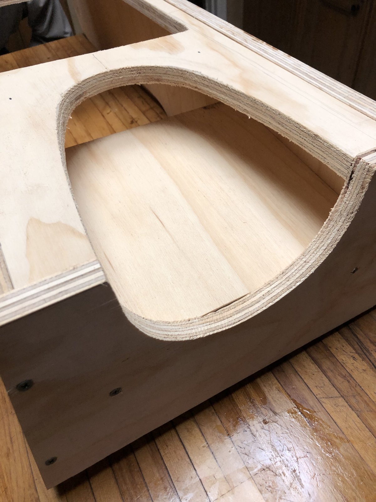

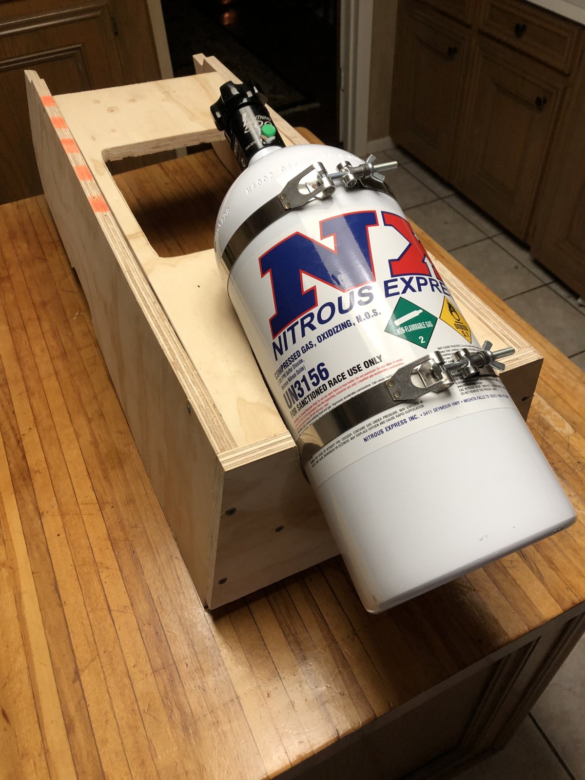

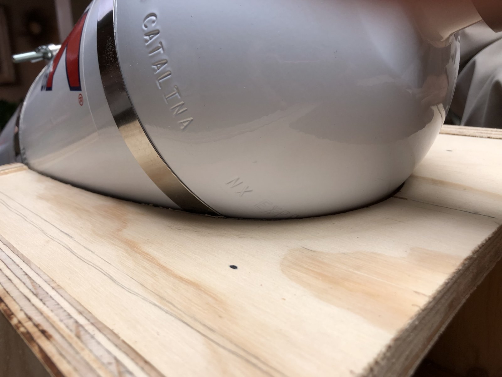

I had some more time to work on the console today. Really pleased with how the bottle fits. It’s sitting on the brackets in these photos...not touching the top or back panel. Still going to use dowels and glue it together and take a router to all edges. I’ll clean up the hole for the tray and a few other areas. Also picked up some nice vinyl.
View attachment 217108 View attachment 217109 View attachment 217110 View attachment 217111
Looking good!
More ambitious than I would be. I'd just mount the bottle in the cargo area and wire up a remote bottle opener to a switch mounted in the console.

Thanks! If it’s worth doing... it’s worth overdoing??... I considering mounting it in the cargo area, but I think I’d constantly be checking the valve anyways. Decided I wanted to open and close it by hand.

Dat tight gap, doe.
I'd like to see this vinyl you got. I'll be needing some eventually and I want it to have the same grain and color as the factory stuff.
Details make em great. Spent alotta time on that gap. I’ll post a pic of the vinyl. Looks pretty good. Seems tough as well. Going to put a pad under everything to make it a bit softer and smooth out any imperfections
Yep. The factory intercooler pipes on my F250 have this crappy foil type insulation glued to them for sound deadening. It's both ugly and starts falling apart with age so years ago I stripped the pipes completely then sprayed them with black rubberized bedliner spray. Turned out great. I'm kind of thinking the same for this. Once I get it made and glued, scuff it up, then hit it with some of that rubberized spray. Not only does it give it an outside texture as opposed to just smooth piping, but also protects it a bit from scratches/nicks any time you have to remove it or work on/around it.
That said, this was years ago before PlastiDip hit the scene. That could be another cool option especially since you have so many colors and textures available with it.

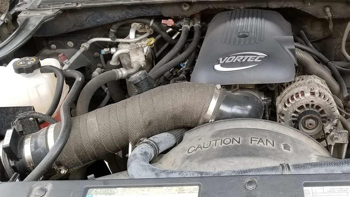

You could wrap it with some header wrap too. I did that with a Spectre Intake on my 00 Tahoe.
