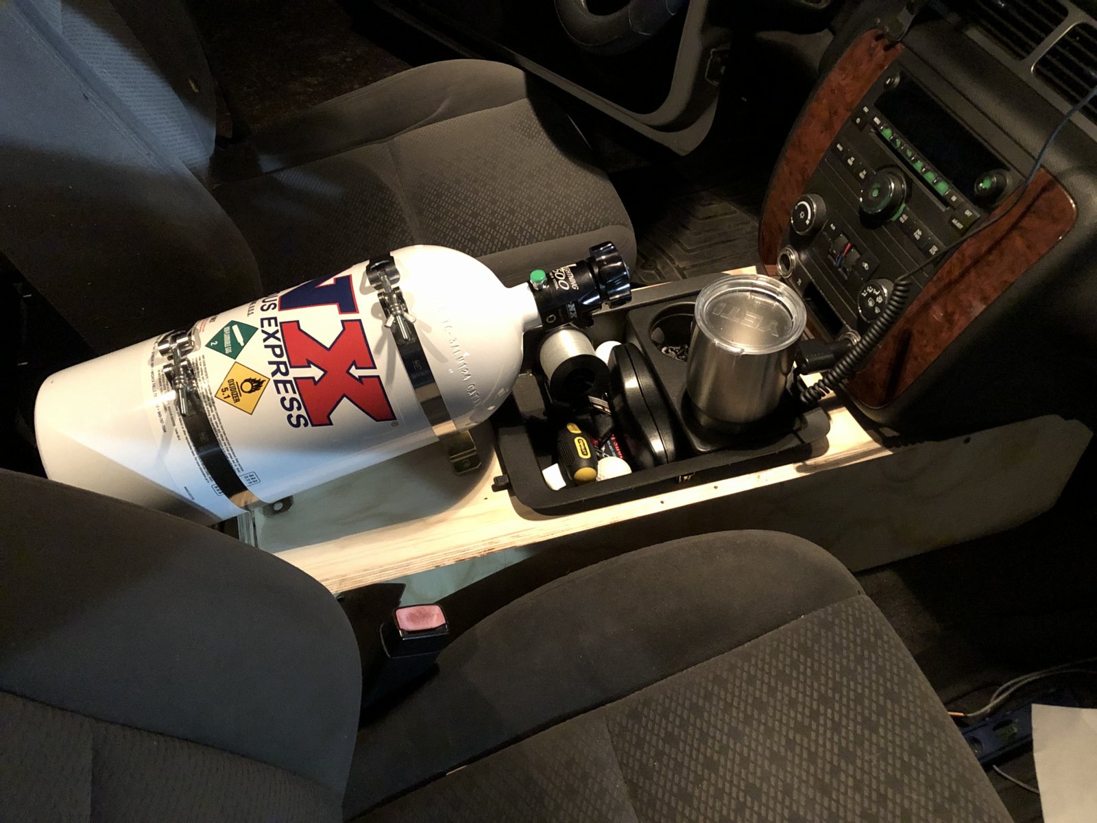

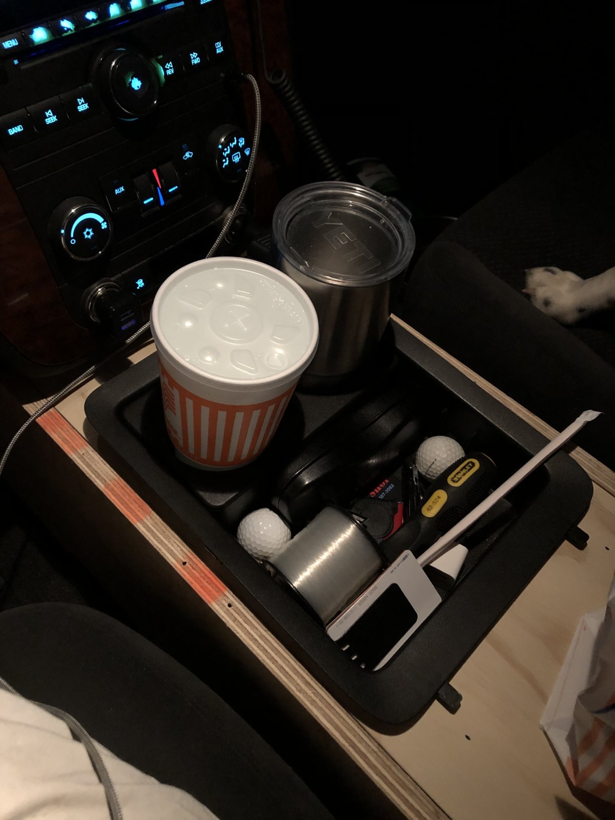

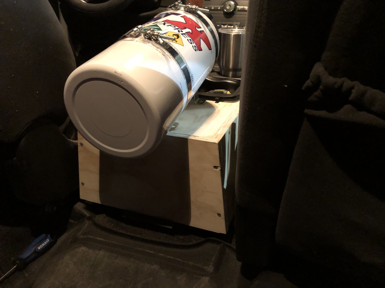

Far from finished, but this gives you a pretty good idea... the tank will be dropped down as low as possible and it’ll be sitting on a shelf. You won’t be able to see the brackets installed. Should tuck in there nicely. I’m going to put a nice radius on all edges and cover with stock looking black vinyl. Flipped the stock tray with cup holder around, and you can still fit a large yeti and whataburger cup with the radar detector plugged in. I still need to dremel off the tabs around the tray. Very happy so far!

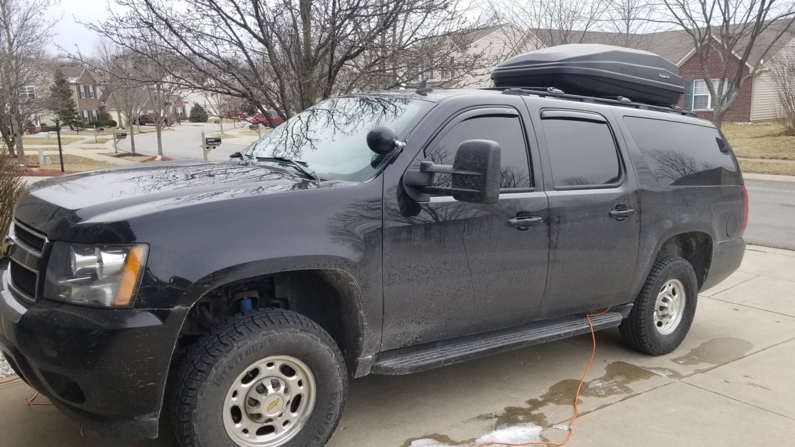

Well today I finally got off my winter deadass and got my cargo carrier mounted.
This bad boy retails for 250, and its the Pepboys brand but theres a funny story behind this craigslist purchase. The guy didnt have the keys for it, so he drilled out the rivets from the lock to get inside it. In addition, he didn't have the mounts for it either. He wanted 100 bucks for it, but I offered 50 to which he accepted. About 5 minutes of online research and credit to etrailer.com (they're the best!) and I found these cases were made by Thule. Annnnnd you can order new keys from etrailer for 5 bucks a pop. So, I got the keys sent to me, re-riveted the lock back on, and bam good to go.
Last was to figure out a method of attaching it to the luggage rack. I thought maybe some flat iron would be simple enough but that would bend too easily...so I went with perforated angle iron. Spray painted black to match, I have 8 matching pieces, one for each side of the luggage rack cross member, and bam its totally good to go now. Going to roll around with it on for a few days to make sure it doesnt loosen or anything like that.

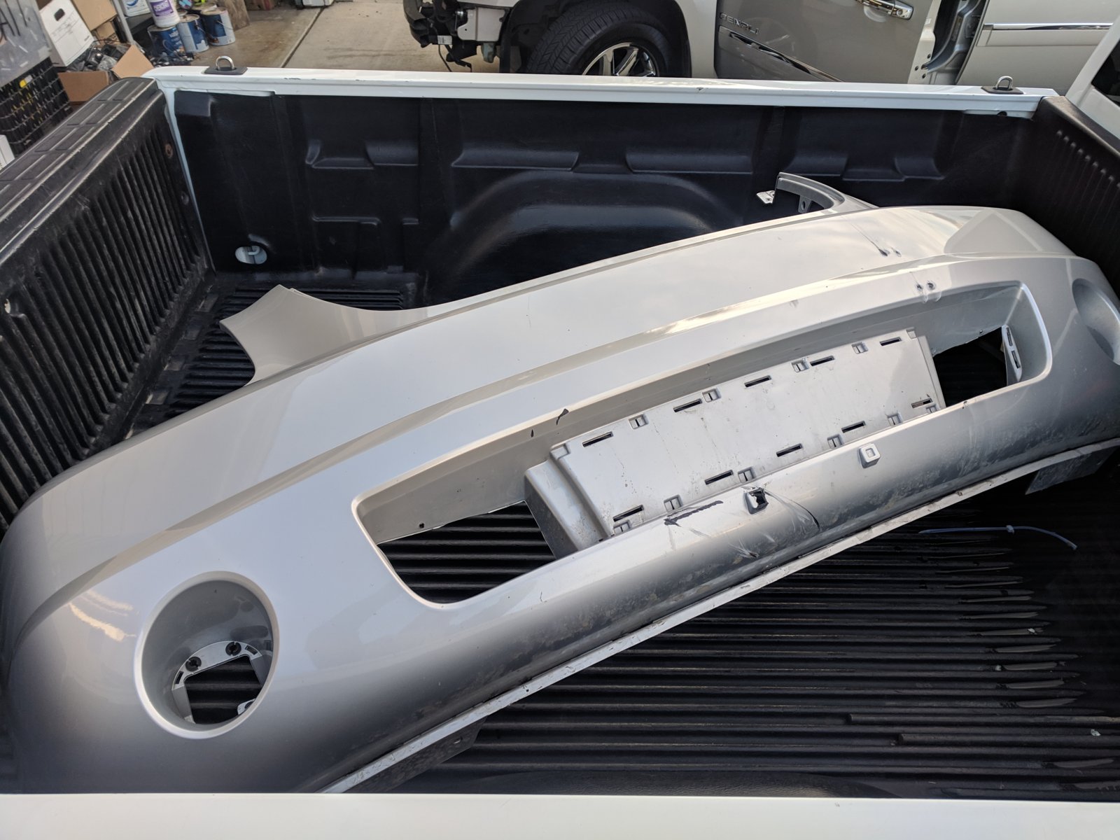

Disassembled the front bumper cover to go get painted, took about 35 minutes to get it off and completely apart, didn't know the bottom chrome grill was one piece it looks like two but it's not really until you get it off the cover.

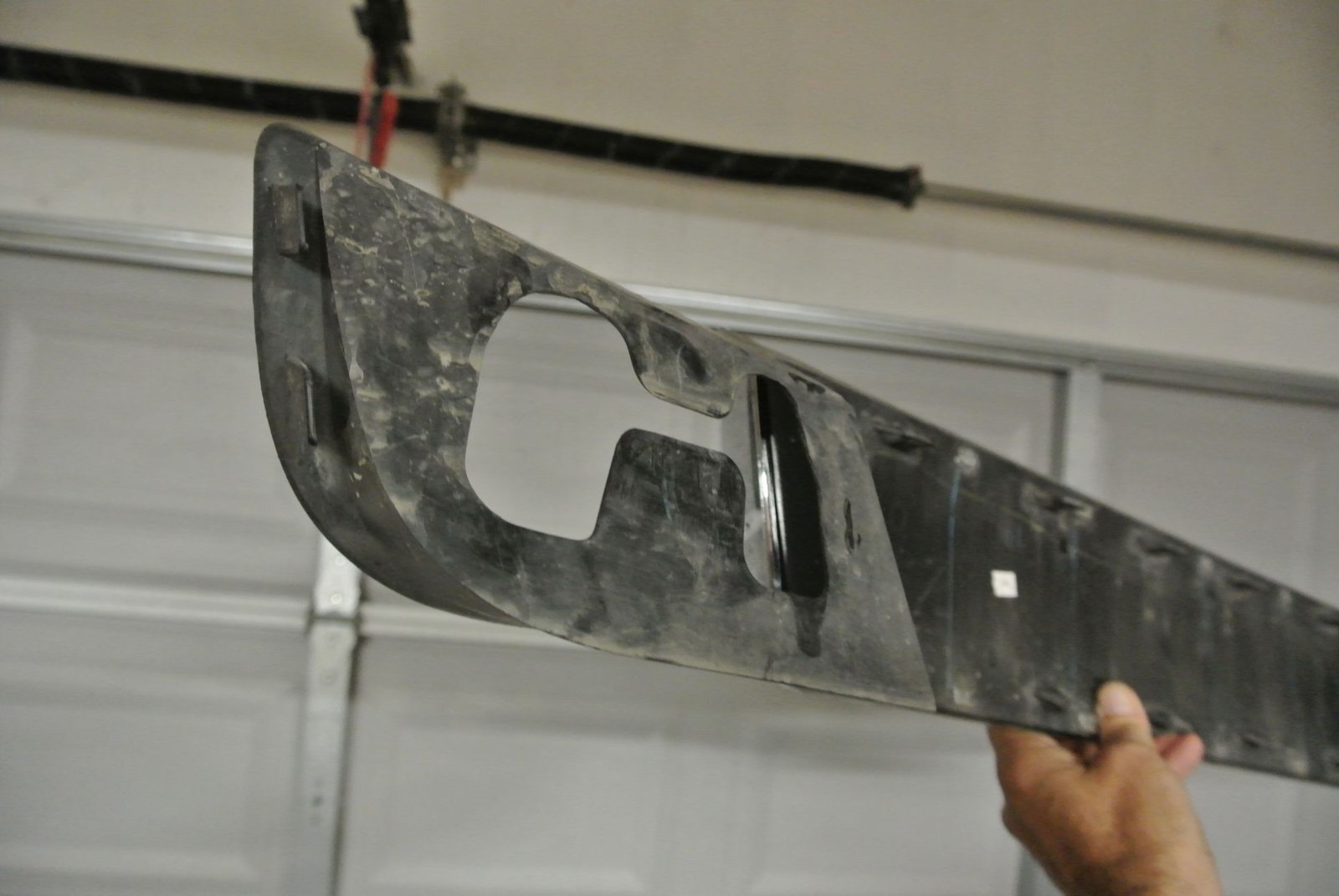

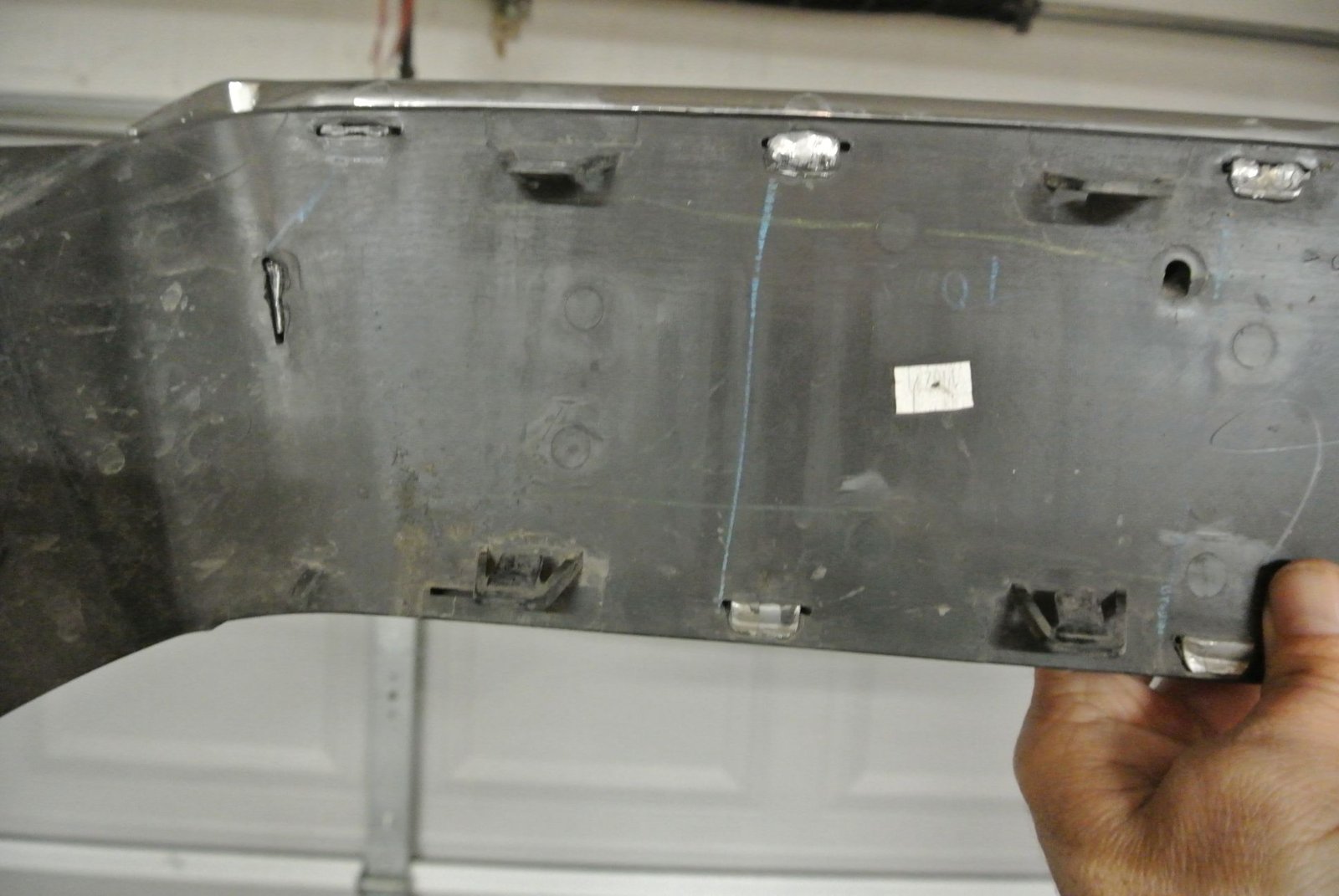

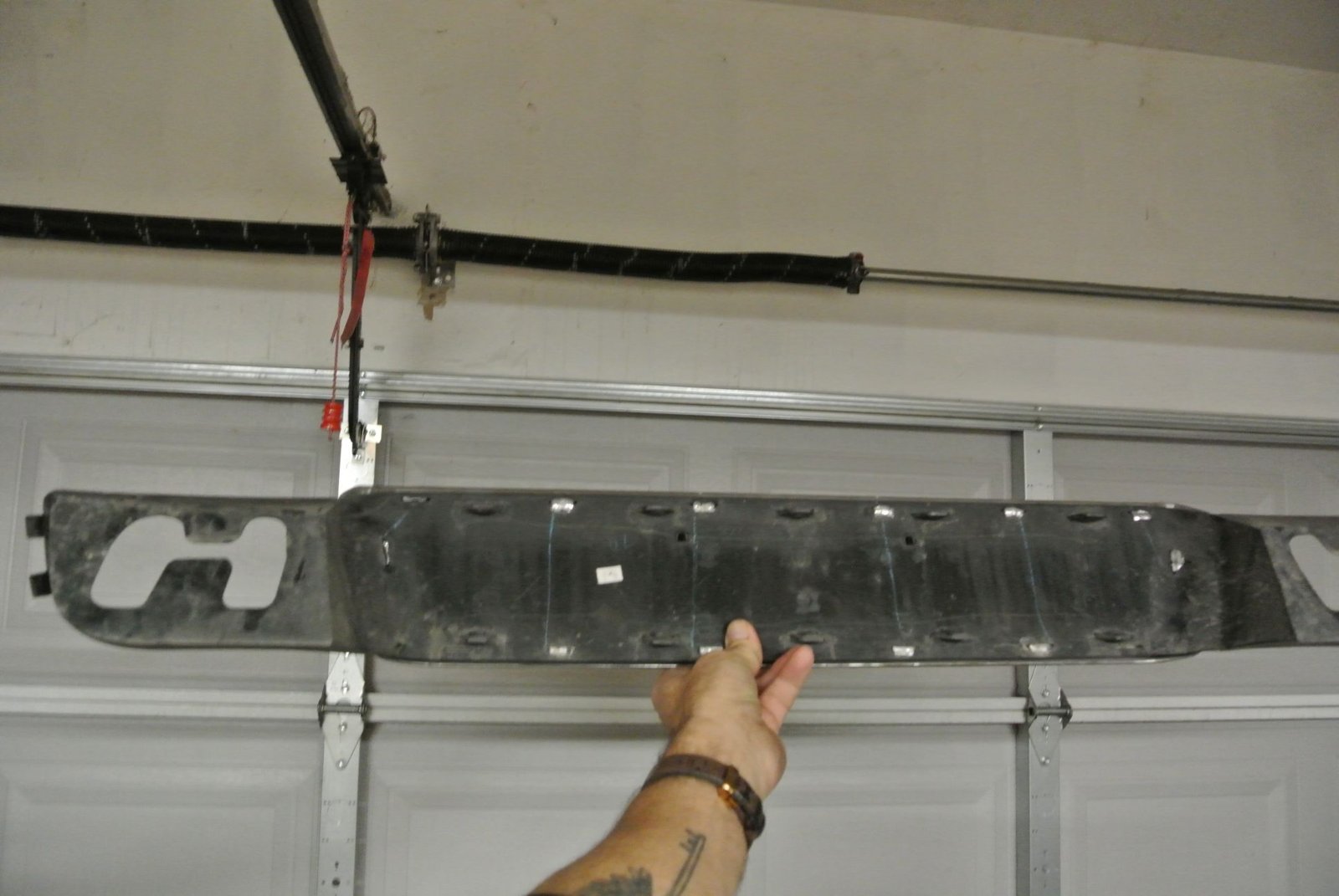

Does that lower chrome grill only attach to those 2" horizontal slots?
Mine has chrome peeling off and I either want to get it re-chromed or replaced and wondered what all is involved to remove it.

the bottom grill is one piece consisting of the chrome part and the black plastic around it that also goes around the the tow hooks, so you have to pull out the black plastic tabs on the black plastic part and then there is clips on the back and also on the outside edges of the black plastic, I almost broke it taking it apart until I realized it was just one piece
