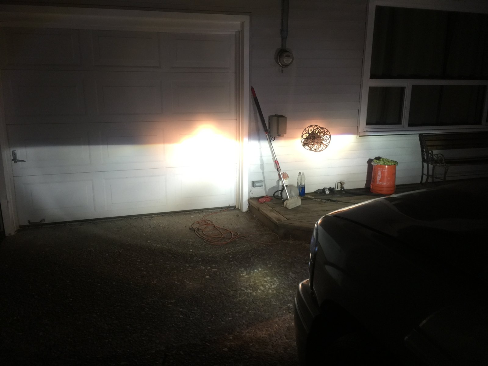

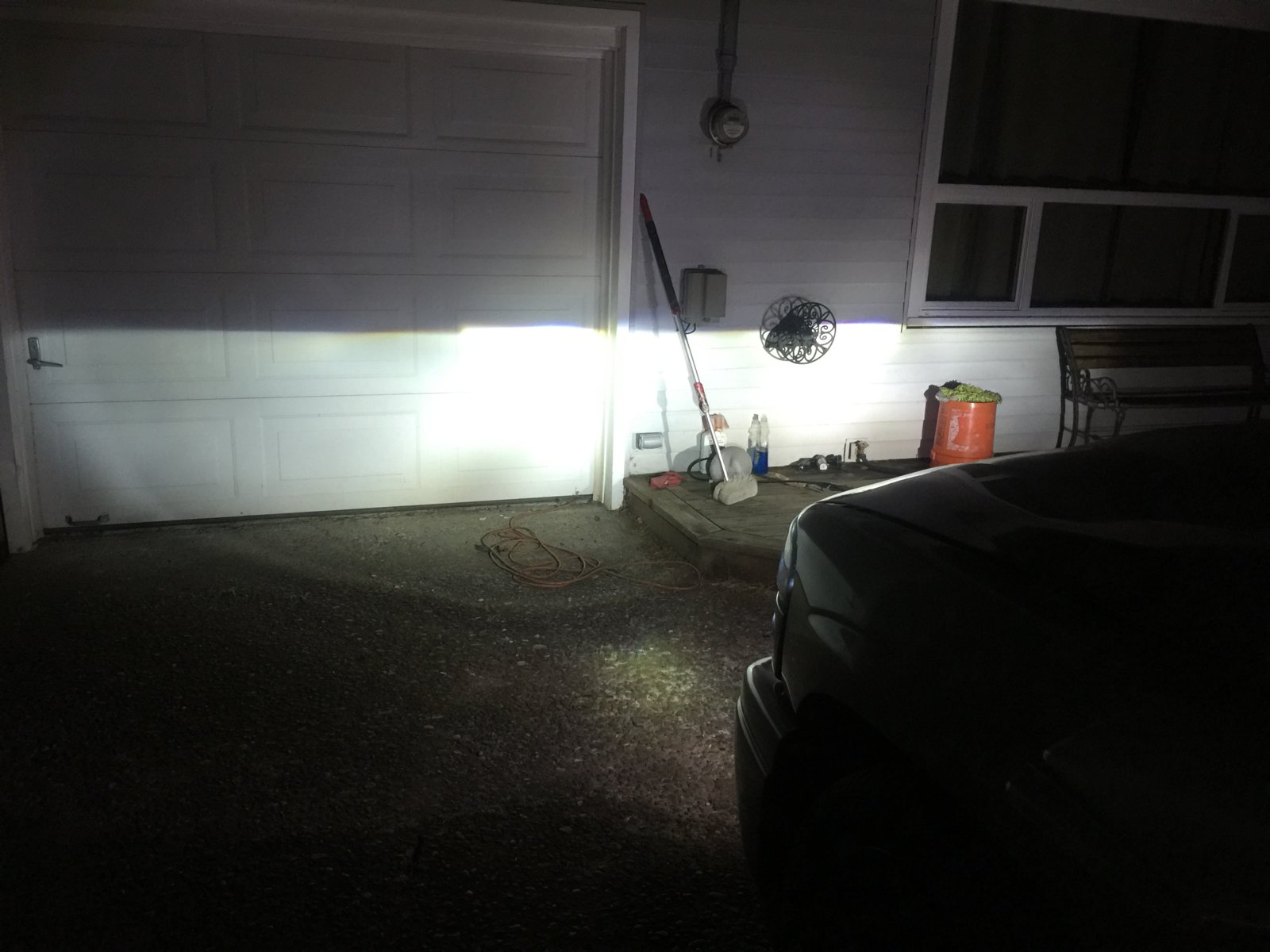

I have been pondering getting these but wasn't sure it would make a noticeable difference over the 9005's....
What say you, oh wise one???
HIR are way brighter than anything except probably retrofit HID projectors. I haven't seen those so I wouldn't know. But HIR's are really really bright. But if colormatching your high beams is important then it's a no go. They are their own different color.
The 9005's are the stock high beam bulb.
I knew the HIR wouldn't match my 6-6500K LEDs but I didn't think about it having a different color than the stock bulb... huh?
Got a pic???
52,949
Got a pic???
They might be close to a halogen, I’m not sure. Just not close to my 6000k HID. I don't care though since I rarely need them but when I do they sure do their job. Sorry for no shot of them shining down the road but it's 3 AM and if I start The Beast now I'll wake the neighbors. It's a loud ass thing lol.

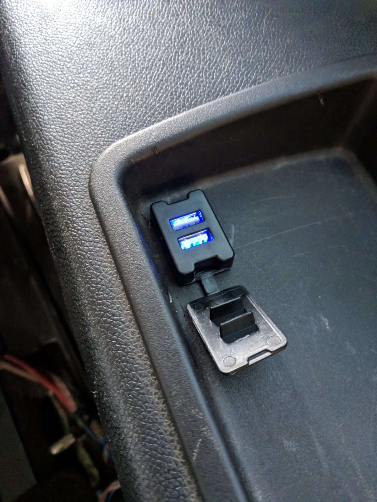

Added a couple USB ports for the 3rd row, cleaned out the rear cup holders, these kids put gum, ice cream, melted chocolate you name in these things
Cool! Where did you tap into power? My daughter has just been using a long (10') usb cable plugged into the ports I put in on the back of the center console. I thought about installing some on both sides in the area below the middle row flip/fold button just in front of the 3rd row seats, but wasn't sure where to get power from.
2001 Yukon SLT
2012 Yukon XL Denali
2011 Yukon Denali RIP 5/20/18
Sent from my SM-G930V using Tapatalk
I put it on the passenger side in the shallow cubby behind the cup holder and tapped into the rear cigarette power port only took me 6 months to actually do it, you could add one to the drivers side as well by either tapping into the lift gate harness somewhere if you have the lift gate or just run a wire under the carpet from the passenger side rear cigarette port
