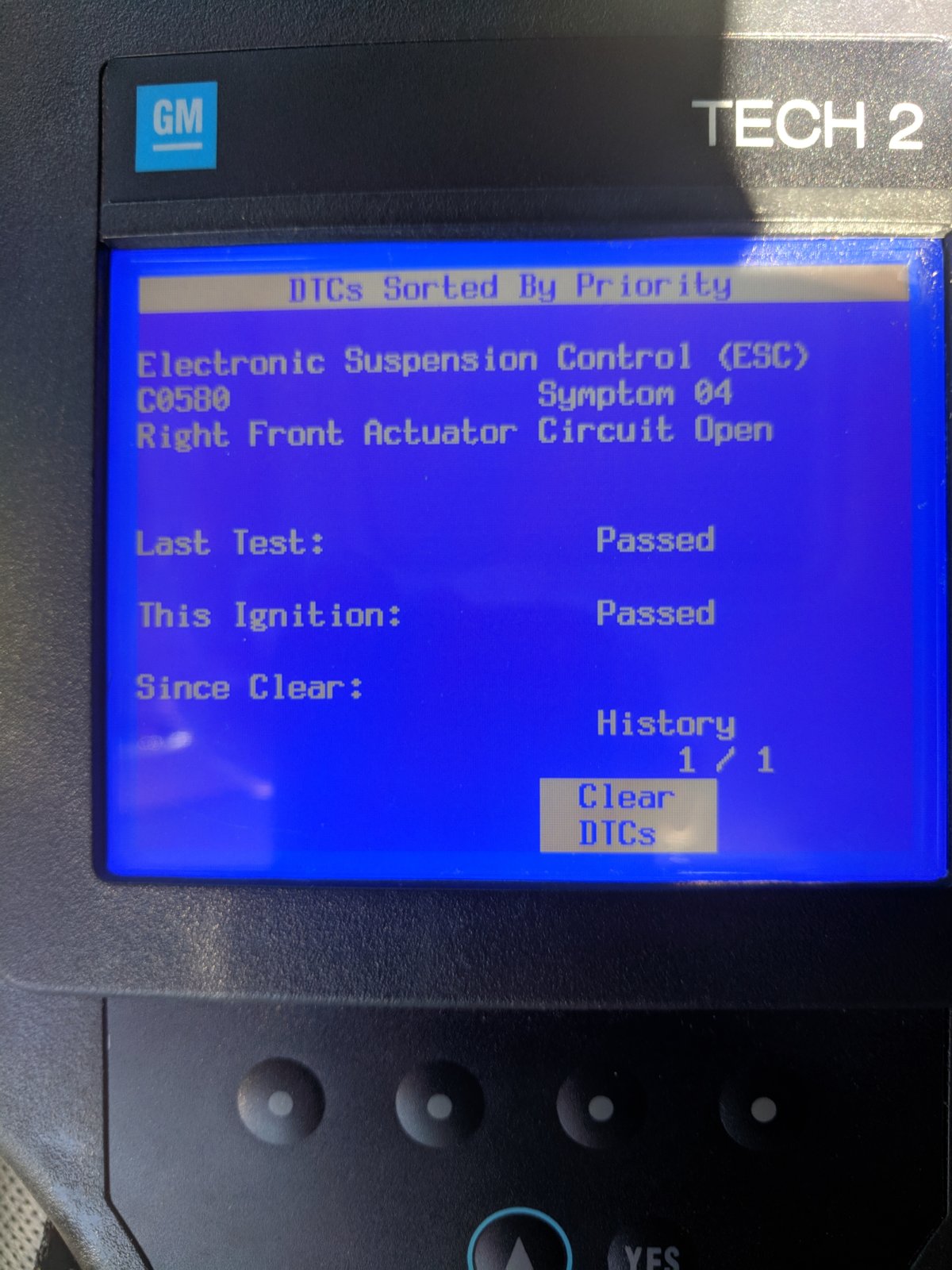

got my tech2 today, hooked it up played with it a little, after replacing the air shock pump and then driving about 500 miles everything was fine but then last Thursday the service suspension light kept going on/off so turns out it's saying the right front shock circuit is open, went and checked the connector and it seemed a little loose it came off rather easily, looks like the clip on the blue connector is a little funky so I put it back on nice snug "till it clicked" so I guess I will see if it stays off I am going to buy a new connector.
