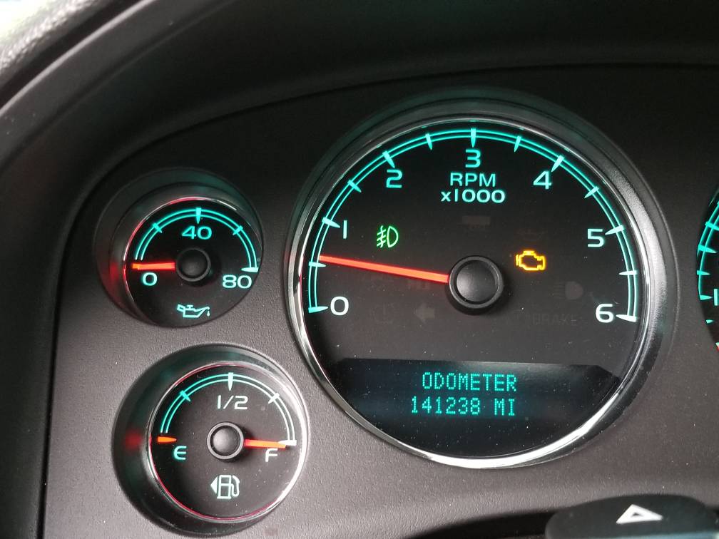

Saw the CEL, checked it then saw the oil pressure not reading.

Bummer. Hope it's an easy fix. Maybe sending unit?
Edit: that code relates to a bad battery, alternator, or power or ground cable.

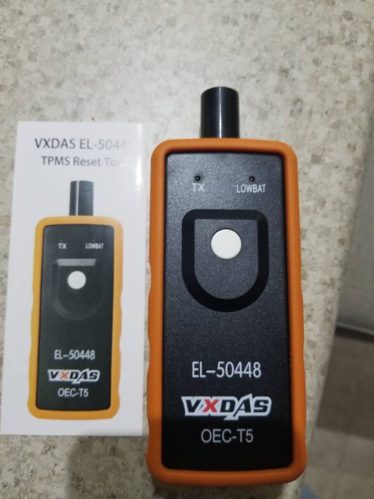

This is a $16 Godsend. No more tire pressure light. And no more wrong readings after tire rotations!

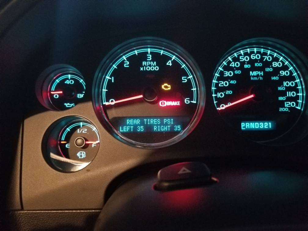

With a Tech2, you can change the tire pressure setting for alerts, if the tire falls below 10 psi of the setting it will let you know via the DIC and the light. It also let's you tell it what kind of tire you're running, but I have no idea how that information is used. Would love to know though!
I'm still doing my 09 the old fashioned way, get it into learn mode and letting air out of the tire till the horn chirps, haha
Yep, simpler but then you have to air them up and even them out afterwards! We can do it their way via Tech2 and that tool as well.

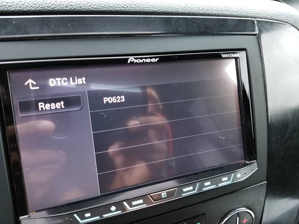

Saw the CEL, checked it then saw the oil pressure not reading. (P0623)
GMT900s don't have that code. If you have another code reader or scan tool see if it pulls up something else.

I thinking sending unit.
And I think its suppose to be 0523. This isnt the 1st time the idatalink has given the wrong code being 1 number off.
Going to order a sender and screen today. Going to the beach Friday and I want my oil pressure gauge to work during that drive, lol.

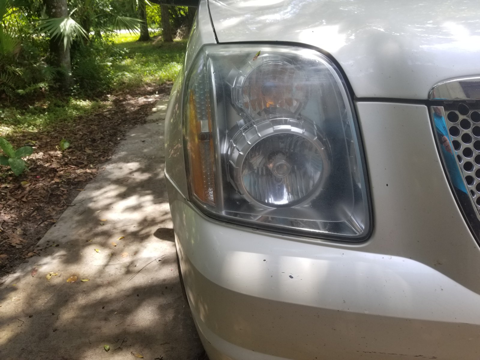

When i have cars come in with lights like that alls we do is wet sand and buff and a good polymer sealer. They definitely dont look like the brand new ones but come out decent. Its worth a shot before spending a good amout for new headlights.
