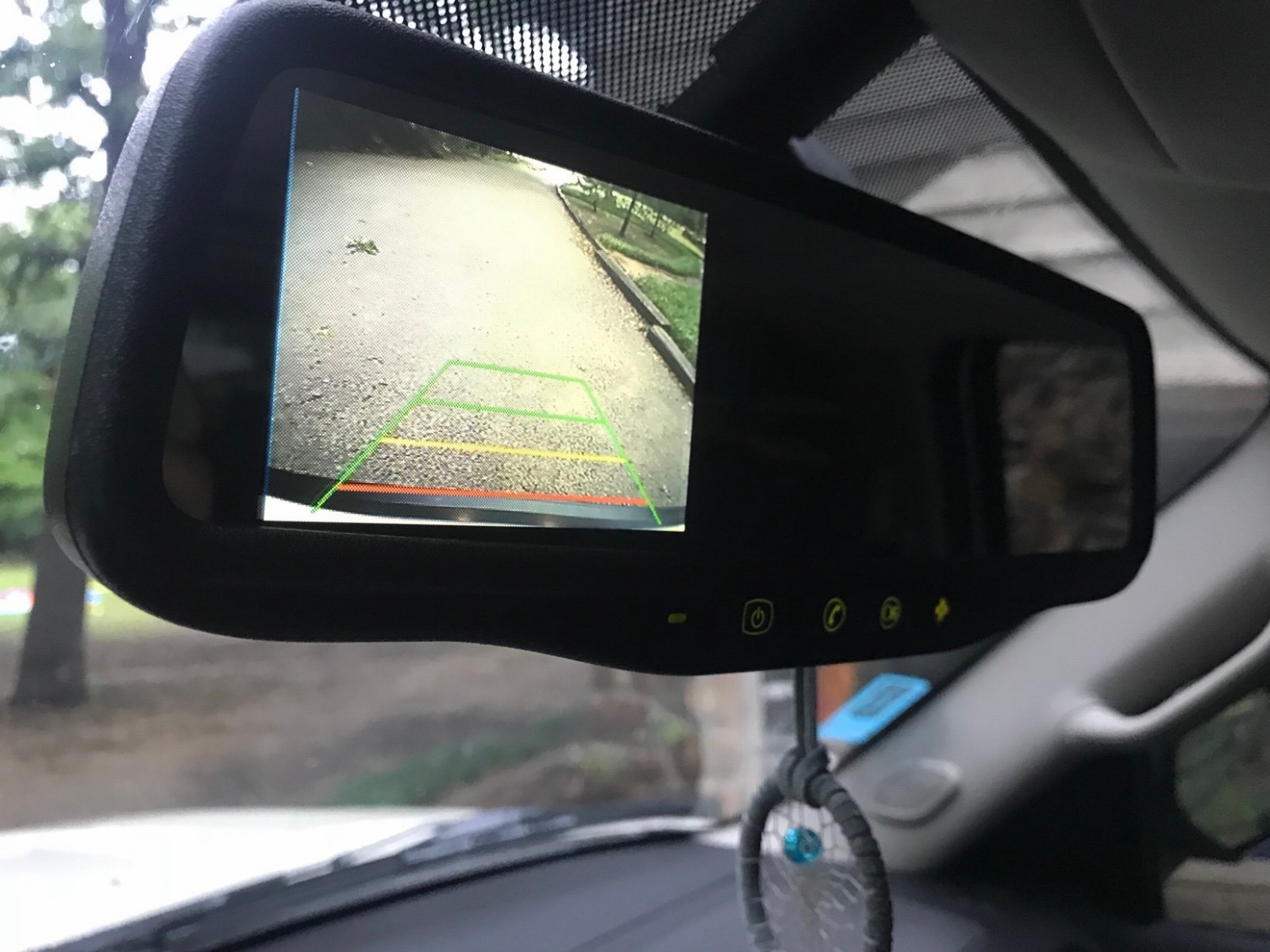

Installed a factory reverse camera mirror.
