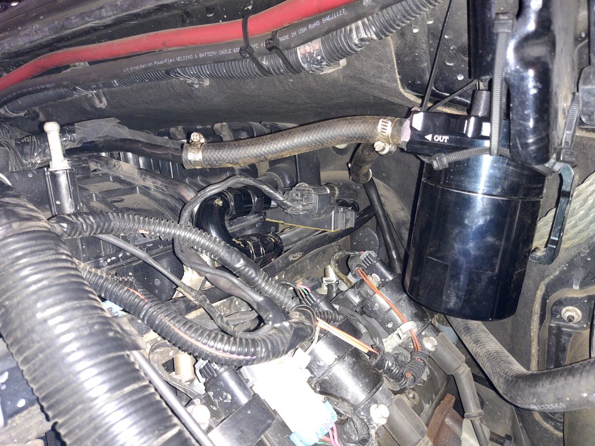

Finally did my oil change and fix my catch can which had kinked lines and was leaking oil back onto the valve cover.
Grab the lighter and heat it up the stock plastic hoses and straightened out some bins so they were aimed where I wanted them to be.
Should be all good to go now.
Cold start, 40 PSI at idle.
Warmed up, 30 PSI.
Got to love fresh oil.
