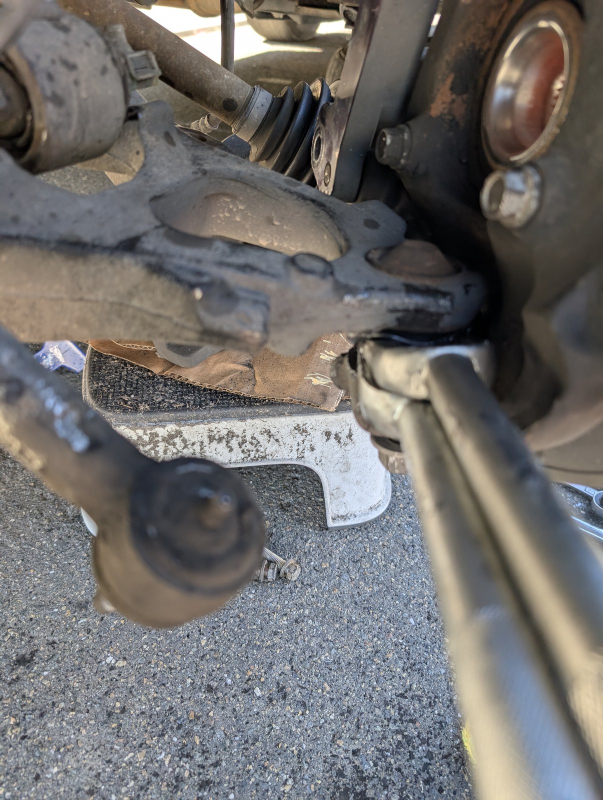

Wedging 2 pickle forks in this mofo does not want to come off!View attachment 451939
When I recently replaced my lower ball joints I noticed the puckle-fork was too wide to fit in there easily. I beat on it with my 4lb. thumb-detector until they popped off, but I bent the heck out of the brand new AutoZone rental fork.
The 2nd ball-joint was worse, bad the fork became stuck...wedged between the ball+joint and knuckle. A hammer worked fine to beat it off, but there must be some special, narrow fork for GM knuckles.
I used a standard size pickle fork and after fighting with the first lower joint apparently there is a metal ring that came loose from the rubber part that holds the grease so I had to use a small screwdriver to lift that up in order to get the pickle fork in otherwise it wouldn't fit, I ran over and bought a 2nd pickle fork because they didn't have the rental ball joint extractor that may or may not have worked anyway, flipped the 2 forks around so it made a thicker fork and just kept pounding them in until it finally popped out.
the single pickle fork was getting stuck yes, but I used another tool that I have to wedge it back out. At one point I thought I might have to go buy a new knuckle, got the torch out and was going to throw some heat at it first when it finally broke loose. I was thrilled the other side came right off i wasn't looking forward to a another fight.
my guess is someone must have torqued the shit out of the drivers side at some point.
I kind of ran into a self induced mistake when tightening down the 1st upper ball joint, as you tighten it up the ball begins to spin so you have use a allen wrench in the center to hold it while tighten up it, I thought to myself "this is going to get wedged in there" but kept tightening it up and yep it got wedged in there so i had to hacksaw it out, the good thing is it made a new tool to use on the other side lol
and I have the same a 4lb thors hammer, just enough room to swing it somewhat hard and not smack the body in the process
when I was looking for the torque specs in the service manual there is a j-*** tool the manual references to use
j 43631 for the lower w/sleeve adapters j 45851, and for the upper j 42188-b
but not spending $500 for specialty tools that I might only use once or twice
most mechanics just put some tension on the arm and smack the part with the cone shaped hole with a hammer. it deflects the hole and the pop right out without damaging the boot. I was skeptical but back in the days of working in a mustang shop, we dropped the k members out to do install headers, all the time. needing to pop the lower ball joints loose but not something you want to damage in new cars with a fork. after seeing it done once. I got a bigger hammer off the tool truck. one or 2 good wacks and they pop. right apart without hurting anything.
I haven't replaced the ball joints on my truck, but that's how I'd try it if you can get a clean swing.
we have a set of forks that go in a air hammer as shop tooling here. most of our stuff has king pins so I've never used them thou.
