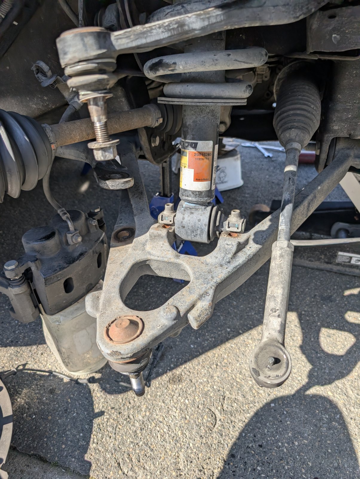

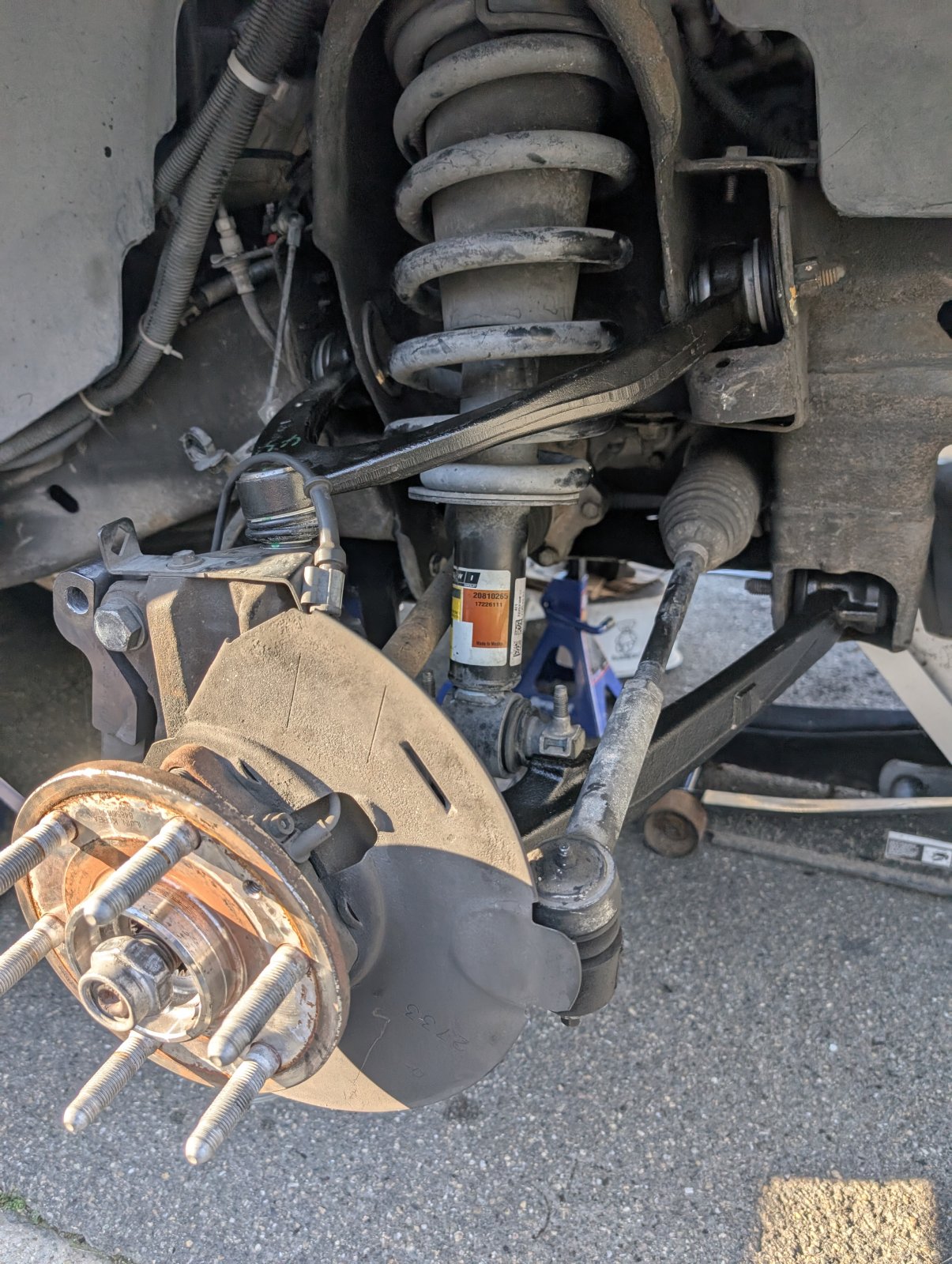

The Yukon took me all day but got done what I wanted too basically. 180k front end refresh, still need to do tie rods (I have them sitting here) but I'll just have that done at the shop and get the alignment done at the same time. New front shocks for the struts are around $650 for the pair so that's going to have to wait. Drove it around the block a couple times still goes straight and no errors popped up.
AWD made it a little extra work but not bad
Saved myself $1000 in labor or something around there
