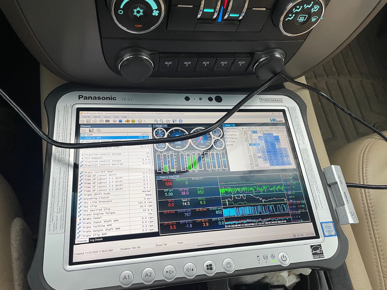

tested my new (used) tablet from ebay. dont have to use gf's big laptop with floppy screen anymore!

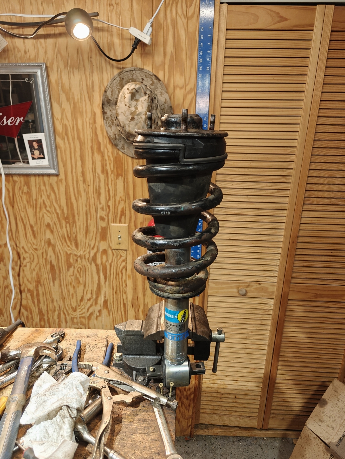

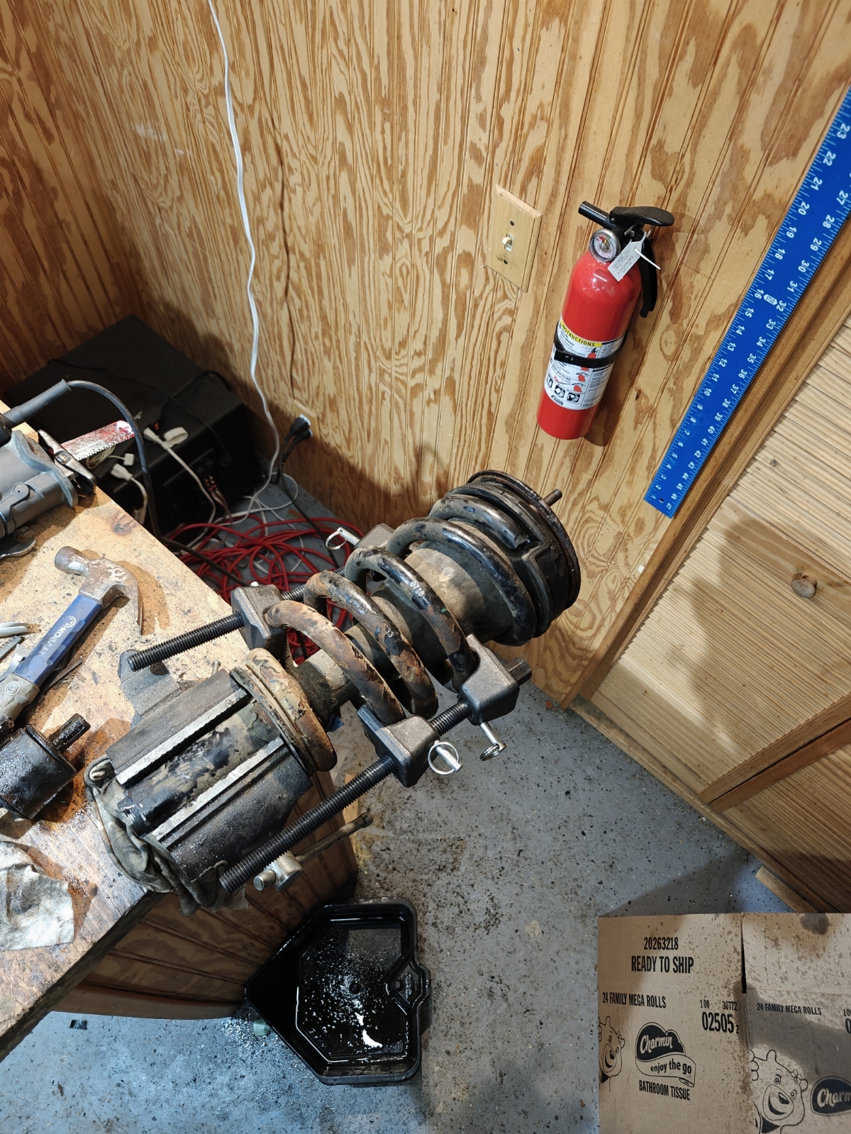

Got to play as an EOD tech. today. Happy to report I didn't blow a hole through my face.
Swapped in some 5100s in the front, but as usual the old nuts/threads were rusty/crusty. Everything was a fight, but I figured out an easy way to get the old shocks apart. Just use a sawzall and cutting disc. I was already cutting the old shocks apart to reuse the spring perch, when the 2nd shock top but wouldn't come off I just cut piston in half.
1st shock came apart without cutting, but what a terrible design having the nut on top of the piston recessed down inside the top of the strut mount.
Old spring perch welded ....FUUUUUUUUUU
1st bomb reassembled.
2nd bomb: Top nut was rusted too much to get off, so I started chopping it up to drain the fluid.
Said "F that" and just zipped the bottom off.
Had to preserve the top strut mount, but the nut was welded with rust, so I cut the piston, ground some flats so it would hold in my tiny crappy vise, and just twisted the nut until the piston shaft sheared off. (Semi-diffused bomb on the floor, awaiting reinstallation.)
Time for more zipping.
Spring perch separated from shock body.
Bomb #2 reassembled.
And...installed. It was raining outside so that made everything 10x more fun.
Also swapped on my winter wheels/tires. I'll have to check how the car sits in the daylight. I set the 5100s to their highest setting.
