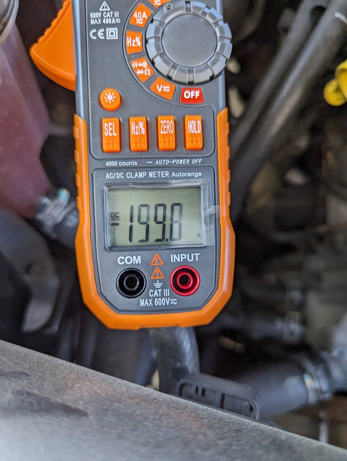

Had my kid hold it at 3000rpm
Hangs around 170-180 a lot but got a couple bumps up to 199amps

Found a cheap dc clamp meter wanted to see what the mechman is putting out at idle.
This is with most stuff on, hangs around 120
Then with everything on plus jl audio back massager
My Mechman 240a orange tag test results say 161a at 800 idle. I'm currently diagnosing with them, because on my NBS Tahoe at idle (525) with engine cooling fans on high and hvac blower on high, I drop down to low 12V at both alternator and battery. It did this with the stock 145a alt, so I got the upgraded one. Put on 1/0 charge cable and 4 different 1/0 grounds when installed. Doesn't matter if I have the 700w fans in or the 500w....tried both. Battery is new. I live in Texas, so no rust, but cleaned all grounds regardless. I need the HVAC at full due to said Texas. Even jumped the positive alt post to the alt turn on pin and still low 12's while talking with Richard @ Mechman. :(
thats wild.. any idea what's pulling 200 amps? that's seems massive.
my little car didn't budge when revved up. seems 100 was all it needed.
man I forget what my yukon inverter maxes out at on the 12v side, but I'm pretty it was less than 200amps haha. and that's with a 40amp electric tranny pump running off it. you definitely got some load there.
I'm guessing you've upgraded all the wiring?
