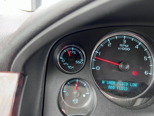

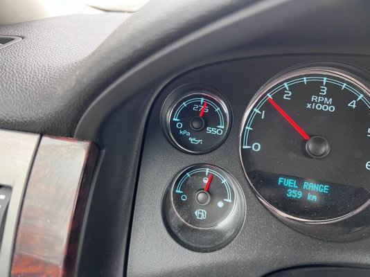

Changed oil today.
When i got the truck in September i put Fram TG10060 filter on it and Penzoil 5w-30.
Had an oil pressure on lower side ( 40 startup cold, fully warm 18 at idle and 22-25 while cruising at 1100rpm on highway ), but according to other posts that seemed in okayish range for these trucks.
I though my pickup tube is bad and was going to replace it in the summer.
This time decided to go with ACDelco PF48 and Mobil 1 5w-30 High Mileage.
As soon as the oil was changed my cold startup pressure shot up to 55 and now cruising pressure at fully warmth is 40.
The idle on warmth is now 25.
Crazy! Did i have a bad fram filter?
