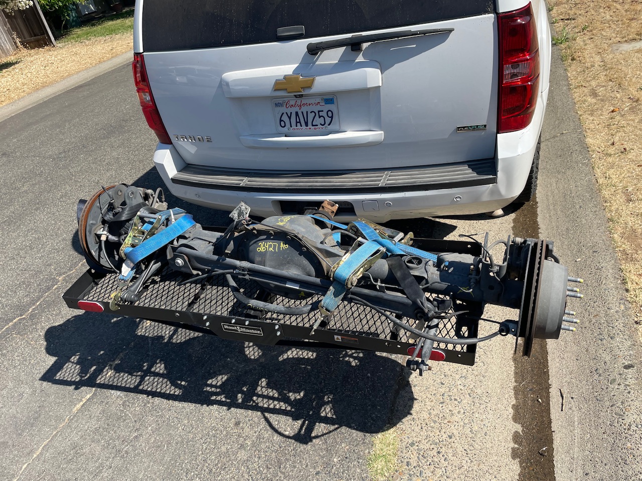

I'm joining the AXN club soon. 160k miles younger than the old one.
Hopefully the 3.42 gears are worth it...
I still need a front diff..

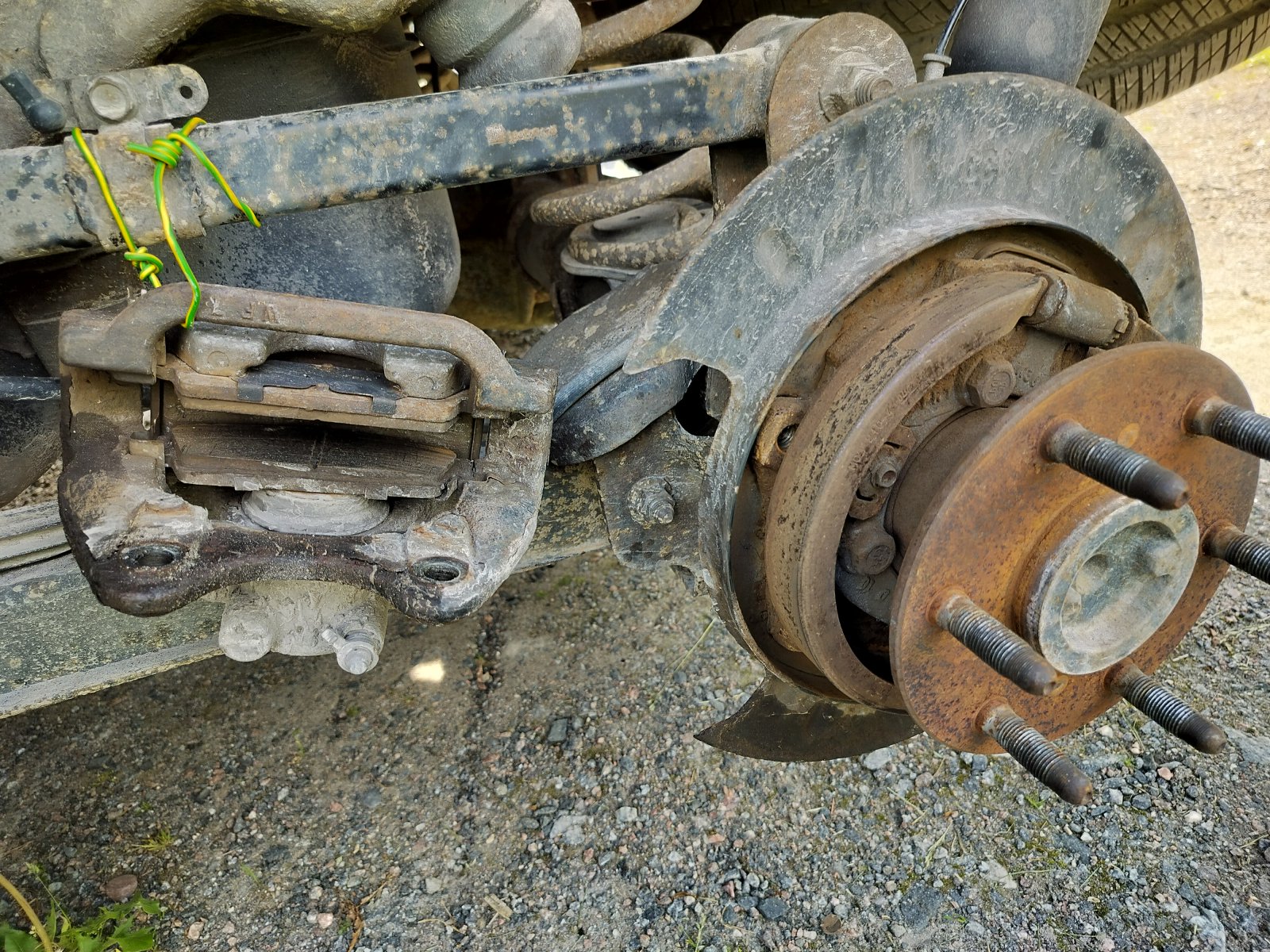

Anyways to avoid going too much offtopic, today I opened up those brakes to check why the parking brake isn't engaging.
Wonder if I can free up the brake pads somehow, looks like they are wearing unevenly (discs and brake pads are pretty new despite the parking brake looking ancient)

Wow, those parking brake shoes are nasty.
Makes me want to open mine up just to have a look but my parking brake is working as it should.

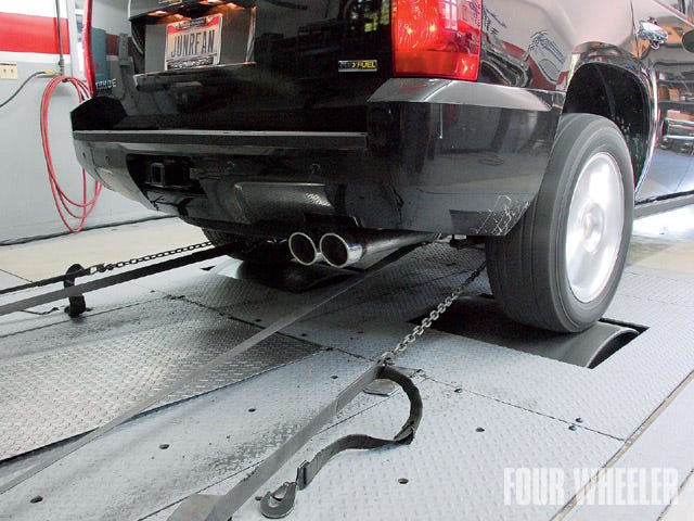

I found it, here is a link to the other thread I started...
It has links to some of the articles I was referring too.
The part I liked the best was...
"However, as with any truck application, we’re more interested in gains in the low- and mid-range. The dyno chart below reveals healthy gains in these areas as high as 45 lb-ft of torque at the critical 2,500 rpm point. A power gain such as this down low will substantially help the truck’s acceleration and improve performance during normal driving conditions."
I also understand they installed dual 3" cutbacks exhaust at the same time, so the argument can be made that the headers alone didn't equate to those power gains, but I think most of us here are probably running some sort of aftermarket exhaust already and dual.3" is extreme over kill for a N/A 5.3l, although it probably sounds really good.
A major problem with dyno results like these is that they're virtually always full-throttle, whether by necessity on an inertia dyno or due to habit on eddy-current dynos. So, the results don't tell you anything about results at part-throttle, where the overwhelming majority of driving is done.
I'd really like to see pulls made on an eddy-current dyno, simulating a part-throttle steady-state pull up a grade (or even better, a series of steady-state load sweeps), with and without headers, and stock vs. aftermarket aftermarket exhaust. That'd be an order of magnitude more meaningful to me and many others.

It was surprisingly easy to open actually. Just jack up and remove the wheel and two bolts holding the caliper in place, once you pulled away the caliper (always have a ziptie or wire in your pocket when doing this, the brake line will *not* support the weight of a brake caliper) the disc is simply pulled off. Installs back just as easy. I was actually a bit weirded out it wasn't torqued down by anything.
As for the parking brake shoe, yup that's a goner. Ordered AcDelco gold and the mounting parts kit as well, dunno if good or not but at least it was twice as expensive. Will post a few pics of the assembly when it arrives.

I have a set of caliper hangers for doing brake work.
And if all else fails, i have some 12 gauge THHN copper wire I use to hold up the calipers.

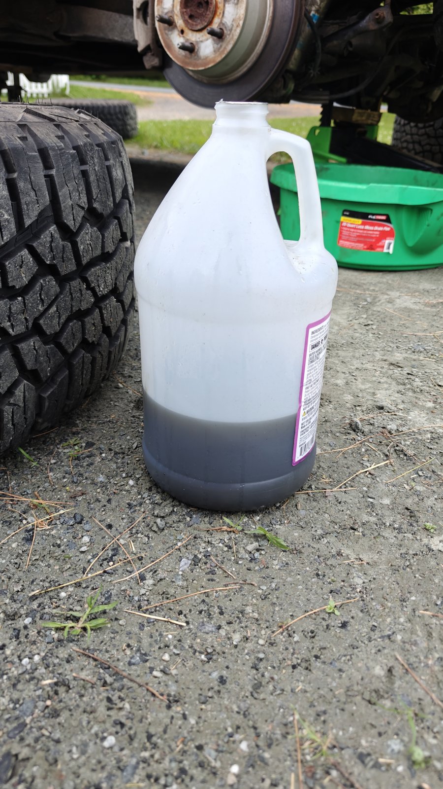

Replaced the four outer brake hoses, and was going to replace the two inner-rear hoses, but realized I only bought one. Dang.
Sll six of the hoses are still in serviceable shape, with no cracks, rot, or serious rust, but RockAuto had some super cheap on clearance, so I ordered them all (or so I thought).
The old fluid was yuck, as usual.
