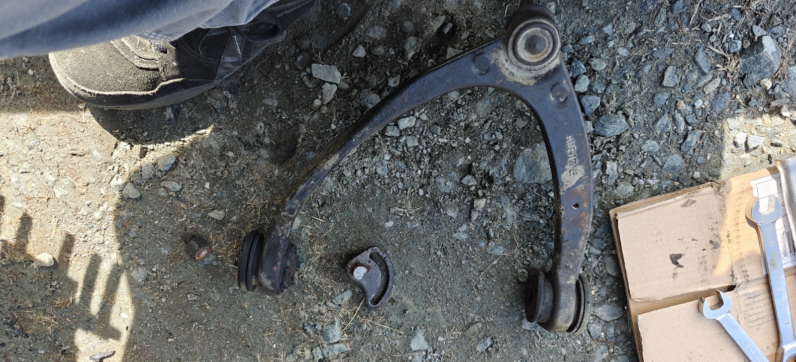

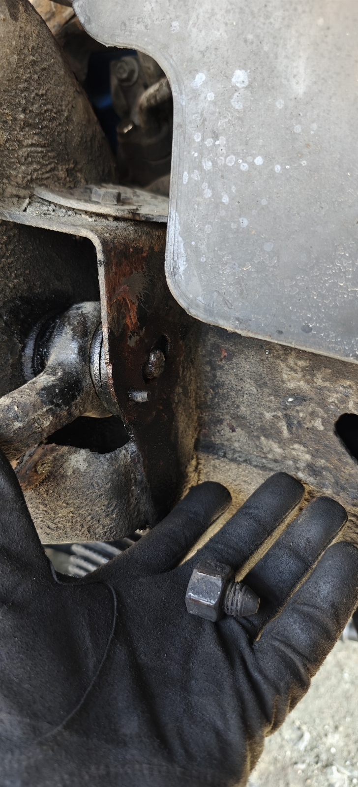

Welp.... Had it all apart in 25 mins, but the universe has a funny way of slowing you down.

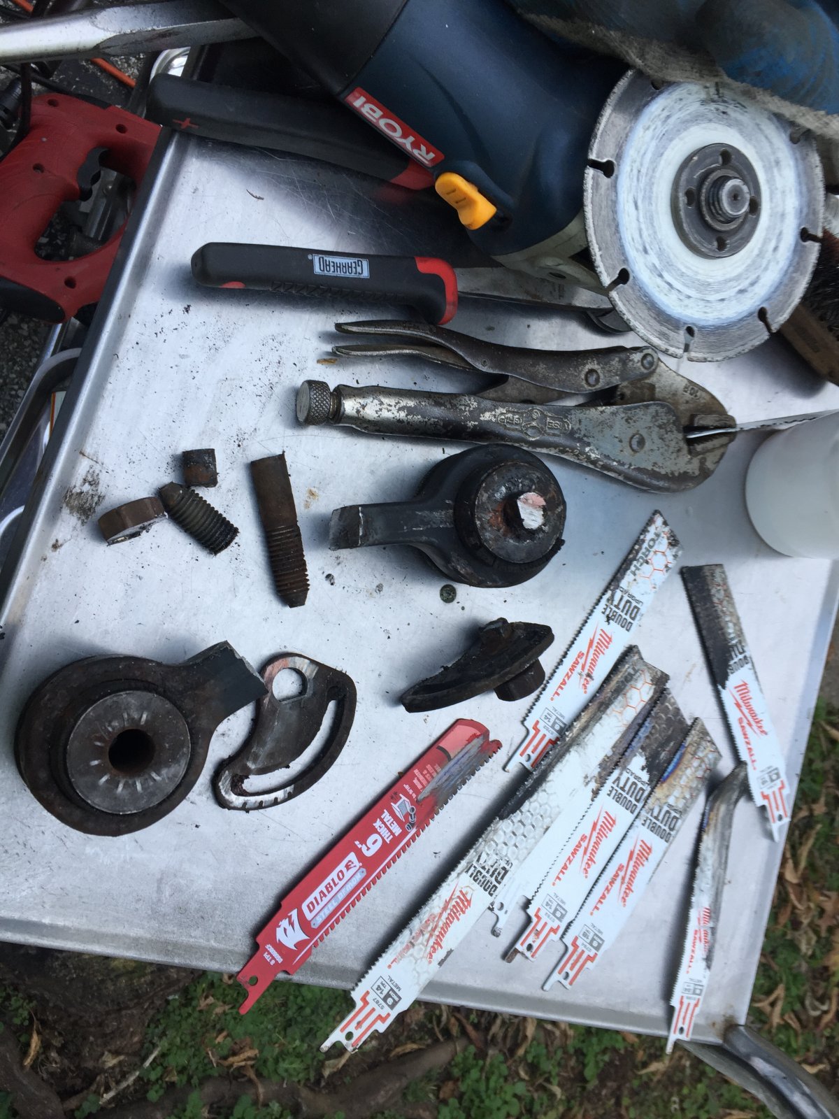

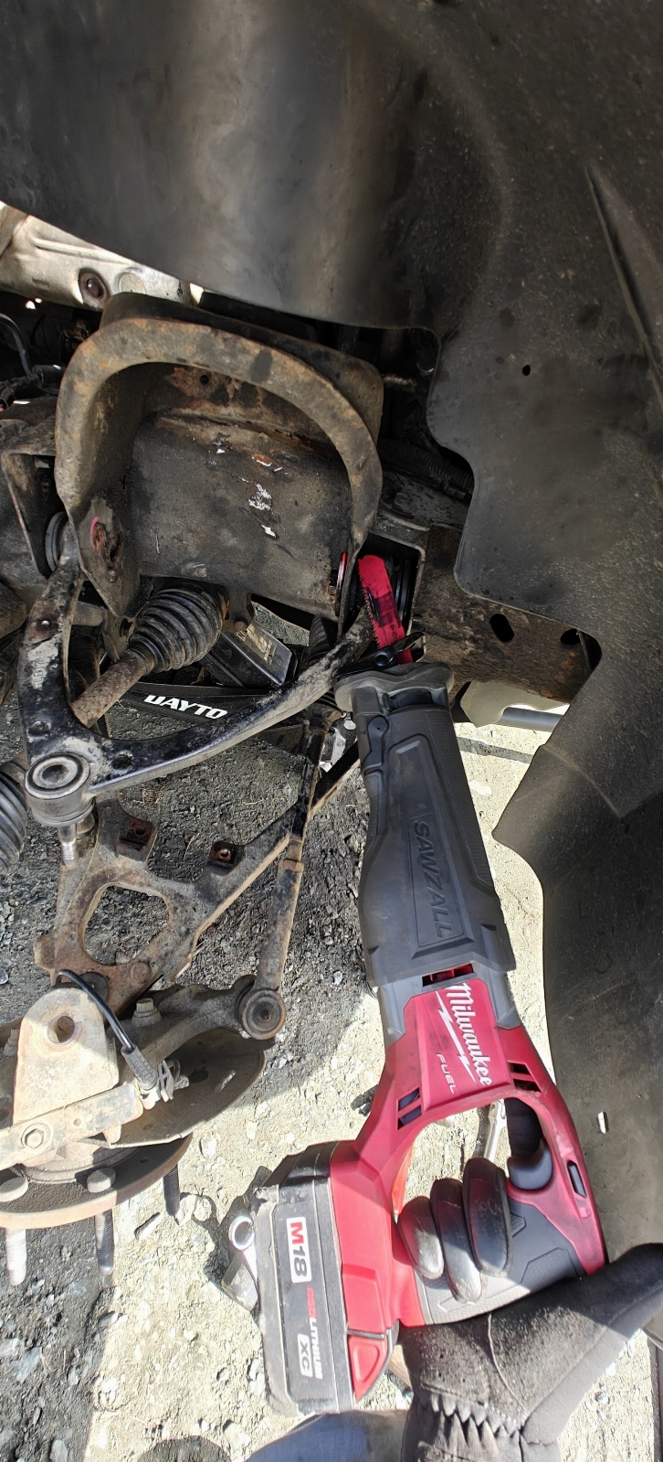

Carbide and cuss words....
Now just trying to find some camber bolts... NAPA website listed just the bolts as in-stock, but the guy on the phone couldn't find them. About to call AutoZone and O'Reilly. For a temporary fix to limp to the store, I found some new control arm bolts from my old Armada to jam in there for the ride to the store and back.
this is part of the reason why I always have 2 vehicles even if one is a pos beater or something that rolls. If I had room I would have 4-5 again, but no parking spots around here.
if one goes down just jump in another...
that bolt didn't look all that rusty, I wonder if someone over torqued it in the past...
Yeah, I used to have two cars for summer/winter, but I've been "blessed" with such reliability out of this Yukon. Stupid bolt.

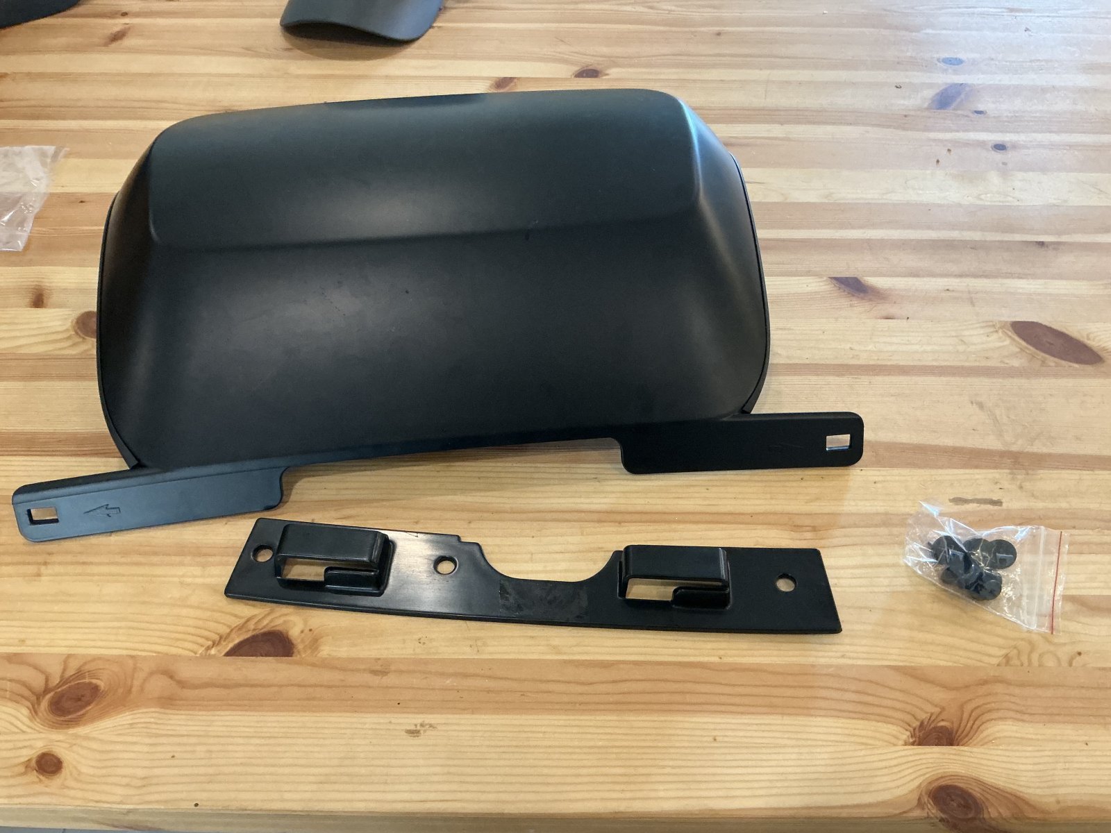

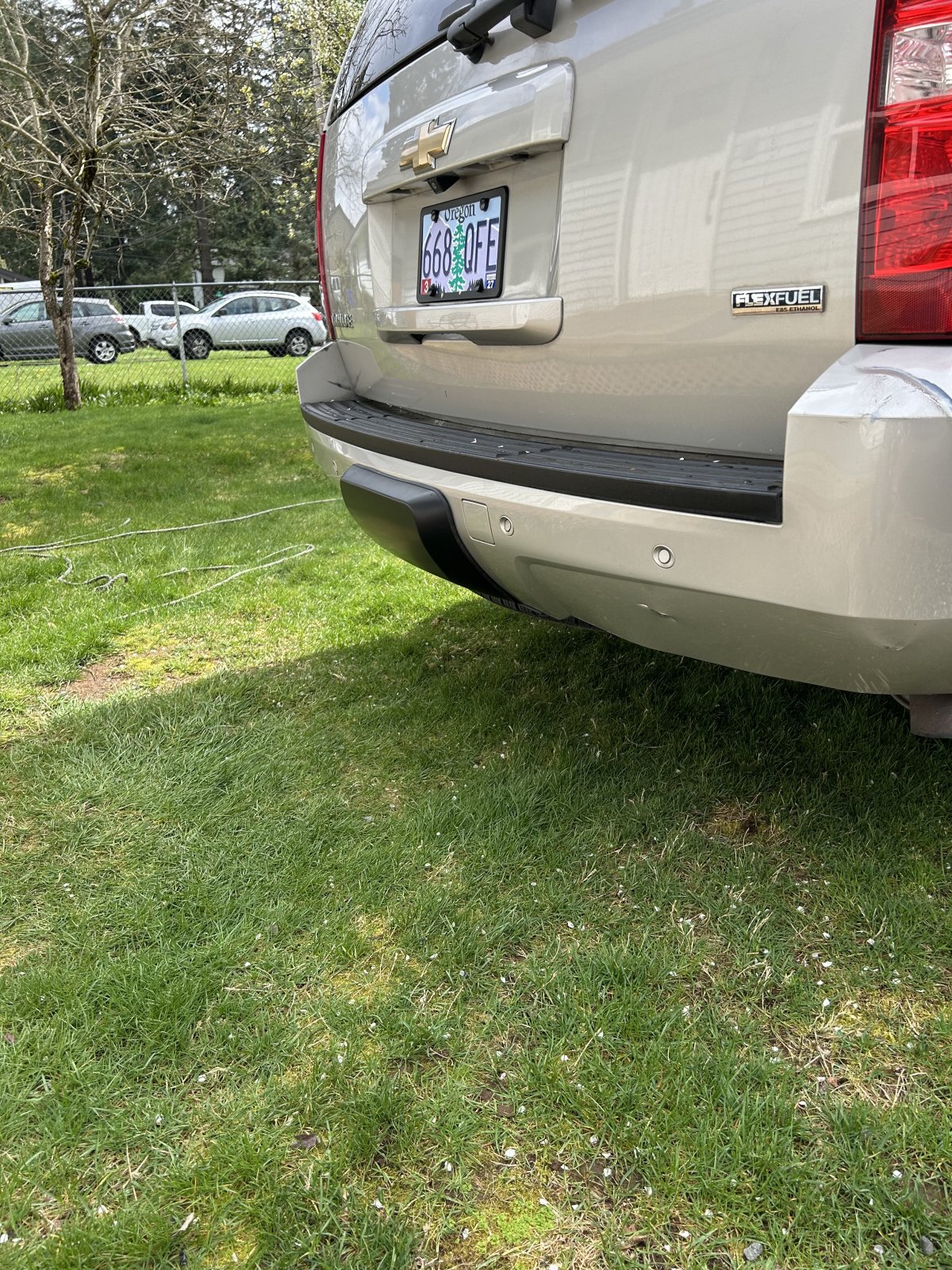

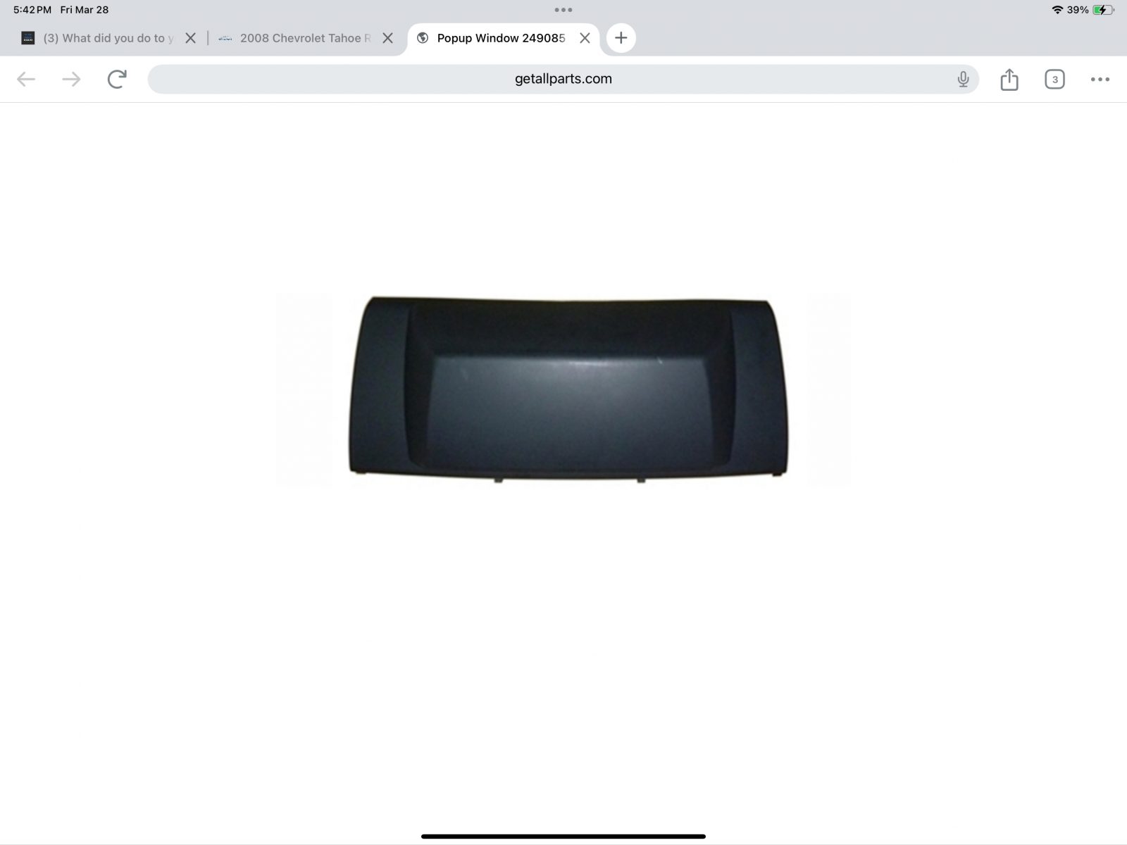

Bought this hitch cover kit; waiting on automotive touch up to send me the paint I ordered a week and a half ago. Anybody install one of these? I see where to install the bracket but any tips would be appreciated. Better yet, a pic of the bracket mounted would help me position it exactly.

Bought this hitch cover kit; waiting on automotive touch up to send me the paint I ordered a week and a half ago. Anybody install one of these? I see where to install the bracket but any tips would be appreciated. Better yet, a pic of the bracket mounted would help me position it exactly. View attachment 453736
I would give you a picture of mine but I think the Denali bumper cover/pad is different. Mine didn't have the cover and I got rear-ended a little bit and I just claimed that it must have fell off from the accident so I got one for free, painted and everything lol
There’s 2 styles. There’s one that looks like mine and one that looks more squarish like this. There doesn’t seem to be any rhyme or reason, just depends on which bumper you have. Escalade/ Tahoe/ Yukon, the only one for sure is the Esky has the squarish one every time.

There’s 2 styles. There’s one that looks like mine and one that looks more squarish like this. There doesn’t seem to be any rhyme or reason, just depends on which bumper you have. Escalade/ Tahoe/ Yukon, the only one for sure is the Esky has the squarish one every time. View attachment 453743
ya mine is the wider one like this, it just clips on the bumper with twist locks on the bottom

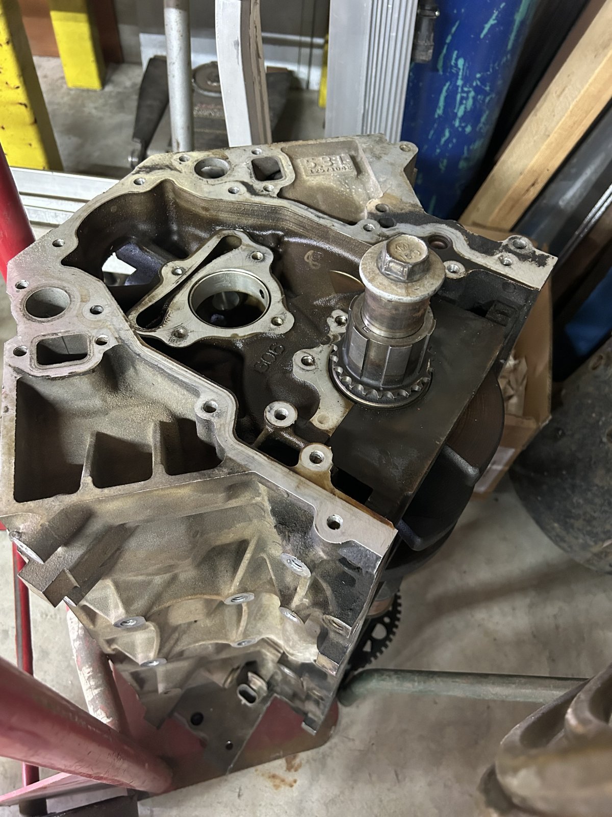

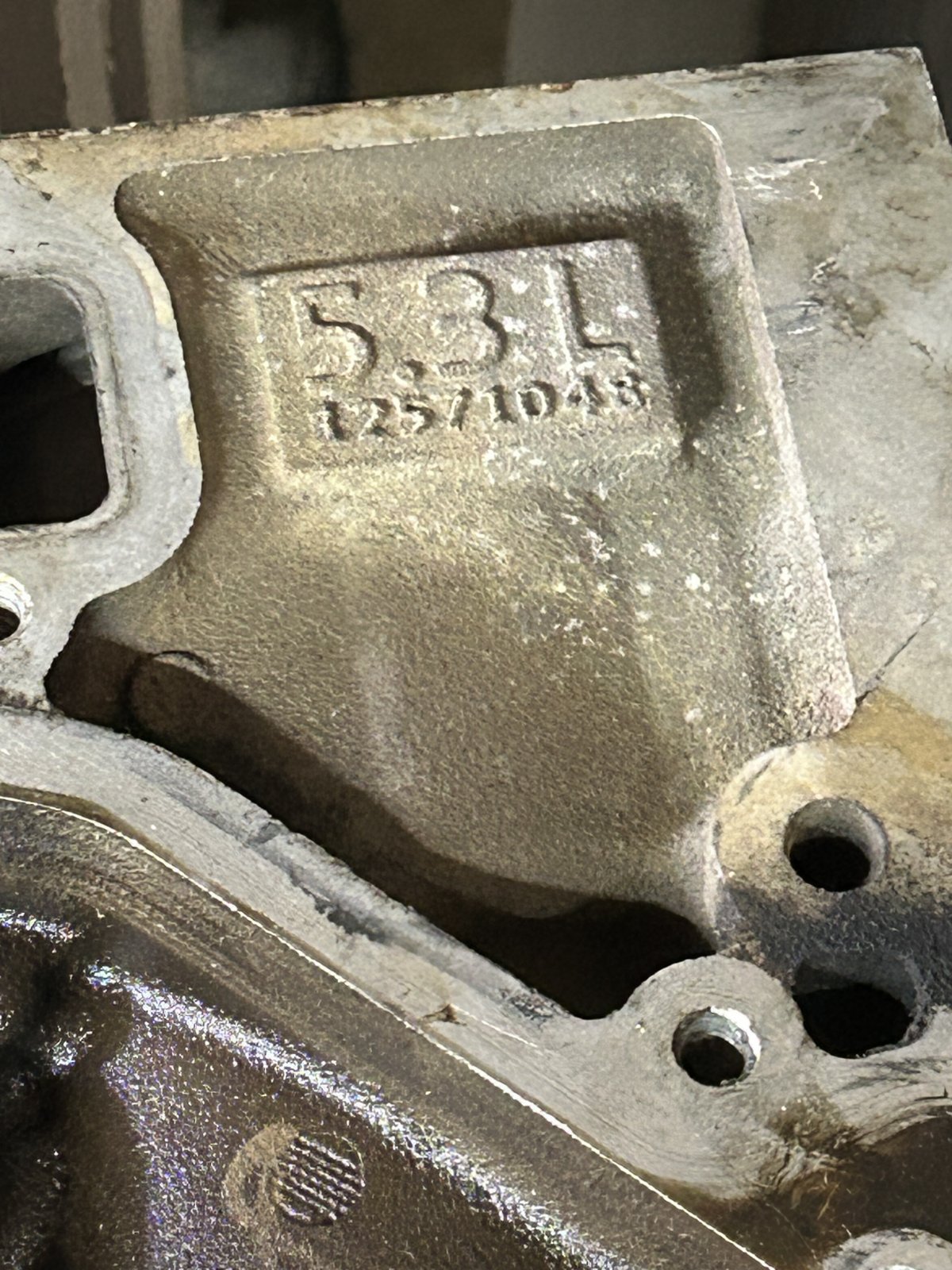

Anyone ever rebuild a motor? This'll be my first.
