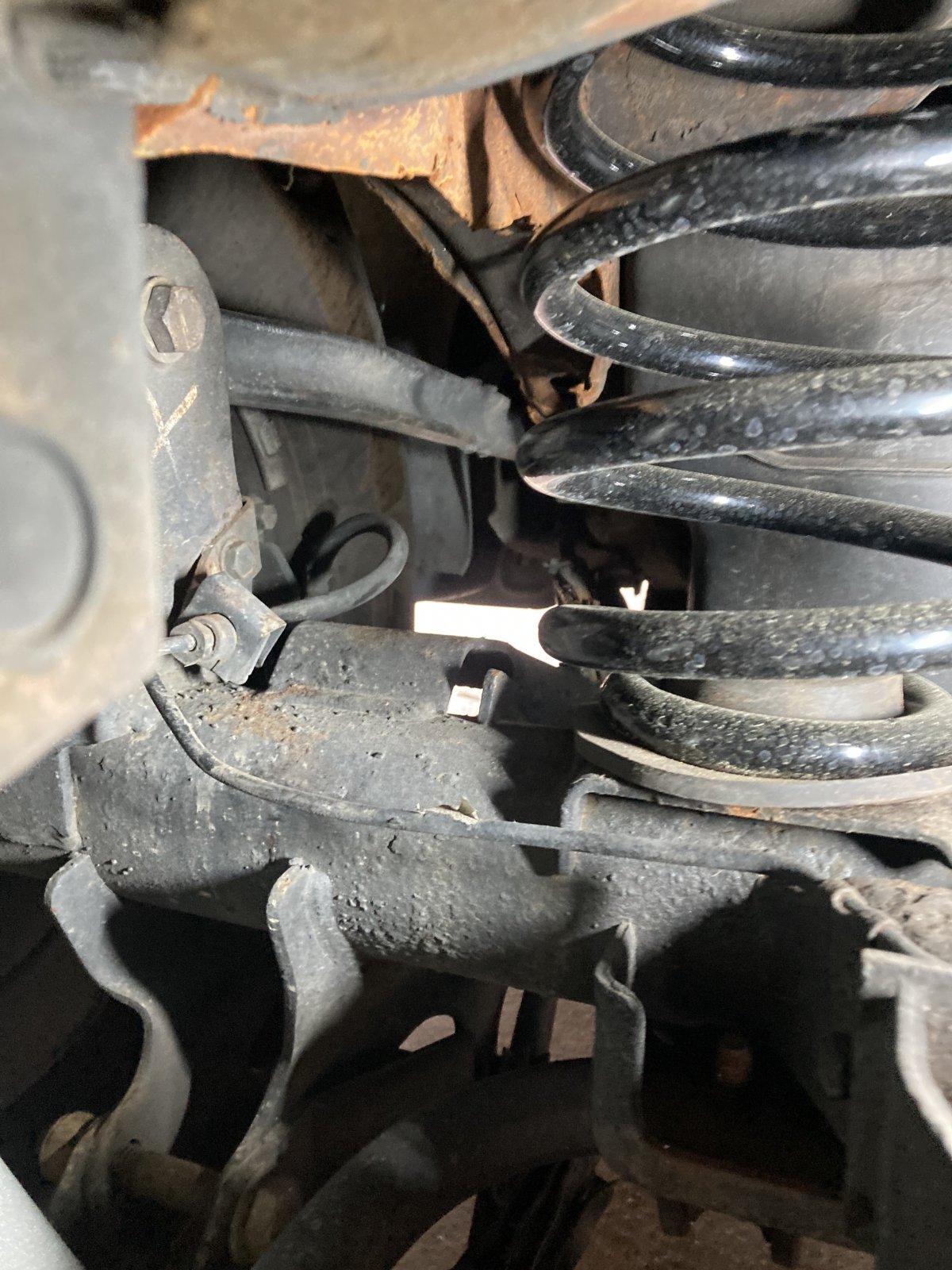

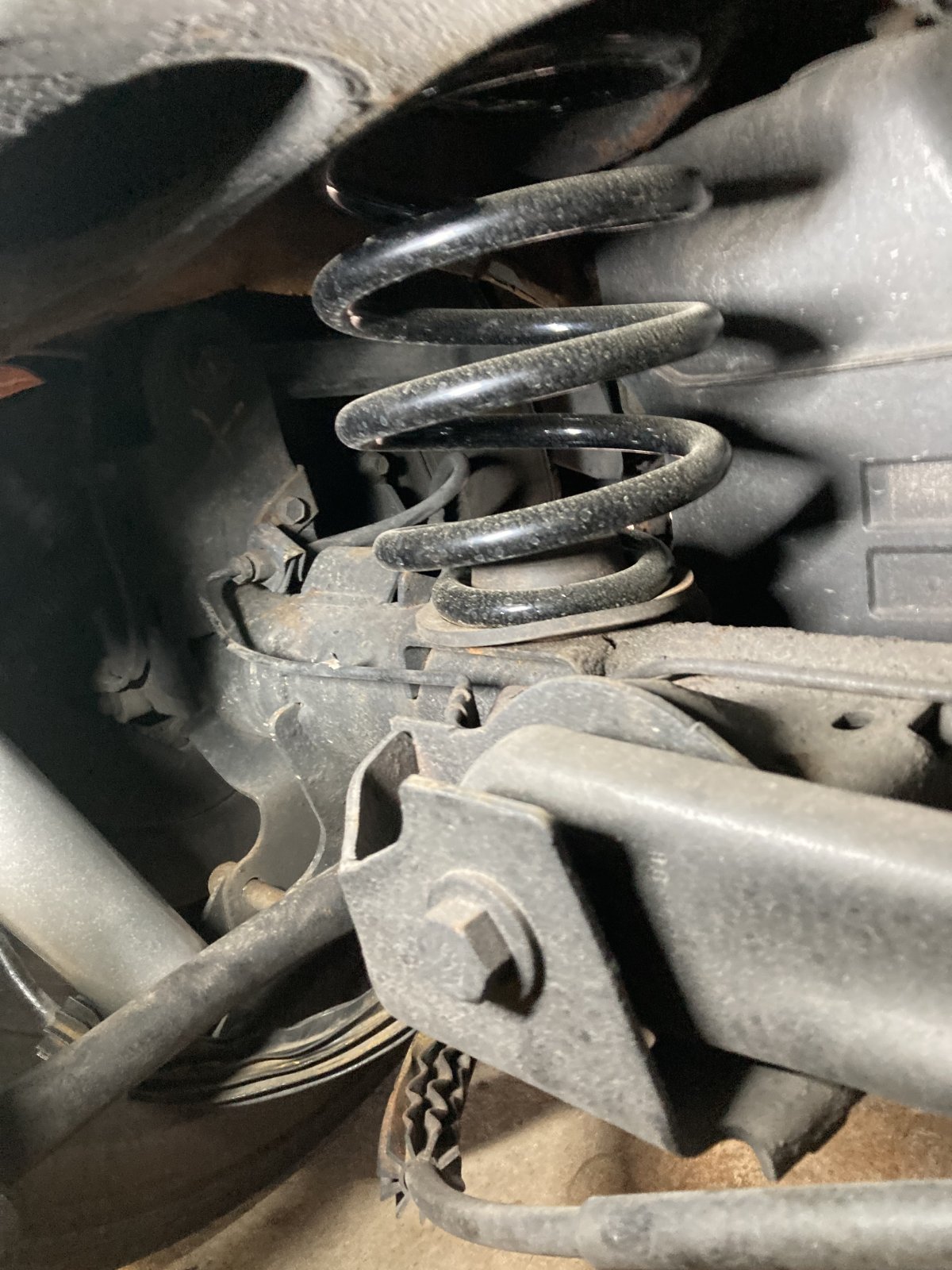

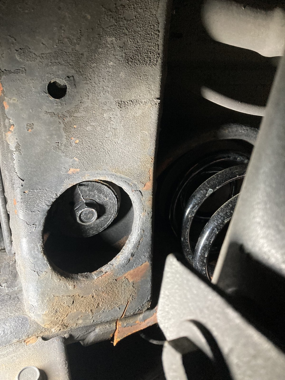

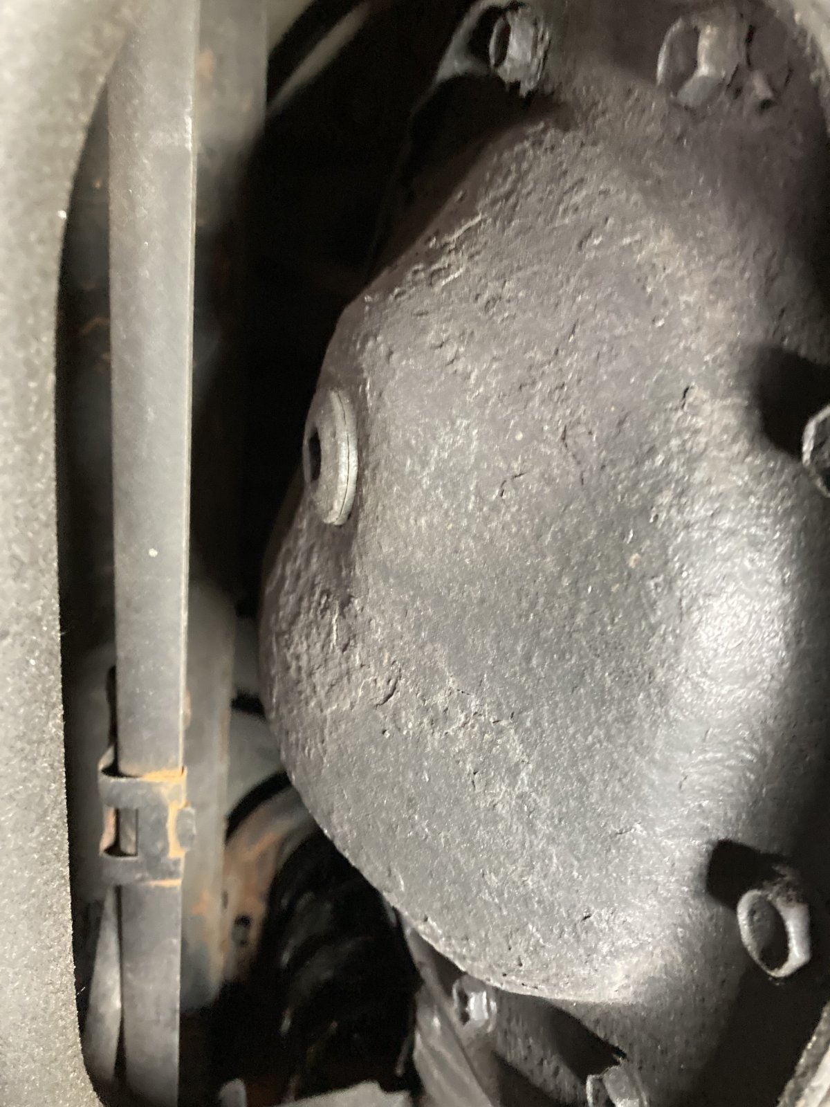

Ok I have been having an issue with a bottoming out in the rear with the 5" springs after they settled for about a week. Only at a few choice dips I got to hit is when this happens. I was not able to find ANY visual evidence of contact at the suspected locations:
Panhard mount to frame
swaybar to panhard
axle to frame (free travel mod done)
axle pumpkin to cross member
So I figured it had to be the factory shocks bottoming out. I ordered the 2410FF belltech shocks and put them on this weekend. Huge improvement in the ride, but I still feel a bottoming out at the usual suspect dips. This is driving me nuts.

What is the torn metal in the last pic?
thinkin that was from a fight with the free travel mod :oops:
mine hit the bump stops and then the axle side panhard bar mount, both those pics in yours looks fine, you sure the springs are seated in the top and stuff like that?
correct, I will clean that up later
springs are perfectly set in place with the isolators
