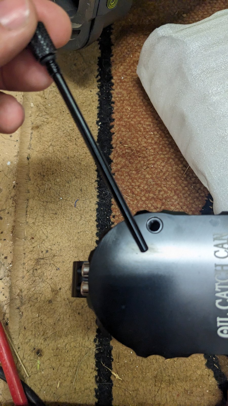

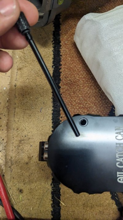

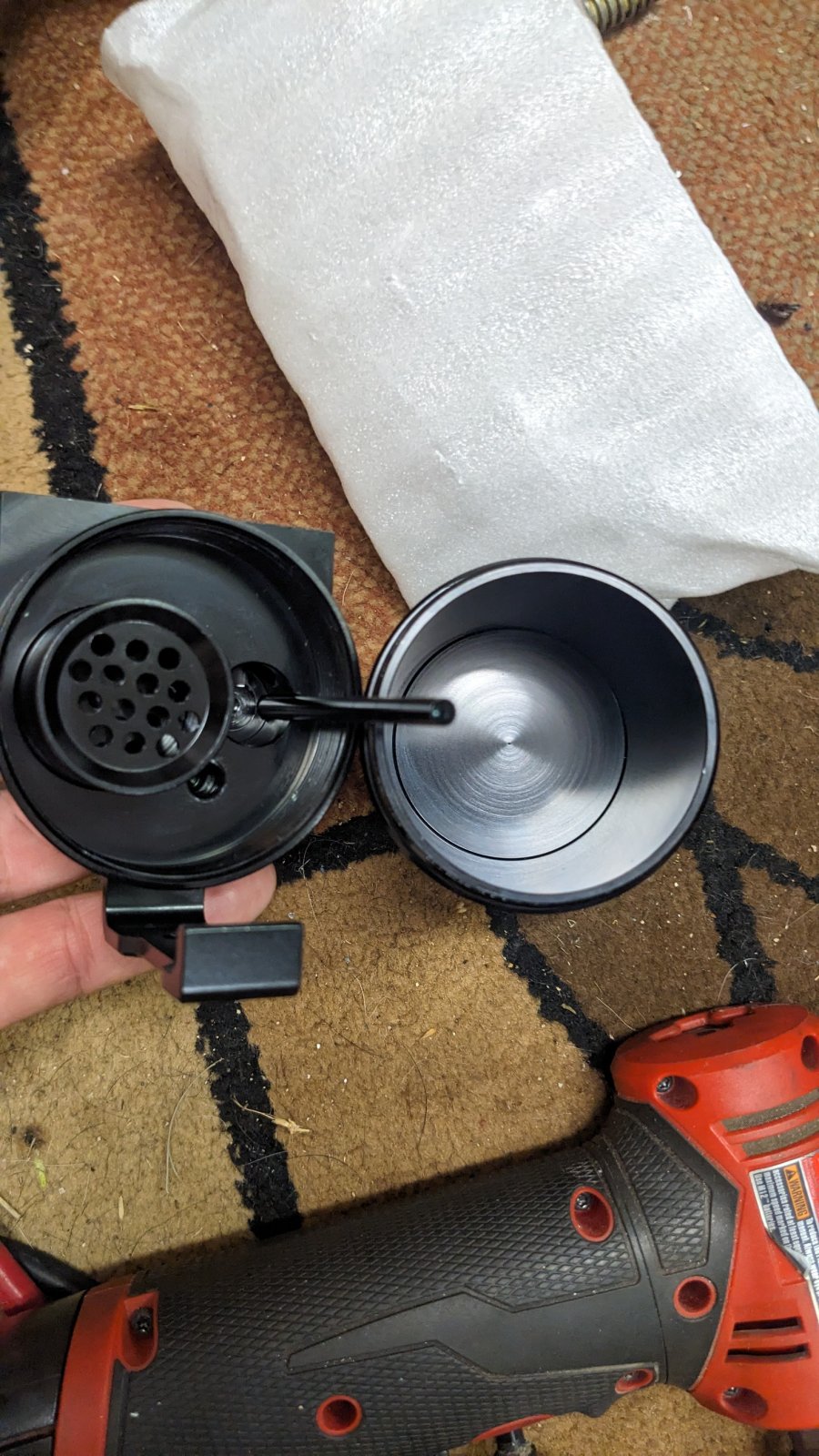

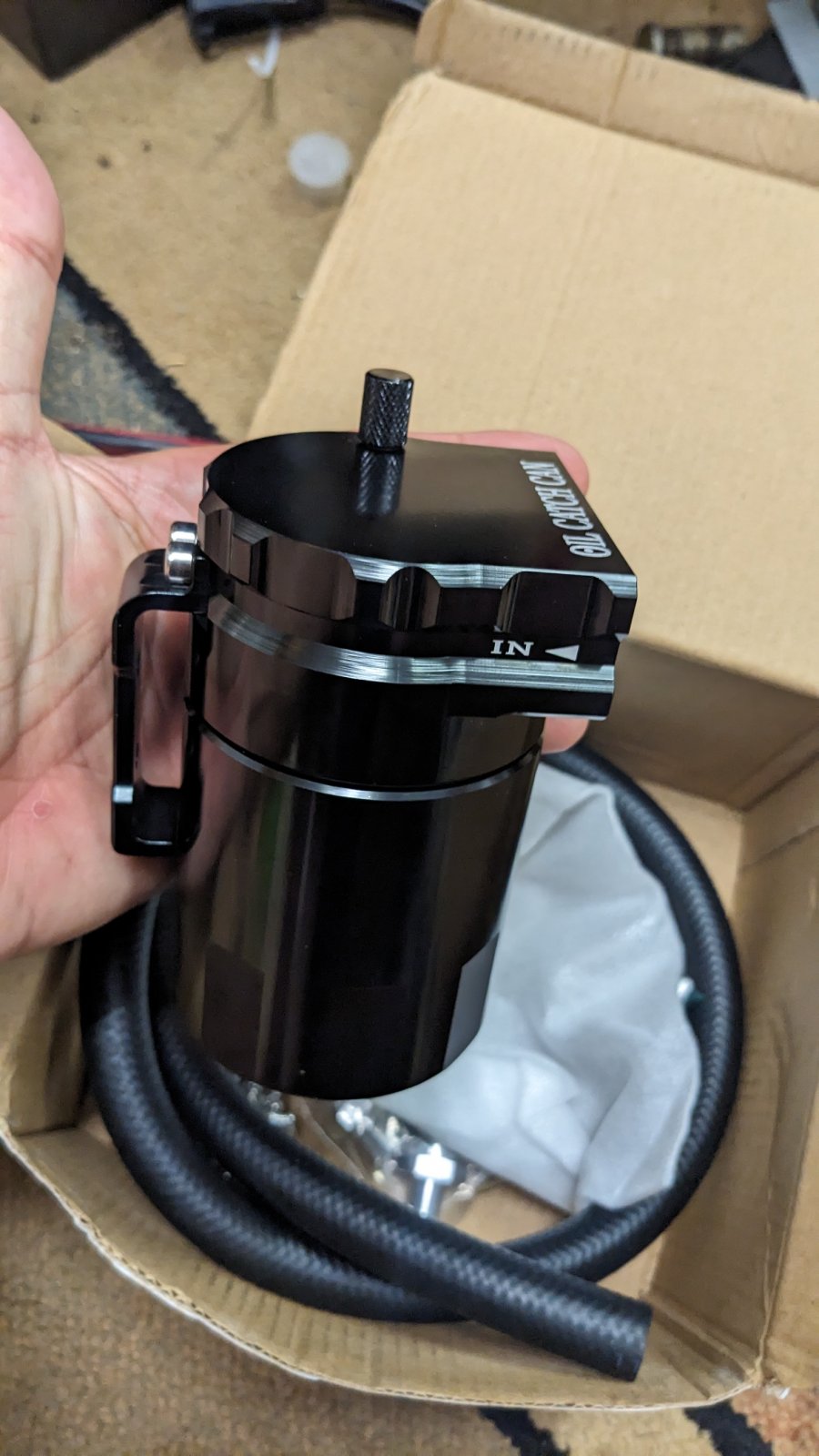

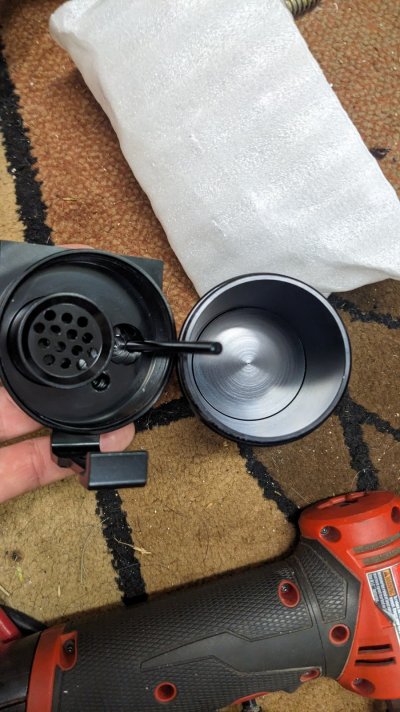

I looked thru a bit of the catch. can thread last week and ended up ordering a cheap Amazon one. I've lost the thread but where does the steel wool go?
few pics.. it's surprisingly heavy full billet feeling thing. no drain in the bottom thou.
That's an effective unit. I don't worry about using the steel wool myself.

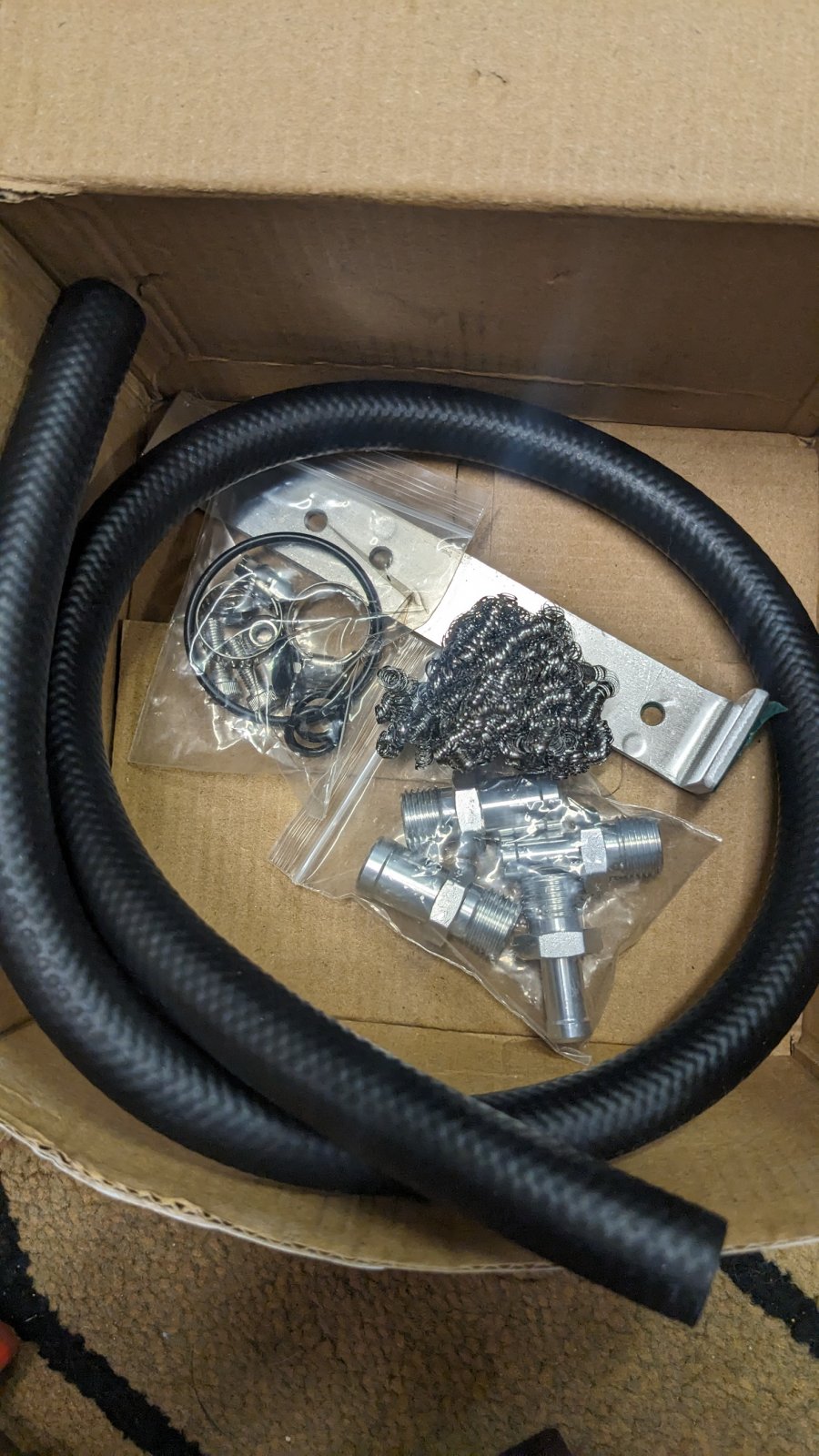

yeah? on the one sheet of paper you might call instructions it didn't say anything about. I thought about maybe putting it in the part with the holes in it. that part unscrews. but it's kinda big to jam on there.
maybe I'll just leave it out and see what it does. never put one on a NA engine before but looked like it did something useful on everyone else's in the thread.
The steel wool provides extra coalescing surface for the oil vapor to attach to. Doesn't take much to do the job so I would just tear off a piece that will fit in there and go with it.
We all have different opinions here. I just personally don't care for it or see a difference using it. And it is less hassle to empty and clean it out which I have to do about once a month.
That little screw in baffle piece fell out on me once so make sure it is snug or maybe put some thread lock on it.
yeah I didn't really expect to clean all that, just unscrew the bottom and dump it from time to time. I just wasn't sure where to put the steel pad if I was to use it lol.
makes sense, I just wasn't sure that's where it went.
if I remember right in engines like the Nissan RB you gotta have some kinda metal screen in the valve cover and the catch can or they drink tons of oil.
I'll mess with it and see what I end up with.
That's a different design than the more common ones. Those have a ~2.5" plate with holes all in it (the baffle) that's suspended about 1" below the top piece. The scrub pad would go in that 1" gap, basically resting on the baffle like a shelf. There's usually some polymer sponge material, like the green or rust-colored scrub pads packed in that smaller area behind the baffle. My catchcans.com one has this as well as the scrub pad that I added. There's no reason to disassemble and clean it. Just drain it. If the material is thick enough, I'd drill and tap a hole in the bottom to screw in a drain valve. Or, if it's too thin, drill it and TIG a nut to the bottom to screw in a drain valve. Trim the threads of the valve to not protrude higher than the floor of the reservoir so it drains fully.
it's definitely thick enough to put a drain in. I might do that.
I'll see how much it gets. I also have a oil sucker, I could suck it out the dip stick whole while doing oil.
I probably should have researched catch cans lol. it was a cheap. Amazon impulse buy haha. so it is what it, at this point parts are stacking up for this thing. I need to actually work on it.

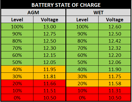

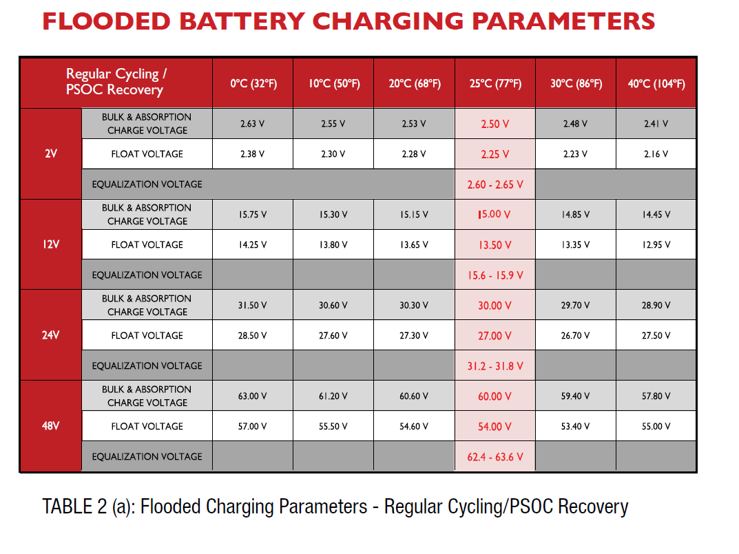

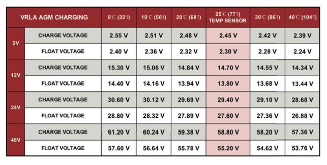

I do have HPT. So that's all the difference is- preferred charging voltage? What about the RVC stuff?
the voltage that each battery is considered 100% charged is different. but not a lot thou. plus the internal resistance is less for an agm so it will accept charge much faster after crank. how that effects real world swaps, I don't know. but engineers need to take that into consideration. plus battery Temps they like different voltages as well.
here's a few charts I found to compare. gives an idea of what I've read. charging agm to voltage that leaves flooded at 100% might leave your agm under charged. but they do tend to handle under better than over. so there's that.
I read a few days when trying to decide to switch this hybrid yukon to agm or leave it flooded. in the end I said eh, give me the agm. rock auto will ship those and not flooded haha.

I set my voltages to be between 13.8 - 15 V.. Not sure if it helps, but it sounds like AGM's need higher voltages typically, yet don't tolerate overcharging as well as flooded..
Still see 13.6V on cig port, but I notice with the fan on, it will drop .2V or so, and turning it off, the cig voltage will climb back up after a few seconds.
Also have thought about disabling the RVC as AGM's are supposed to work moderately well in older vehicles. I'm guessing the charging logic undercharges the AGM if anything. Might think the battery is at a higher state of charge and not charge it 100%. My typical key on battery voltages are around 12.5V.. have seen it as low as 12.3..
Looking at the chart j91z posted, that doesn't seem too bad (70-80% charge)
