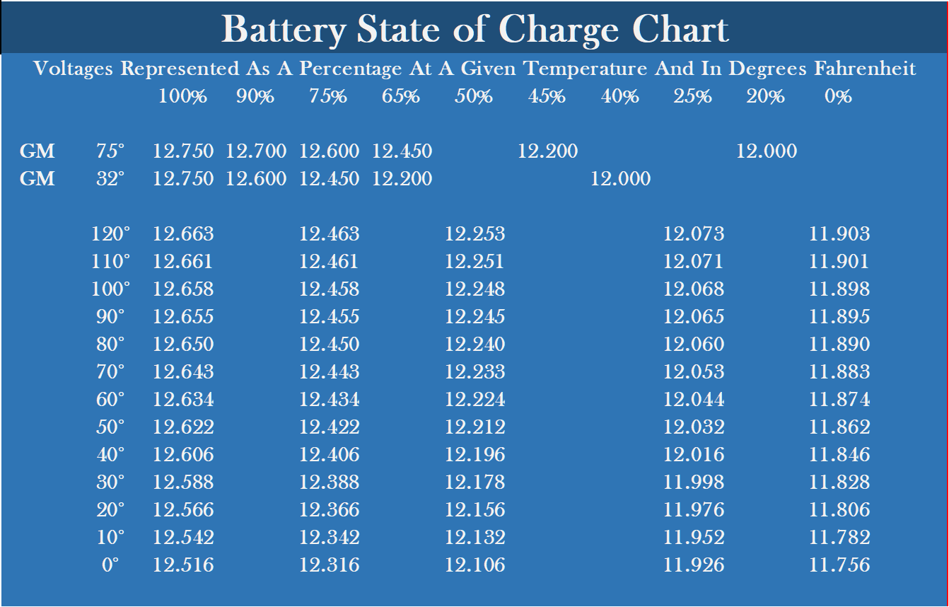

Tom, use the Tech-2 to see what the start up state of charge is and the state of charge after sitting overnight. If it is less than 64% GM says to replace it. A tender may resuscitate it but only for so long at that age.
Go into the BCM, then BCM again and Charging Info section to see the values. Also, if the battery is hot, that's a sign she's not taking a charge well too and is wore out or needs reconditioning. My menus may be a little different from yours but this stuff resides in the BCM and not ECM.

With it sitting on the bench and charging with that new Schumacher charger I got, it will charge up to 60% then say charge complete and go into standby/maintain mode. Disconnecting the charger and testing with DVM it's at 12.6v, a half hour later it's at 12.4v. I'll check it again in about an hour.

12.4 V is in the 60% range and probably means she's about had it Tom.
The charger is stopping because of resistance encountered or calculated heat.

I just went out and checked it with a meter and it's down to 11.8v from the 12.6v it had. This is just sitting on the bench in the garage for the last 3 hrs after being charged with nothing plugged into it.
Think I'll be running to Costco or Walmart tomorrow and getting a new one. Might get the AGM

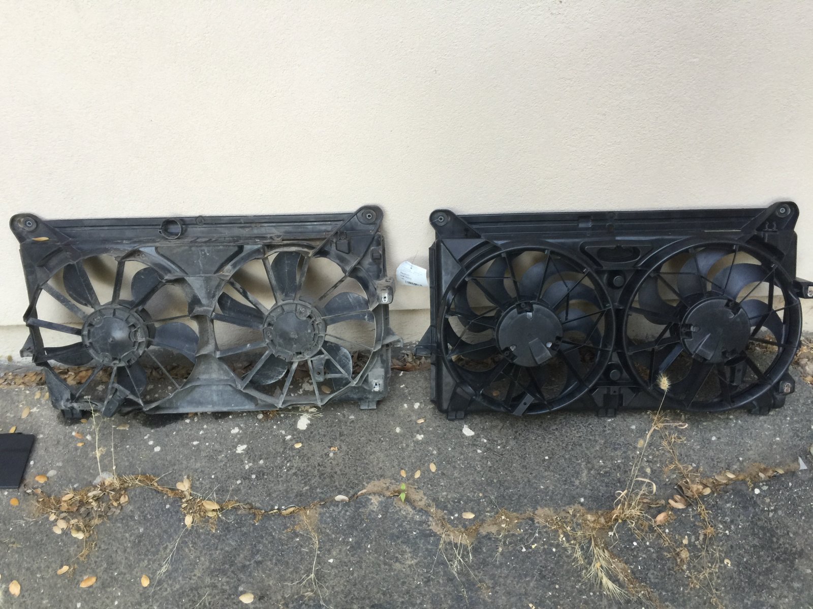

think i found my coolant leak
got the melling waterpump installed, denso radiator, dorman heater hoses, gm radiator hoses. just waiting on my gm thermostat.
push bumper helps a lot as you can stand on it and lean over the top of it.. also threw in the 700watt fans..

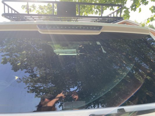

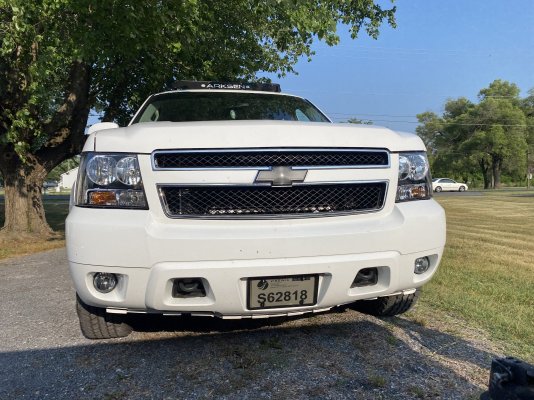

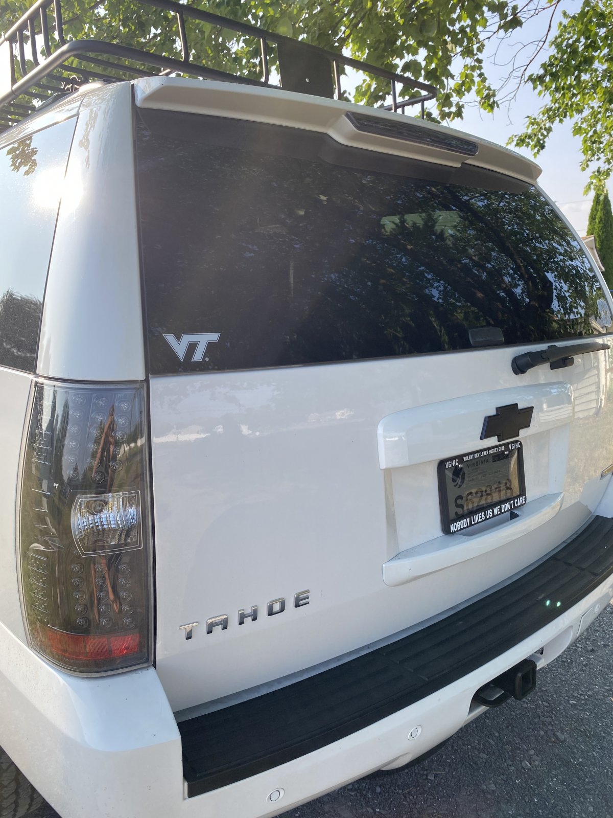

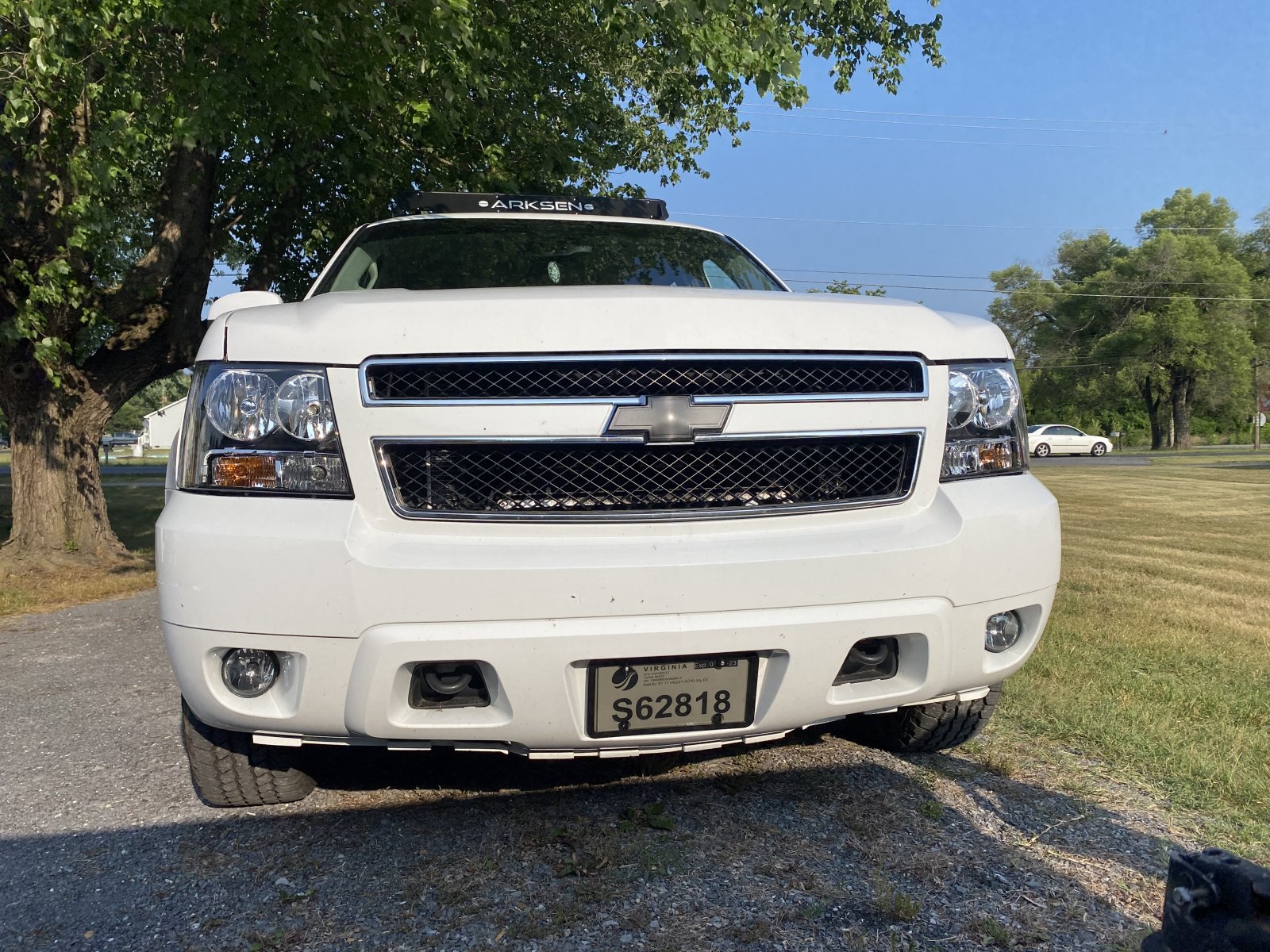

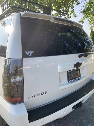

Installed new head, fog, tail and 3rd brake light assemblies. All the rears are LED and the front are just standard halogens.

did it come in a k&n box? buy from a legit source? I have a blackhawk and I needed the carb sticker so I had to send them a picture of the plate welded on it and my vin. the plate should be on it in your photo but it's not there. just a heads up
Yeah I ordered it from K and N came with the Carb sticker and all the other little stickers
