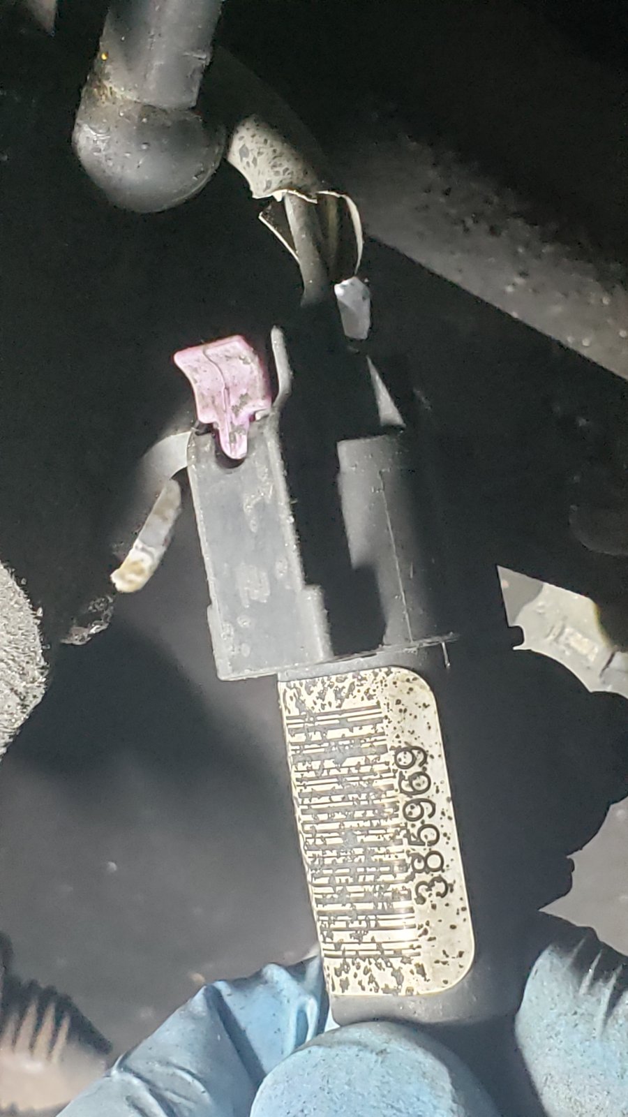

I think that pink thing needs to be slid out first then go from there dawg.
I just figured it out. I couldn't get the pink part pressed or pulled out. After posting the pic I thought about sticking a small screwdriver in from the bottom and pushing the pink part up. Once I did that I squeezed it in and pulled the plug out
that red tab is a locking tab you will find them all over whenever you see those they have to be pulled up first to release the tab. Some are grey or light grey color instead of red.
and SRS ones are yellow.

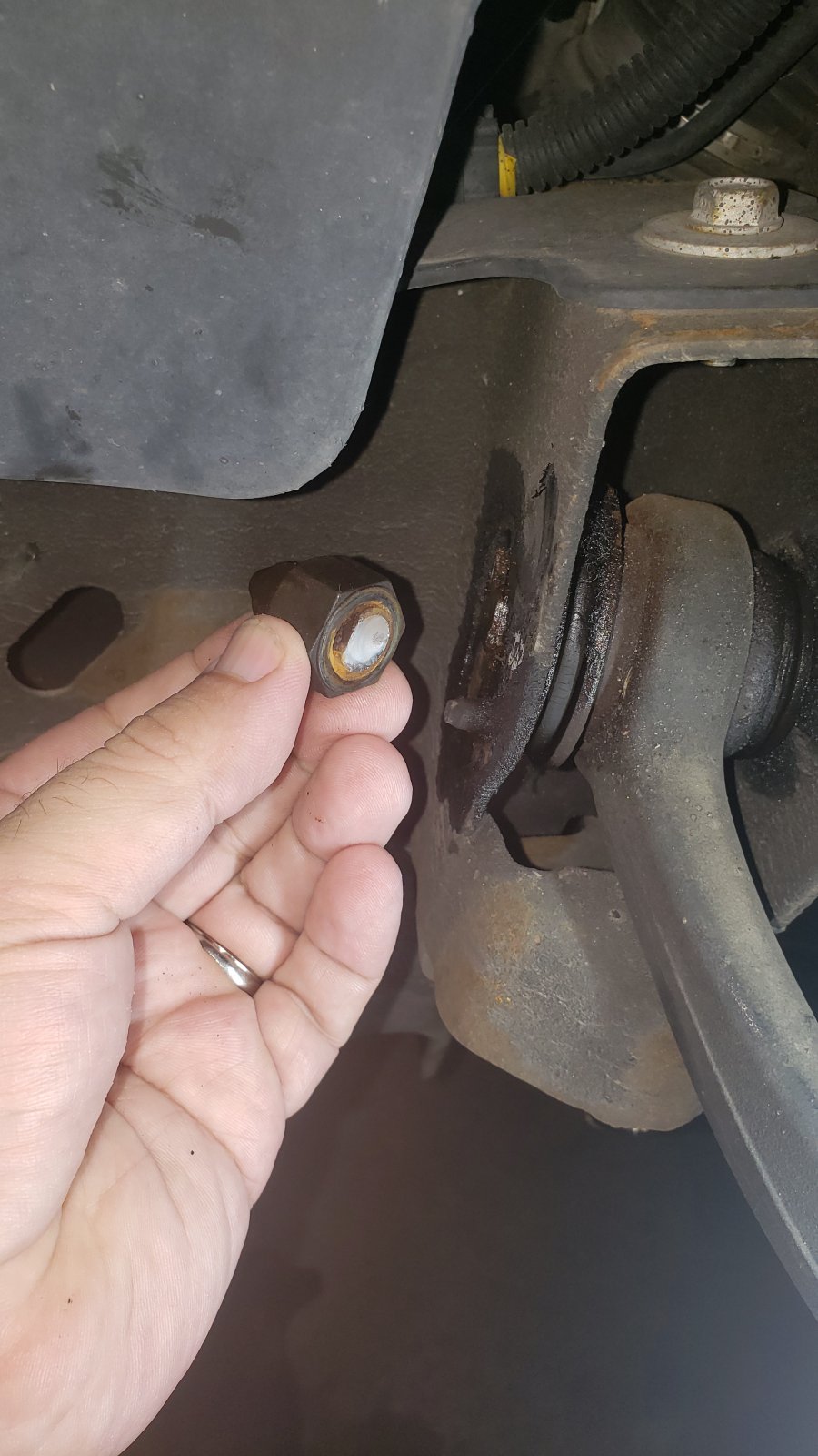

MFer, I knew it was going too smoothly.
Damn forward upper control arm bolt snapped when taking it off
I never had one do that but mine always are frozen in the bushings and have to be cut out. If that's the worse of your problems you will be fine. Never had a problem with the LCA bolts. Just the uppers. I always plan on having new ones ready if I go tearing into those uppers. Otherwise you seem to be moving along quite nicely! Thanks for sharing!

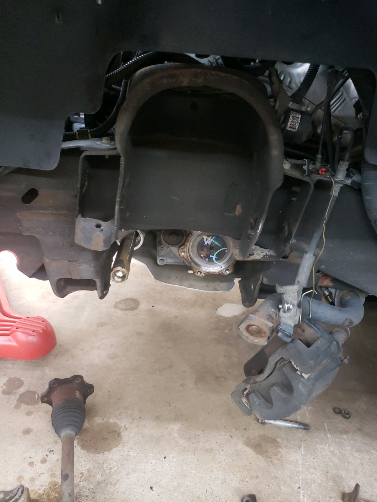

Well got the driver's side done after running out and picking up a couple of those cam bolts.
Started on passenger side and decided to try what I saw on YouTube where you keep the brake rotor, caliper, and hub all assembled and just undo the lower control arm bolts and let it all hang from the upper.
Started by unbolting and removing the strut, then the CV shaft from both ends so it can come out after the lower control arm bolts are removed and the control arm is hanging free by the ball joint. Then while it's hanging unbolting the lower ball joint and swapping in the new lower control arm.... But the lower control arms were shipped with the grease fitting installed and this side had it broken off, so I spent some time using an easy out to get it out and put in a new one.
Then put a jack under the new control arm to help support it when I remove the upper arm, but haven't got to that point yet. Spent a lot of time trying to get the front control arm cam bolt out. Got the nut off but the bolt seems to be rusted to the bushing sleeve and doesn't want to come out. Rear bolt comes out fine.
Sprayed the entire area with PB Blaster and also removed the wheel well liner so I can get my 3lb hand sledge in there to whack at the bolt. Alternating between hammering it and wrenching on the head end of the bolt back and forth I got it out after dicking with it for about an hour. Glad I picked up an extra cam bolt.
After that I was done for the night. Hopefully I'll get it finished up tomorrow.
You got real lucky on that one. When I tried beating mine out the stud of the bolt started to mushroom on me.
Did you break the lower ball joint loose before or after unbolting it from the frame? I did it after and it was a real bastard to break it loose with everything hanging loose.
I threaded the nut back onto the end of the stud so they were both flush with each other before beating on it. Figured it would give more surface for the sledge to hit and keep it from mushrooming.
As for the lower arm, I did the inner bolts first then the ball joint bolt while hanging. It probably would've been easier to do it in reverse. It is a bit awkward when it's hanging. I used my Ridgid cordless 1/2" Impact wrench so it did make it easier.
