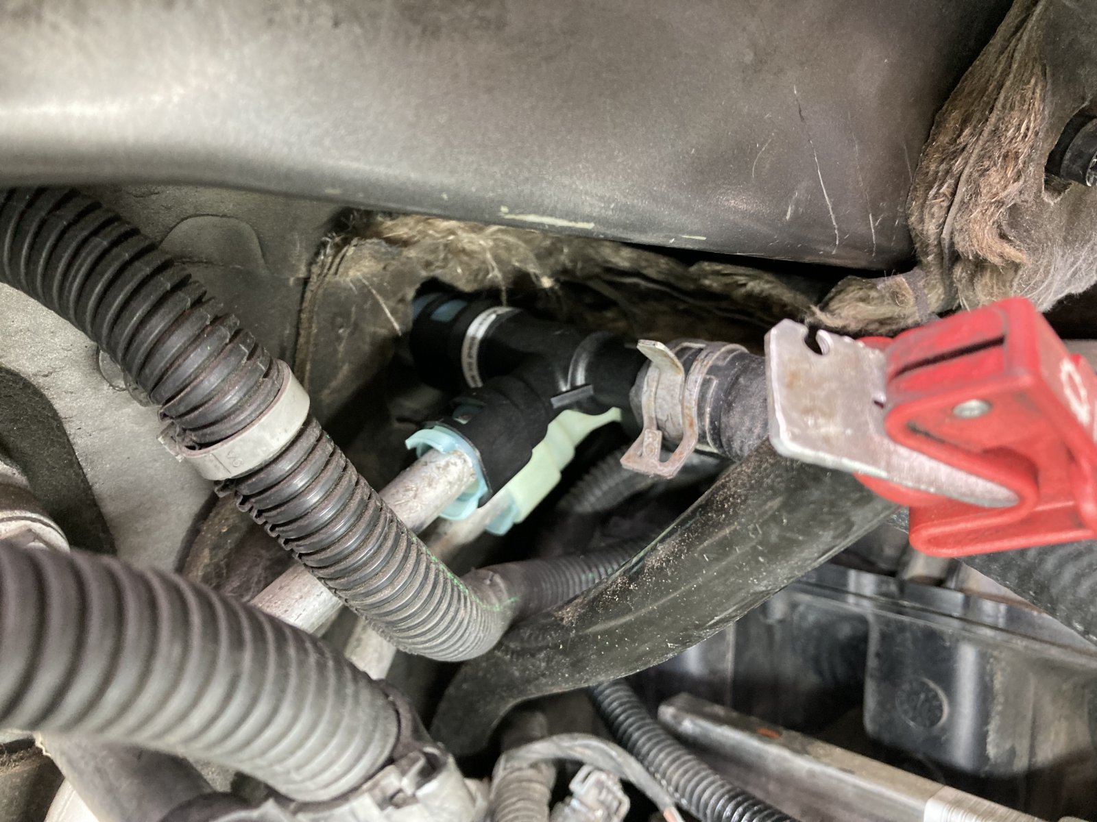

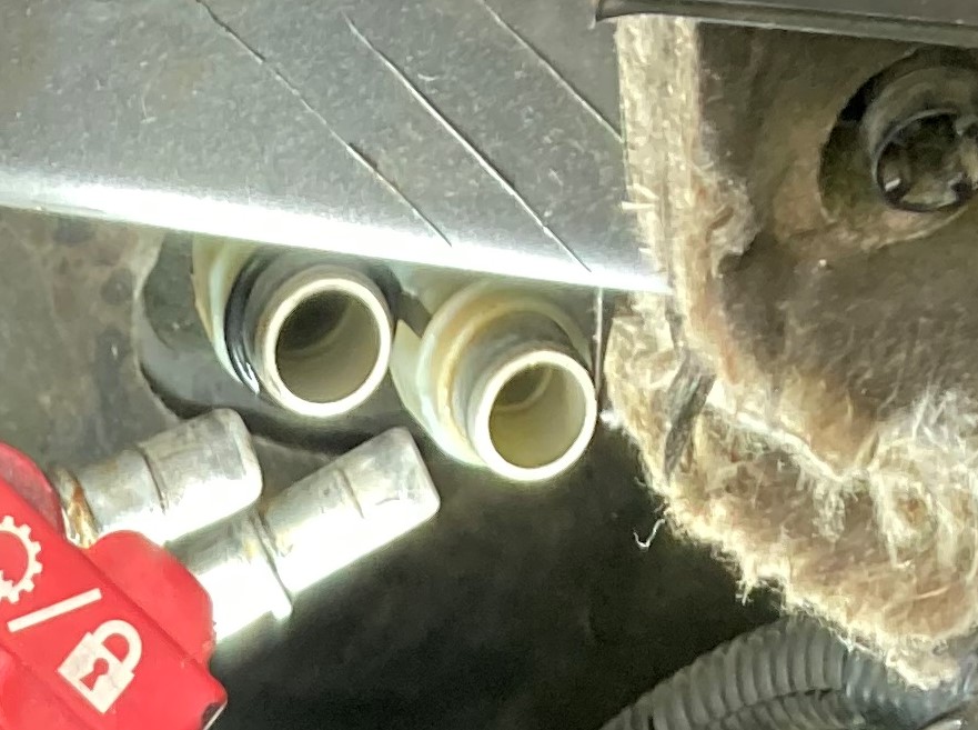

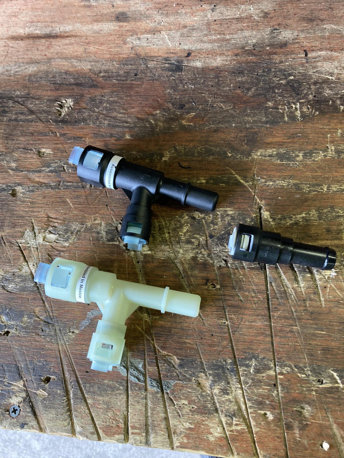

Ok toady's mission in this 90* humid ass swamp ass shit show is doing preventative maintenance and replacing the heater core tee's. Damn good thing I am, the outer straight connector nipple completely crumbled to dust in my hands. DAMN lucky on that one that it didn't happen on the road!!! Got brand new AC Delco replacements going in.

Is it supposed to be black on the outside and white on the inside?
I was going to make a silly remark about always being pink on the inside but decided not to. Sort of.
You’ll notice that there is a slight difference in diameter of one of the pipes so they’ll only fit either the inlet or the outlet of the heater core. On mine, it’s black on the outside and white on the inside.

On my '04 the white tee is closer to the engine, and the black tee on the passenger side.
Is that black o-ring (or what is that) supposed to be on the passenger side heater core fitting?
I don't think all the pieces are off of them in that pic. Looks like parts of the inner clips still on the core pipes
Do you need pictures?
I should have some from when i did those tees.
When reinstalling I found my self scratching my head a little.
And i think it was the black the that seemed a bit loose fitting.
Made me question if i had it right.
