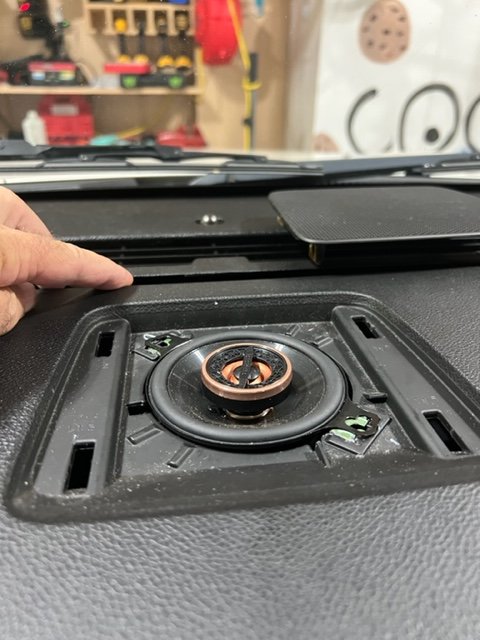

I fixed my sagging dash which also clanked when the speaker hit something internal. Not elegant but it works! And no squeaks! I used one of those foam speaker baffles and added some foam on the bottom with tesa tape. With speaker supported on the foam, the screws pull the dassh up into position. That is an aftermarket Kicker speaker.
